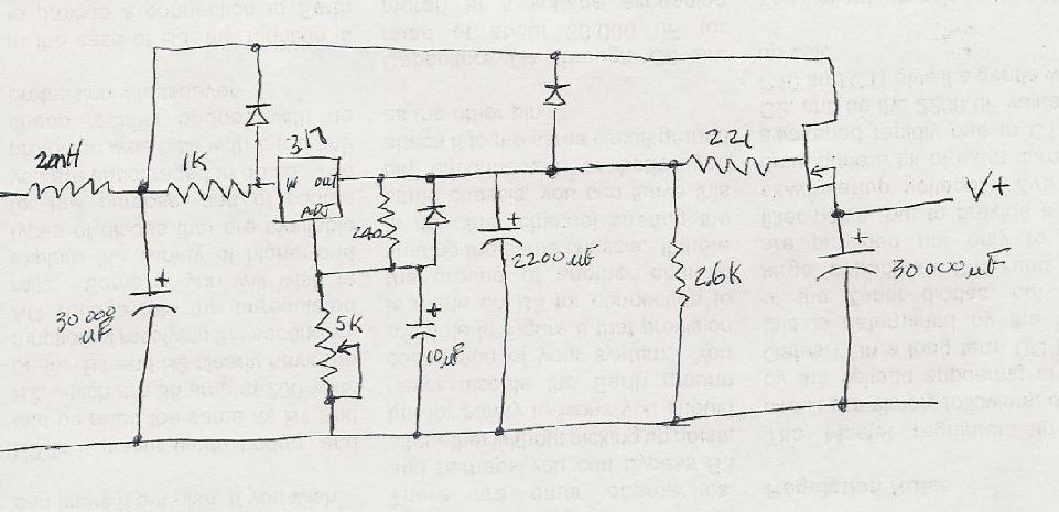

zen5 (for F5) power supply with V reg - need help
Hi all,
The AC voltage at my house varies quite a bit (114V RMS ot 126V RMS). And the rail
voltage and DC offset on my (diy) F5 varies with it. So I thought I would try modifying
my Zen5 based power supply to use feedback and see if that gave me more stable
rail voltage.
My plan was to use LM317/LM337 IC adjustable voltage regulators in place of the zener
diodes to control the mosfets used for regulation. I've included a diagram of the circuit
for the positive side.
My problem is that at best, my regulated output voltage is about 10V less than my
unregulated voltage. I'm sure I've done something wrong, but I can't see it. Would
anyone care to offer any help or insight?
Again, this circuit is (was) the Zen 5 power supply. I have not shown the parts before
the inductor coils, as it is the same as the Zen 5. In my case, I get about 28V. The
max voltage I get after the LM317 is 18V.
There is a lot that I don't understand about this (and the stock) supply. I think the
1K resistor is a current limiting resitor for the (removed) zender diodes. As this part
of the circuit doesn't use much current, it seemed reasonable to keep them. Nelson
mentions that the diodes are to quickly drain the 2200uF caps, but I don't understand
how they do that. I guess they also somehow act as flyback diodes for the coils too
(and I don't understand that either), so I decided to keep them. I think the diode on
the input side of the regulator is for flyback purposes, and the diode on the output side
of the regulator is to drain the 2200uF caps.
The LM317 requires a current load of at least 3.5mA, The 2.6K resistor was supposed
to supply that (when at 26V).
Could someone please give me a hand with this?
thanks,
Robert

I think that the content in post #2970 is incorrect regarding the voltage divider because there are other resistors than 1K and 2.6K . . . 🙁
Anyhow, the 1K is considered too big because there will be voltage drop across 1K when current flows through it.
Simplified sketch is drawn to help my poor head with a simple picture, and attached here. . . :ashamed:
