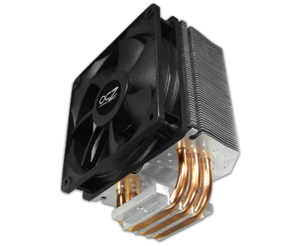

What about putting CPU coolers (fan-less or with regulated fans) - one per each transistor. Like the one attached. Such coolers with whisper quiet fans (or without) have thermal resistance around 0.15 C/W. That is effectively 100W at 40 DEG C max with room temp. 25 DEG C.
These beasts are much more effective then conventional "audiophile" heat sinks and much cheaper. Available in ANY local computer shop.

Re: CPU cooler
What happens of a fan fails? You know that grinding sound when the bearings in those cheapo fans get loaded with dust. The amplifier goes up in smoke?
What we need is a lesson in making copper heat pipe heat sinks with Freon inside. The ones that look like a Miami Beach high rise condo building.
Re: Re: CPU cooler
I agree that fans are not reliable. I believe there are designs floating around for a temperature controlled cut-off switch. Would these be a prudent back up plan?

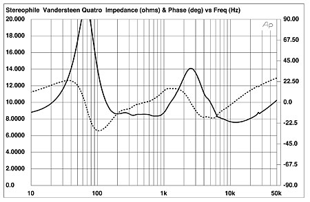

BTW, has anyone tried one of these on a Vandersteen Quatro ? It has a very stable and high input impedance and since the amp only has to drive from ~ 100 hz up, (the woofer is active), I figured that 100 watts would be about right.
