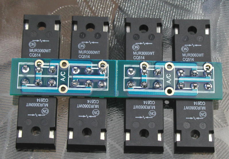

I don't think MUR860 are strong enough for such amp.
I'm using MUR3060s

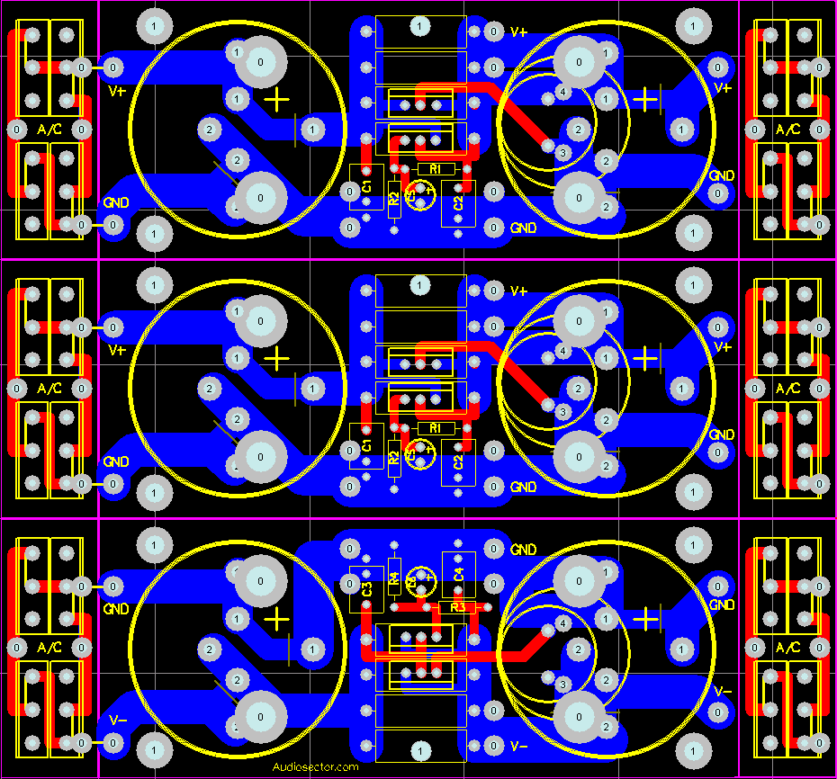

I finally figured out the way to deal with 2 types of PS boards and make the rectifiers boards available for free, including shipping (subject only to forum donation)
Here's the All In One Power Supply board and I will try to stock them permanently.
The tiny rectifier boards on the right brake off and can be used as spares by anybody who does not want the complete PS board. That would include me, as I always prefer to wire caps p2p 😉
If someone needs PS for F4 or F5 amps, I will break off the top section, which creates symmetrical PS (+/-V).
For those who want PS for F1, F2 or F3 amps, I will break off the bottom section which makes it a dual positive supply (2x +V).
The whole board is approx 5.5 x 5.2", which is still very reasonable size.
Of course it is also suitable for use with all 3pin regulators, in line stages.

Good news Peter, and looks great but doesn't this design limit you to large can type caps unless you want to wire caps off board? I may be a relative layman compared to you but most of the F series and FW amps PS’s have the ability to use multiple caps to achieve a higher capacitance rating on board. Other than the obvious of working off board and just running jumpers from the caps to the relative places on the PS board what is the benefit to using a board of your style? Just curious Peter is all? I’m just worried that I’m going to have a hard time finding Caps with high enough rating cheap enough for me to use as F5 supply caps. Unless you have some laying around your willing to sell…. Anyhow I look forward to the final deign and the prospect of getting my F5’s up and running, Peace and take care.
