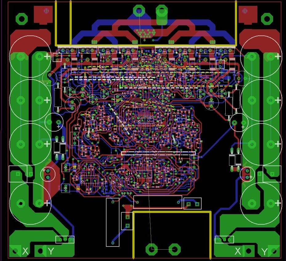

Working on just these things... so that's the ??? Nothing wrong with the main caps on the OPS PCB , just run a separate return to star.... eliminates the inductance of the wire but complicates board/ chassis layout.

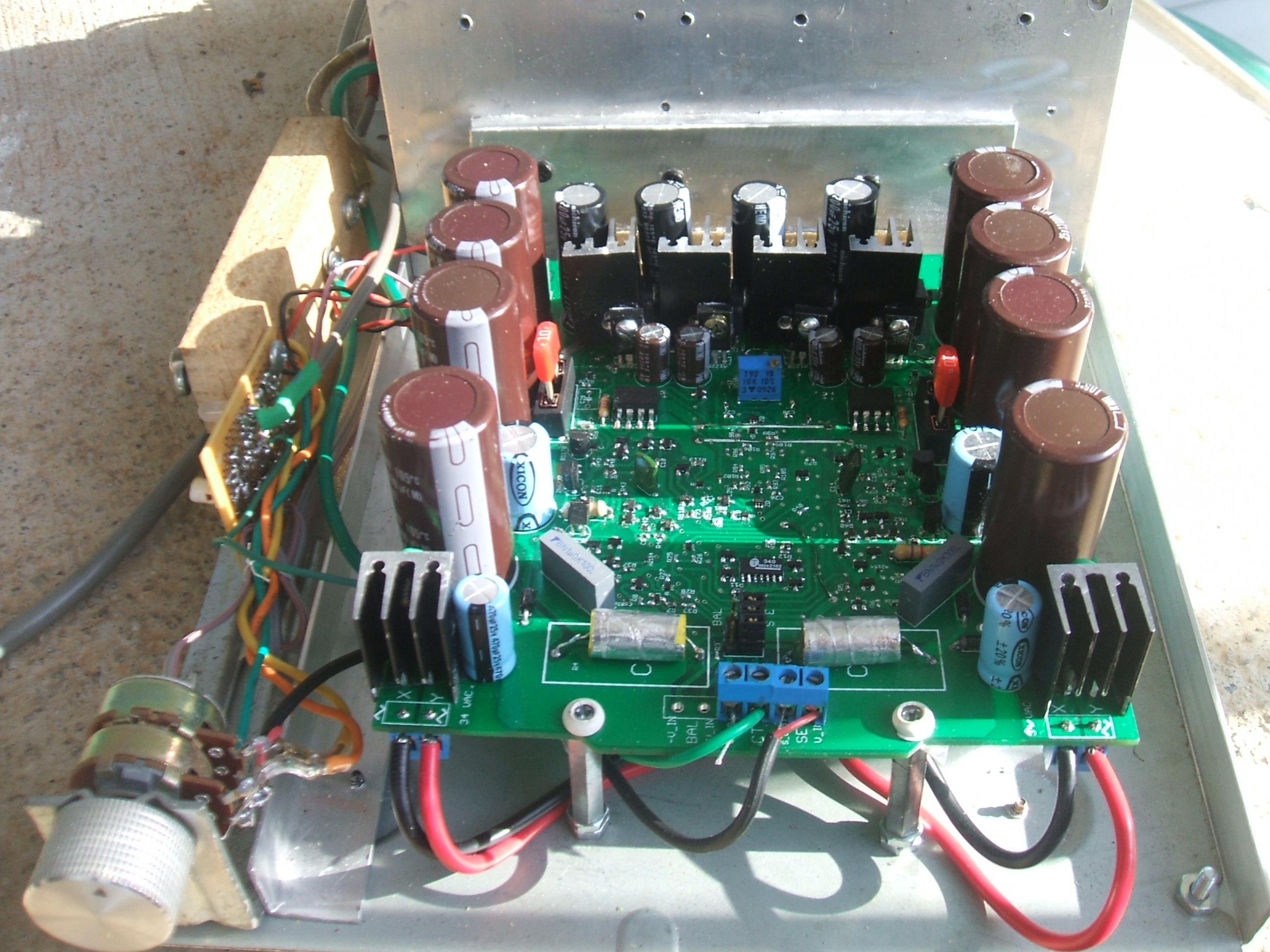

I agree with this. PS caps should be somewhat near the load for them, that being the output stage. I have discovered that it is worth the extra effort to design the PS and the amp on the same PCB, such as in this one. You have to be aware of the high current return paths so they will not cause interference. Although since this amp OPS is a full bridge, there is no speaker return to GND.🙂
...and the next updated version (in process) still a bunch of work yet, hope to finish it soon.😎
