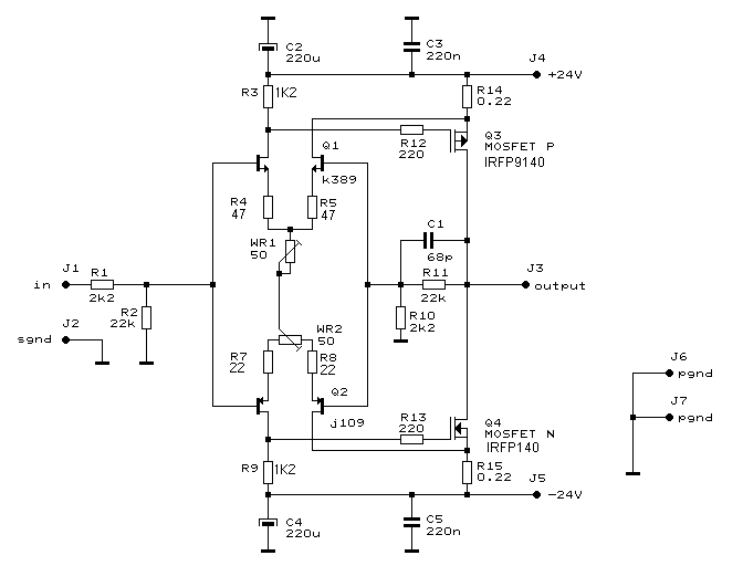

... 3Watt 0.22R 1% metal film resisters is enough or ...

not current feedback , but voltage one ...... with heavy current flowing through it

Thank you Juma!
Also thank you Zen Mod, probably still better than simple voltage feedback.🙂
One of my friend want to try these amp , I think these originally from you Zen Mod . To me it look like your design (I can be wrong).
Can you do some comment on these please.

Actually, every feedback is the voltage feedback (current flow is always a consequence of voltage). We just call some of them "current feedback" because they carry more current than usualy due to low Z of return point (and amp from post #1 qualifies too).
that's Vangelis's construction - a guy enormously skilled in both schematic ( projects ) and pcb construction ;
Kudos where it belongs .
that amp was tried by me , and I couldn't decide which one was better - Babelfish J or this one .
Well, to me it looks more like it´s a variant of a John Curl design.
Kudos where it belongs...
question was - drawing - mine or someone else's ;
of course that origin is much older than that drawing .
nobody here wants to steal someone else's IP , so - just gimme a break with that , or we'll end up in tube era , searching for older and older origins
