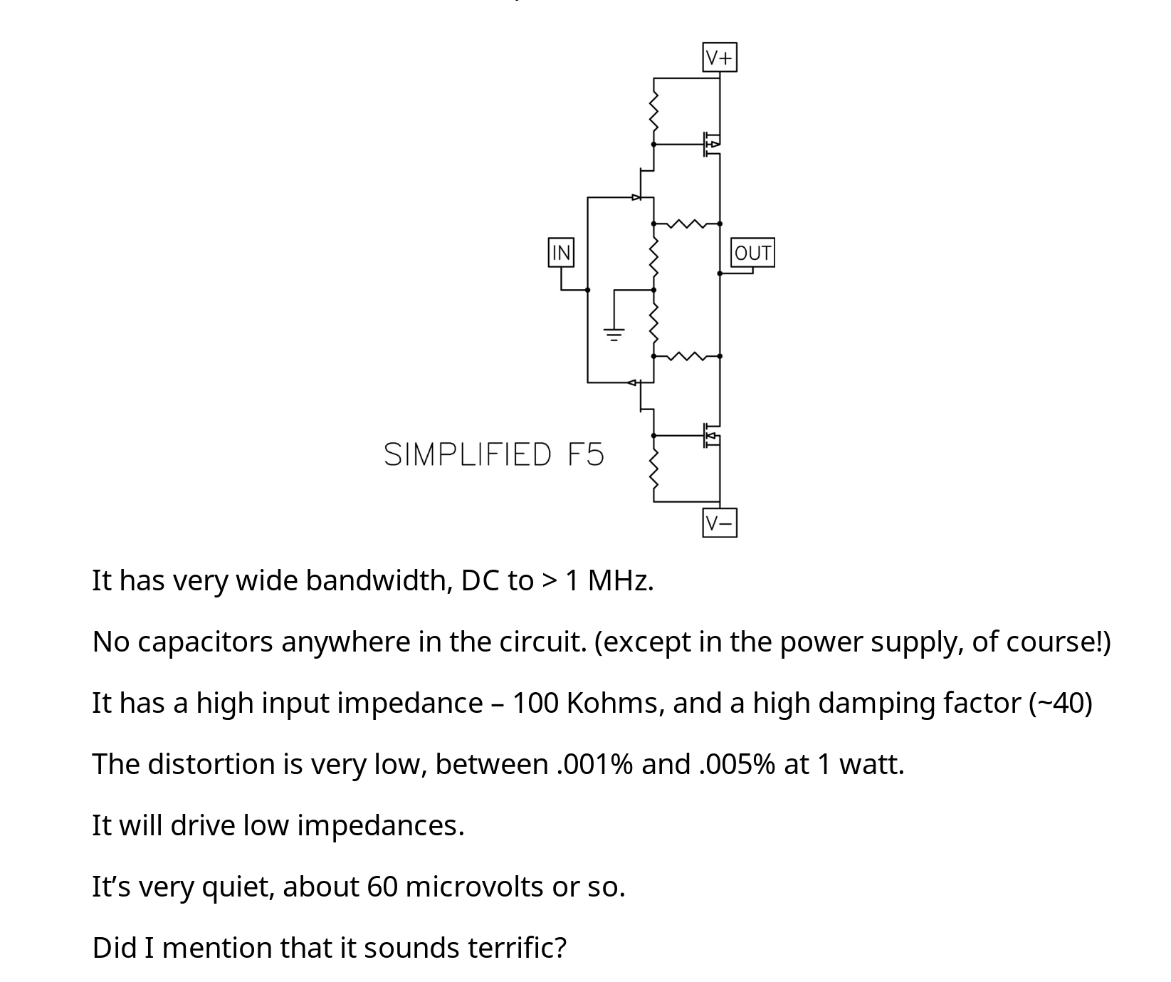

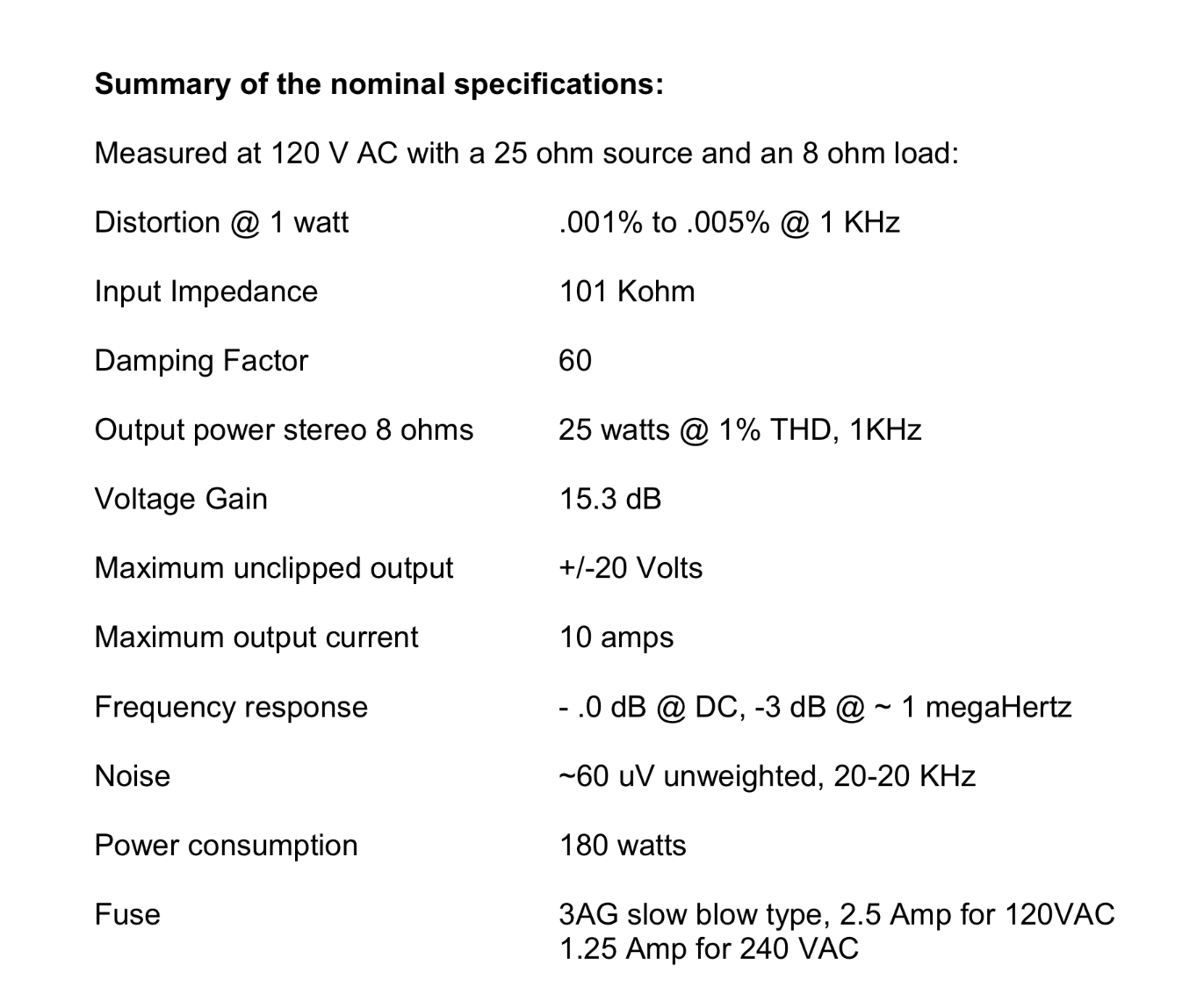

....A friend of mine who builds tube gear was surprised by the "high" distortion he measured from the f5.
How much distortion numbers is at 1Watt@1kHz from Your friend tube amp ?
Damping factor 40 ~ 60 is plenty and 0.001~0.005% distortion is low as well.
Source : FIRST WATT F5
Of course, everything is fine and the figures for 30 watts and the whole behaviour of the f5 looking more like a good tube amp than like solid state...and the sound speaks for itself.
Distortion in F5 is dependent on interaction of characteristic of the fets in use, selection and matching of parts considerably affect resulting distortion. Since your F5 is a diy unit, there is no clue of the characteristic of the parts in use.... A friend of mine who builds tube gear was surprised by the "high" distortion he measured from the f5. The nice bass response in combination with the open top end makes me think that the feedback/damping is changing with frequency?
However, in the F5 Turbo article, there is a P3 potentiometer that may help adjust distortion amount and characteristic closer to user requirement/taste. Jim (member 6L6) explain this nicely on a video discussed in his Adjusting P3 - a video thread.
