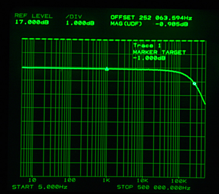

To add to the discussion on bandwidth:
Today I just completed F5 and here is the measurement I did on frequency response. The measurement was done on my HP 3577 network analyzer and is pretty same as Nelson's published specs DC to -0.25Hz at 200 KHz. I would just say this is awesome - flat to DC and -1 db at 252KHz in my measurement! What a amp. Only one thing I wish for - little bit more power.

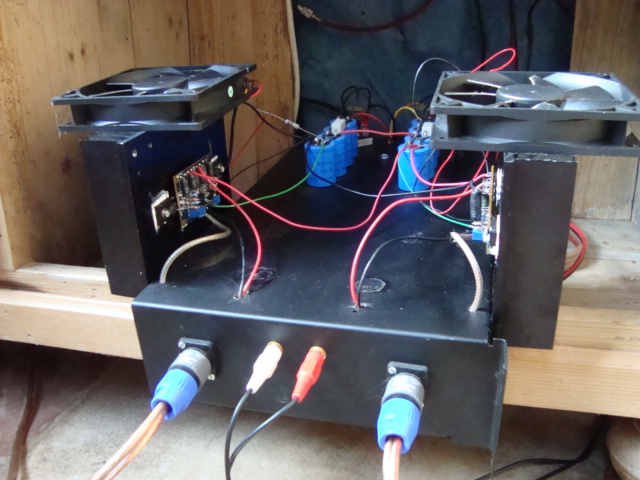

There’s nothing special about the build, in fact its ugly as hell. Peter Daniel boards, K170/J74 and IRF Mosfets. This amp is by far the best I had in my system for years. Beats my AlephX hands down. There’s rolling and shaking bass, there’s high’s to die for and there’s silk sweet mids to make one drool. My 800's are –unlike other B&W’s- not demanding or power hungry. Like AR2, the only thing I could whish for is a bit more power.
F5-sounds better than my phase linear 700b and luxman M02 and 2 x 52 w tube amplifier.Thank you for this design mr pass.
Deleted thermal compensation and protection circuit portions. Also left out R9 and soldered the jFets directly to the female RCA, although do this with caution as leaving out R9 may cause oscillations depending on your source.
