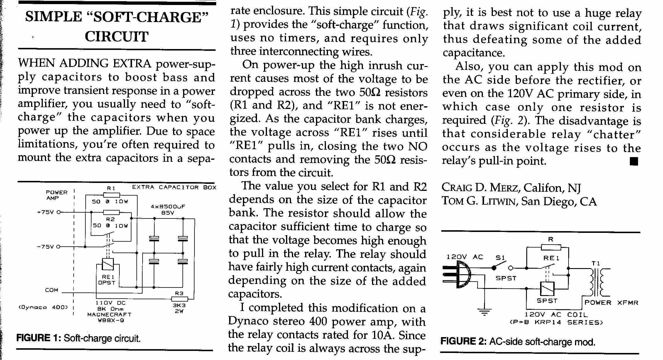

Will the CL-60 thermistors still be enough or do I need to look at soft start? Planning on running a 35amp bridge.

For soft start, next time I want to try something with an AC relay like 'Fig. 2' in the attached article.
Zen: That's good to know. I'd rather user the Cl-60 than a softstart board.

best thing after wheel is - soft start circuit but filled with series NTCs , instead of fixed resistors
that will give you really soft start
whatever - that's better in just one instance - behavior in case of mains blackout - when you'll need maybe every 10-th time to change fuse

I have 6 x 47,000uF caps in my F5 and I only use a CL-60, no soft start. Its been working like that for about a year and a half. Gets switched on almost daily, no problems.
You're ok.

Thanks for the info guys. Looks like 22Kuf x8 wont be an issue w/just the CL-60 and no soft start board.
