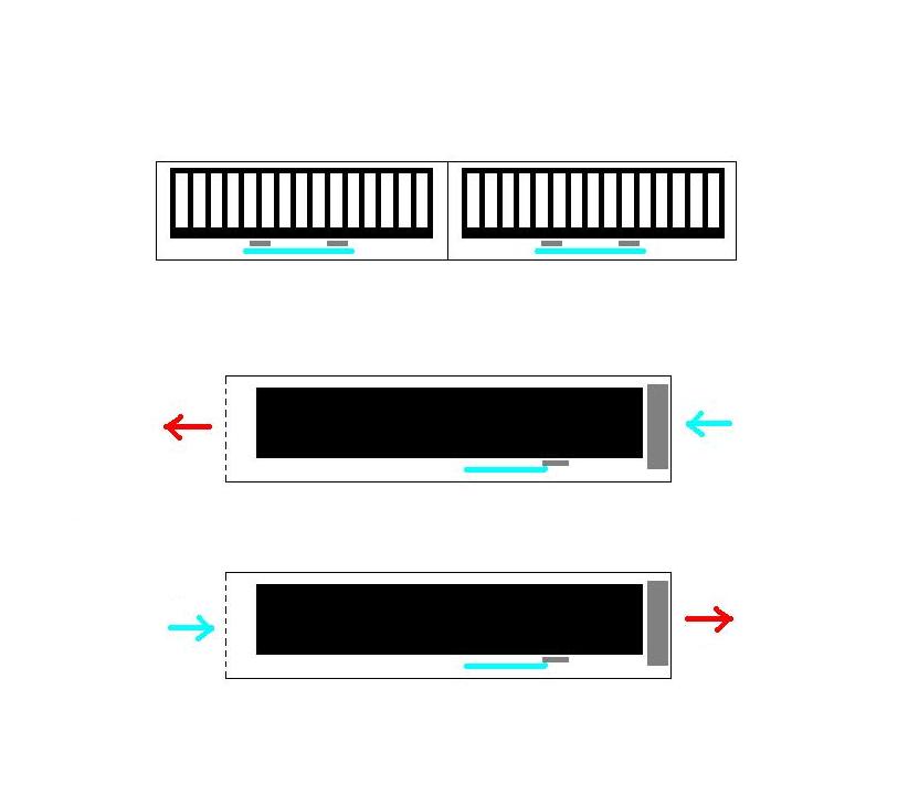

The tunnel arrangement of heat sinks can remove a LOT of heat- even with modest airflow. There are sources on ebay that remove them from larger motor drives and have a handful frequently listed.
For a racked amp, i would use a tunnel.
yeah, ok
if you have to use fans anyway, fan tunnels are the way to do it
but I think they are out of fashion
different types used today
well i got the tunnell part, but is it like, a fan blowing through heatsinks internally? or what?
or could look like this
but may be difficult to handle
it can work both ways
either by pushing/blowing cool air into the system
or by sucking out the hot air
in modern pro amps you may find both ends of the cooling system connected directly to the room, basicly free of the box
much like a tunnel through a mountain

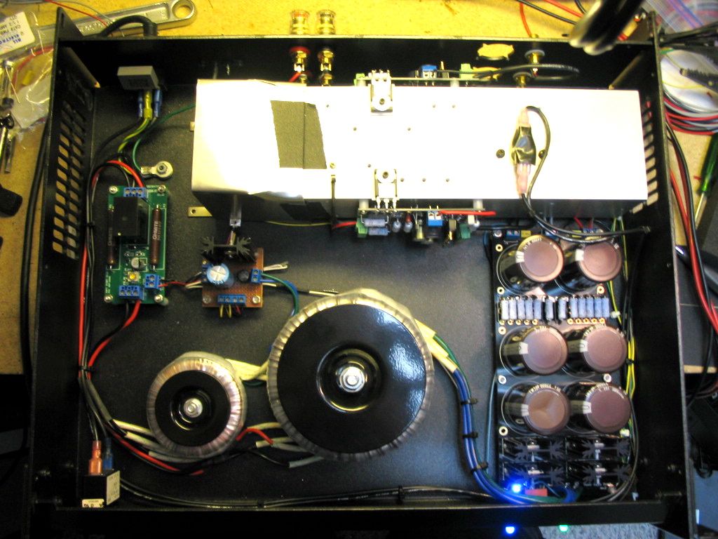

I went with 4 10" sections of this from Heatsink USA for my dual stereo F5s:
HeatsinkUSA
It wasn't cheap but their prices seemed to be the best for us stateside guys, shipping was prompt and they showed up well packed and look great...
For reference, they're roughly 10#s a piece.
HeatsinkUSA
