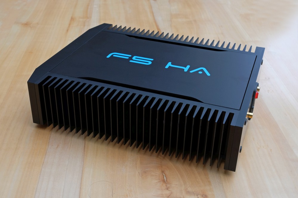

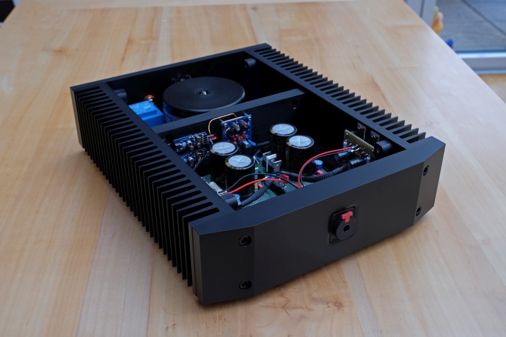

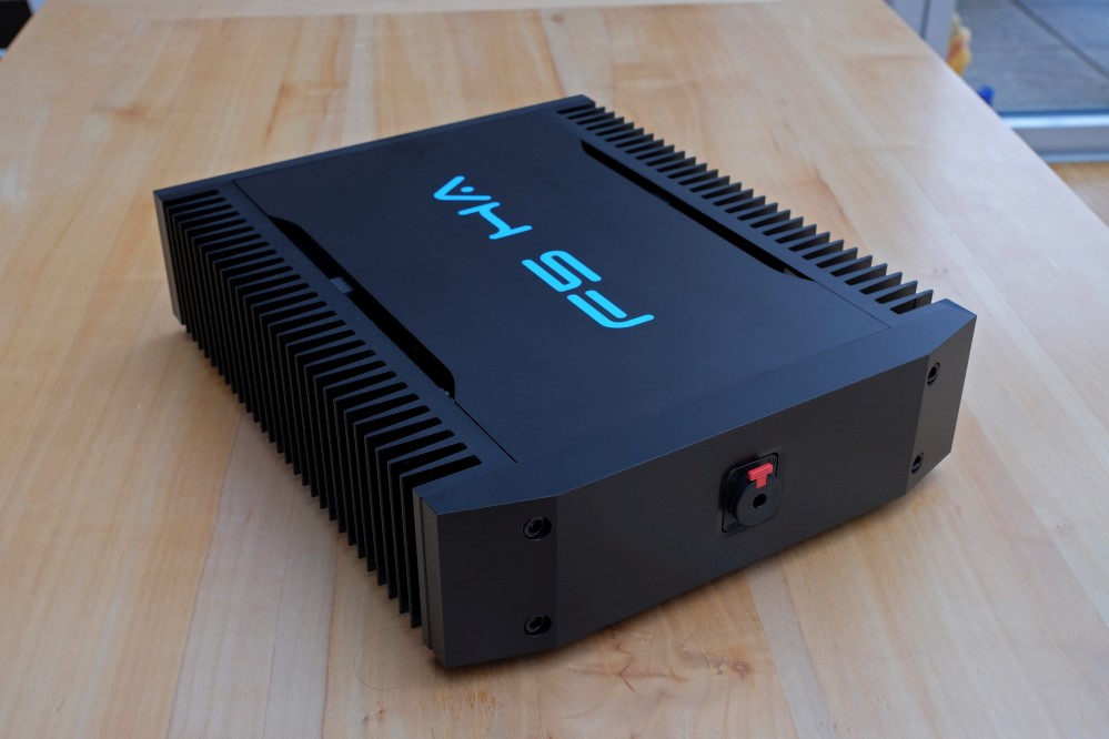

Taking this chance to post a few images of my finished F5HA (finished months ago, only added the decals...). Sounding superb!
Err, that one took longer than 3 days to build. 😀

Gorgeous case.
And big enough case and power supply to upgrade to a balanced F5X-HA later.
Patrick
Patrick
