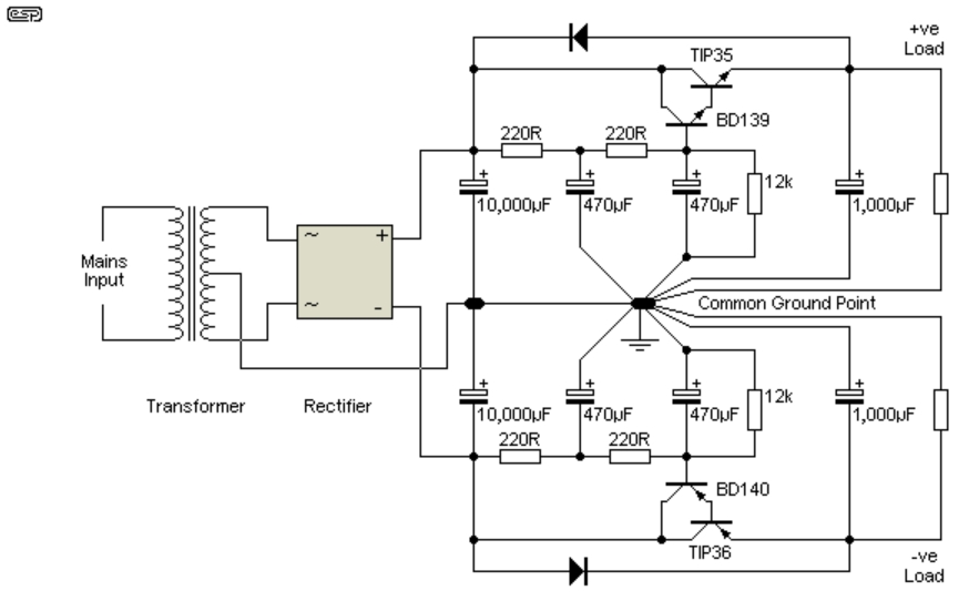

I'm doing a layout for the Elliott circuit below.
At least it's a simple design.
Do you know by chance if 1N4007 diodes will work for the ones in parallel with the TIP's collector and emitter?

1N4007 is 1000v rated so is the "best" of the 1n400x series so should be fine. I am wondering if I can use TIP41/42?

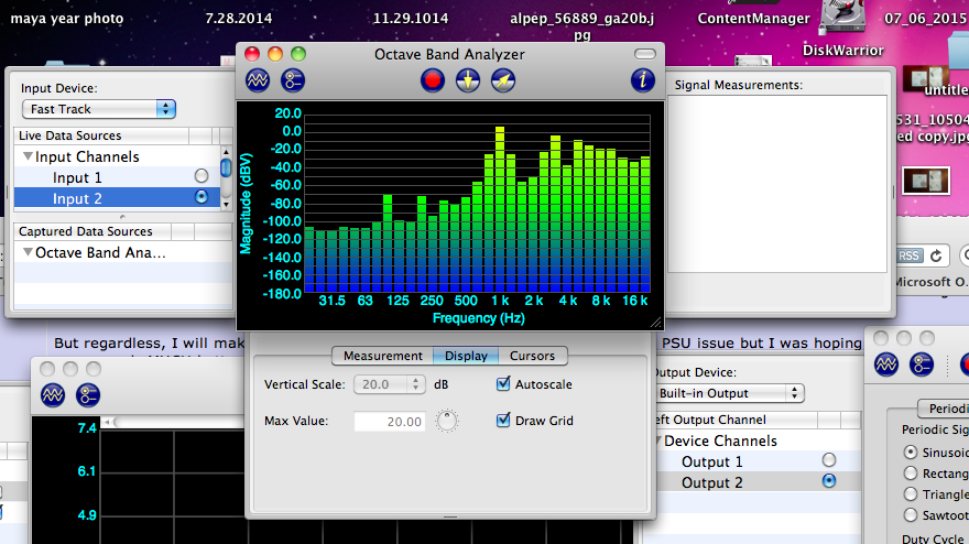

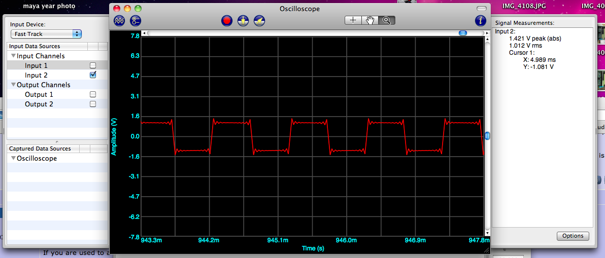

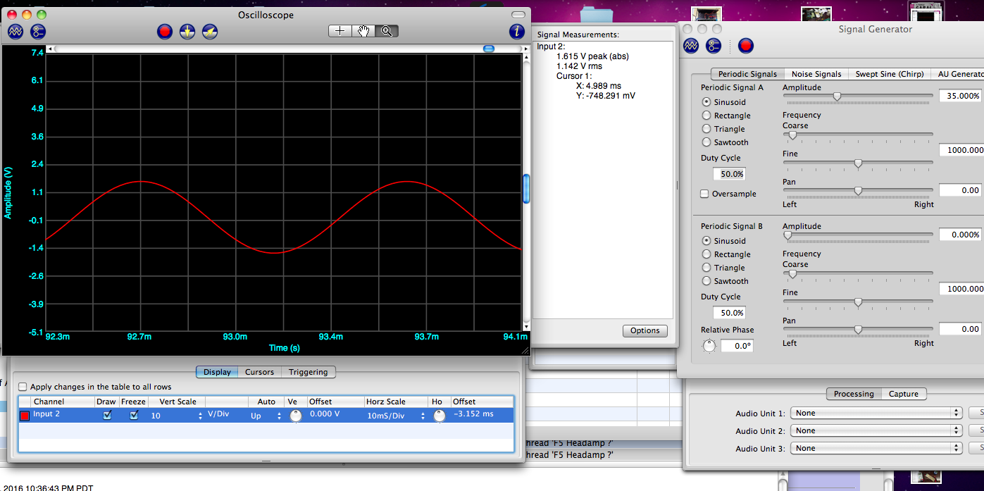

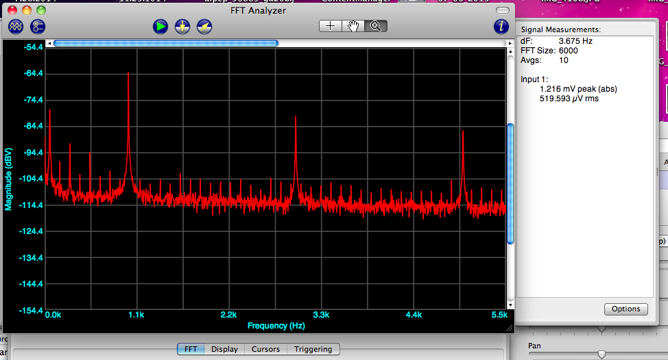

OK guys, I put my amp through some software-based testing.
A) I barely know what I am doing here...take it easy on me. I have no formal training and all I know is self-taught and learned here. So be nice.
B) The amp was hooked up to an USB audio interface and ran into my macbook. I have no idea of the load placed on the amp or the noise produced by the USB interface.
I have tested a sine and square wave, harmonics and octave. Sine looks good, Sqaure looks bad (don't know if I am doing something wrong), harmonics look good. I will attempt a FR response measurement if I can figure out how to do it.
I am I wrong in saying the amp looks fine?

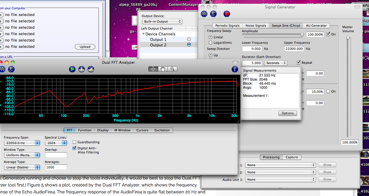

I beat on the computer and got a frequency response. This explains a lot I think.
What do you guys think?
Thanks x.
I thought I read somewhere on this forum about the TIP41/42 causing possible oscillation problems in a PS design.
I've read so many posts that I may be confusing it with something else.
Why don't you post the question over in the "Power Supplies" section?
Or...just add a TIP35 and 36 to your next Mouser or Digikey order.

Something is not quite right with your build:
- From the square wave, it seems there are signs of oscillation (you may want to check the output from your signal generator though)
- For the FFT, you may want to use higher magnitude (e.g. -10dBV) for the fundamental, to show more reasonable THD figures. As it showed, the third harmonic is only 20dB below the fundamental.
- The frequency response looks terrible. Compare that with figure 8 of the official build guide.
Your sound card has limited bandwidth and hence you will not be able to generate or measure a proper square wave with it.
The overshoots you see can either be from the amp itself, or from the sound card.
Same problem with the frequency response (not enough bandwidth).
You need a proper oscilloscope.
And the old analog ones normally come with a built-in 1kHz square wave generator.
Many new USB scopes also come with a Func Gen.

It's not easy to make a DIY rig to measure amps. Need high quality low noise and low distortion external sound card. Need voltage divider. Need resistive load with heatsink. Can be done with REW software with built in function gen and RTA function. Need to calibrate out the sound card response.
What you should check first with the F5-HA is high frequency oscillations.
This can be way over 1MHz, and you will still get sound.
So having sound is no guarantee.
The proper way to find out is a frequency sweep to 5MHz if possible.
A fast ocillocope with a 100kHz square wave will be minimum to check any overshoot.
If you have a lab power supply with current limit, you might also be able to pick up large oscillations (when it goes wild).
The power FETs and source resistors will also get hot when input is grounded and output is loaded (e.g. 200R).
The load resistor itself will also get hot.
Without any equipment, it is really difficult to tell.

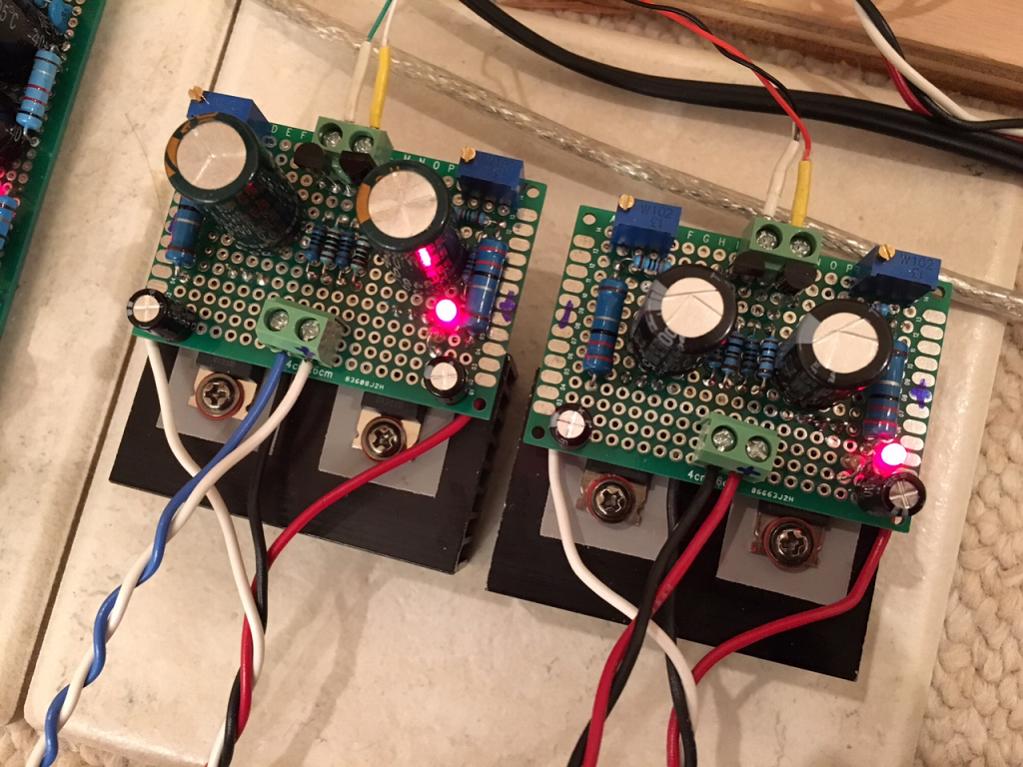

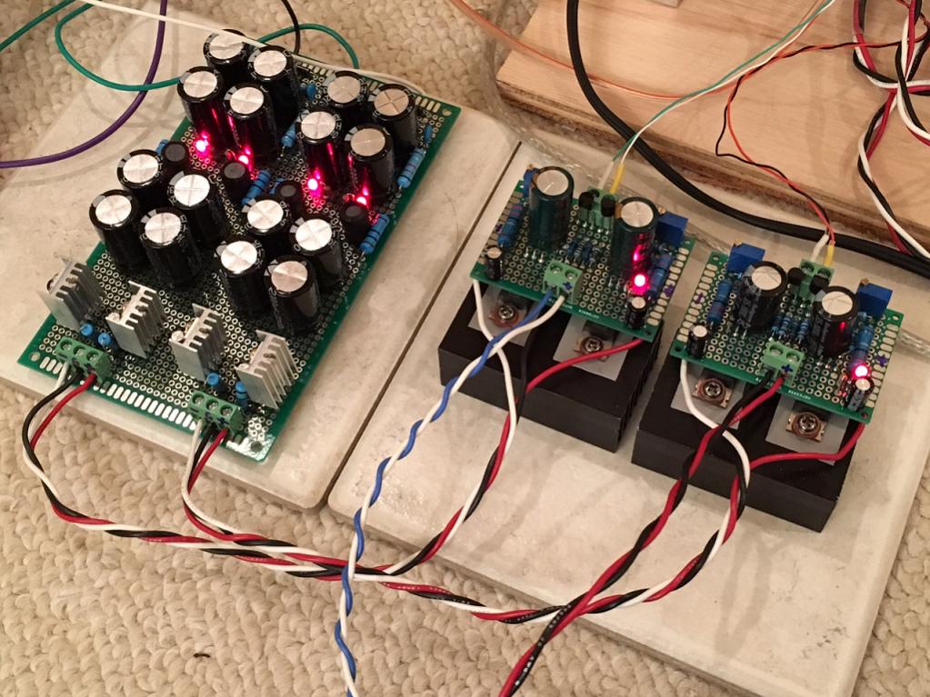

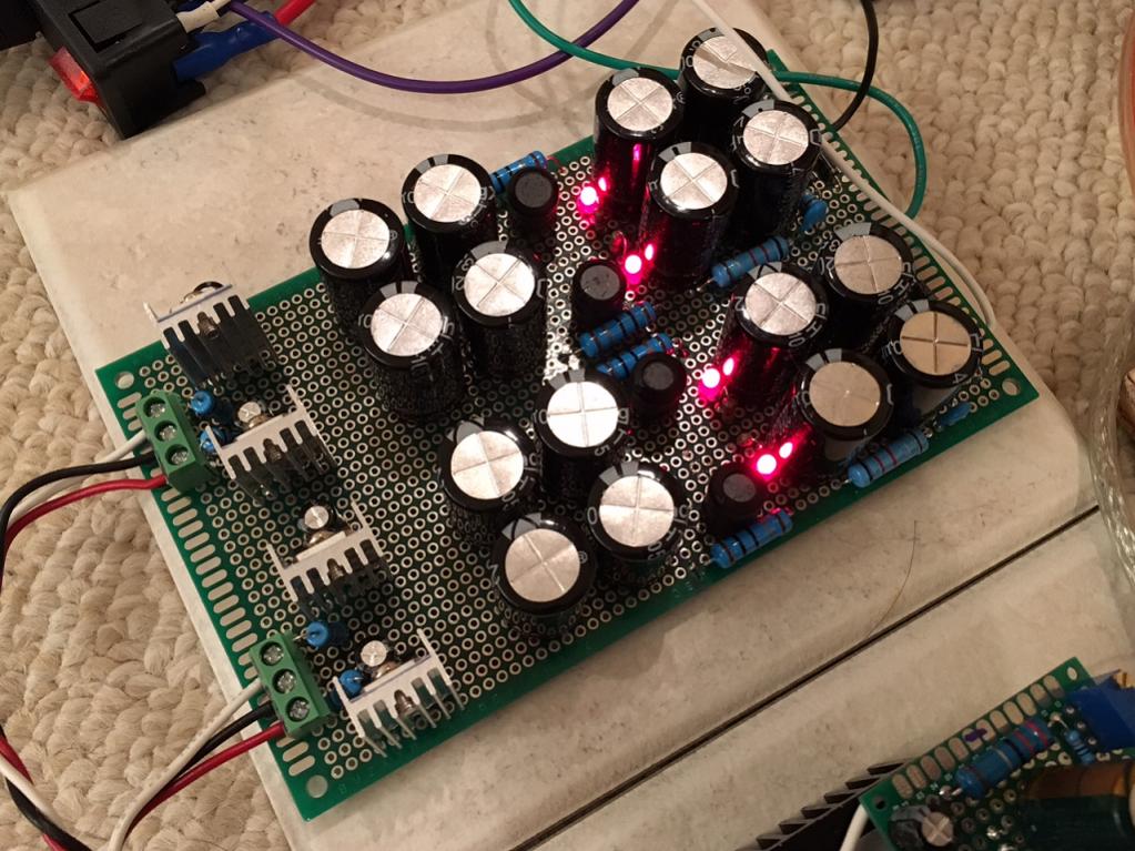

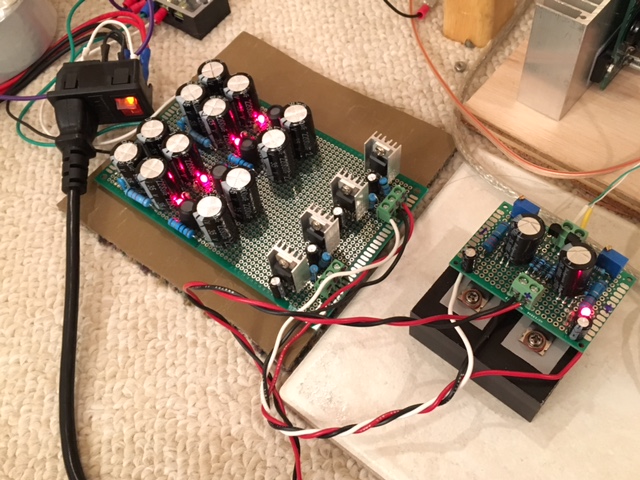

F5 Headamp in Stereo
Finally listening to it in stereo. 100mA bias current seems to be a good match for the smaller heatsinks I have on the 7815/7915 and sounds good. The PSU is a CRCLC with 2200uF x 4 total per rail. PSU ripple at amp input is ~1mV. Absolutely silent when no music playing. These are not my good headphones as the MDRV6's are at work, but give me a good idea of the sound quality. So far so good - very clean, highs are very clear, bass is nice and deep. Will take more time later with better headphones before final assessment but like it so far.
It's too loud - maybe need less gain - an input pot? I have the DAC output turned way down to like 4 out of 100.
System with PSU, not shown in an Antek 100VA 15VAC toroidal transforner:
Closeup of amps:
PSU:

It was used with cross feed which reduce the signal by 10dB.
You can just add an input pot.

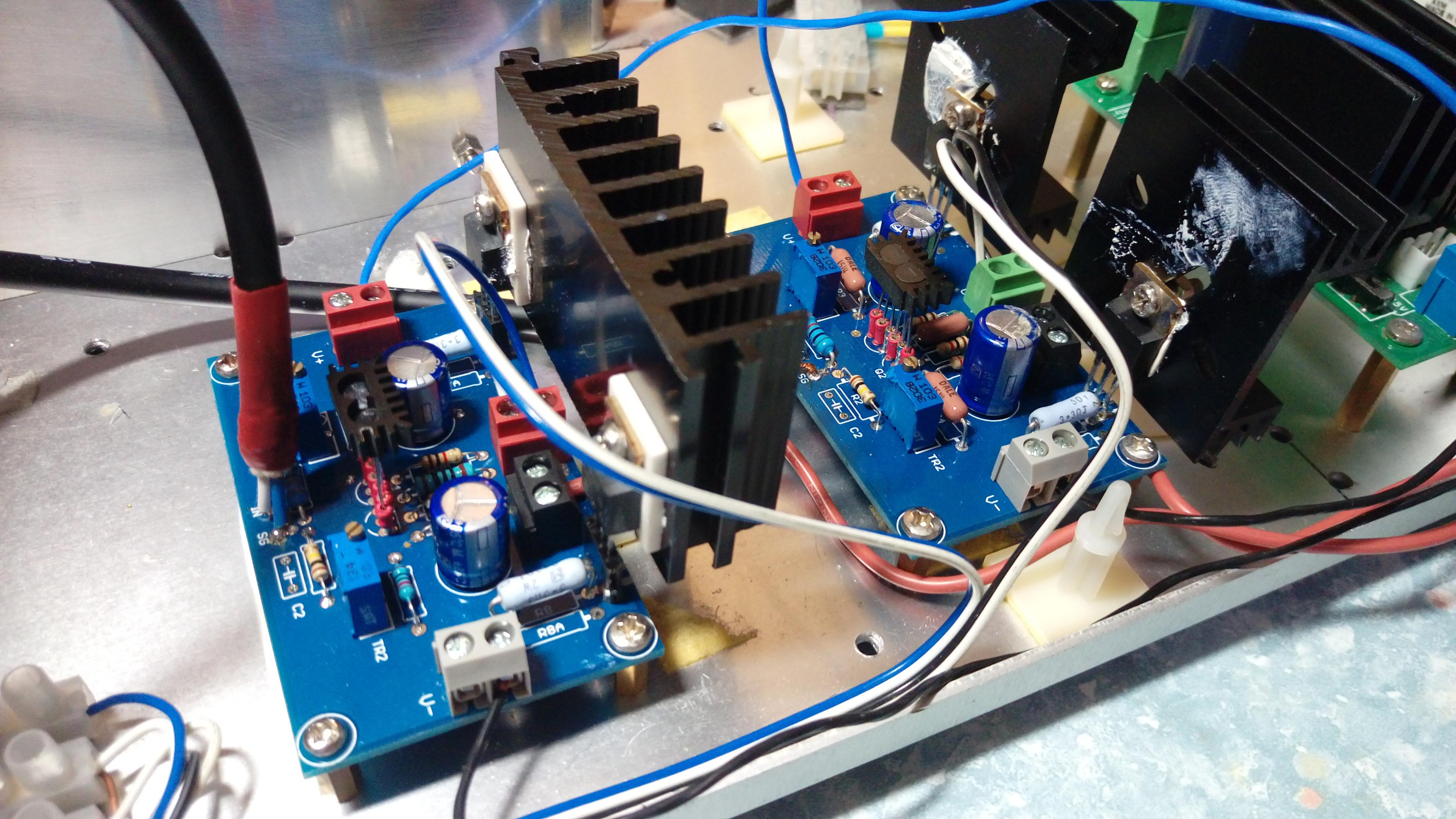

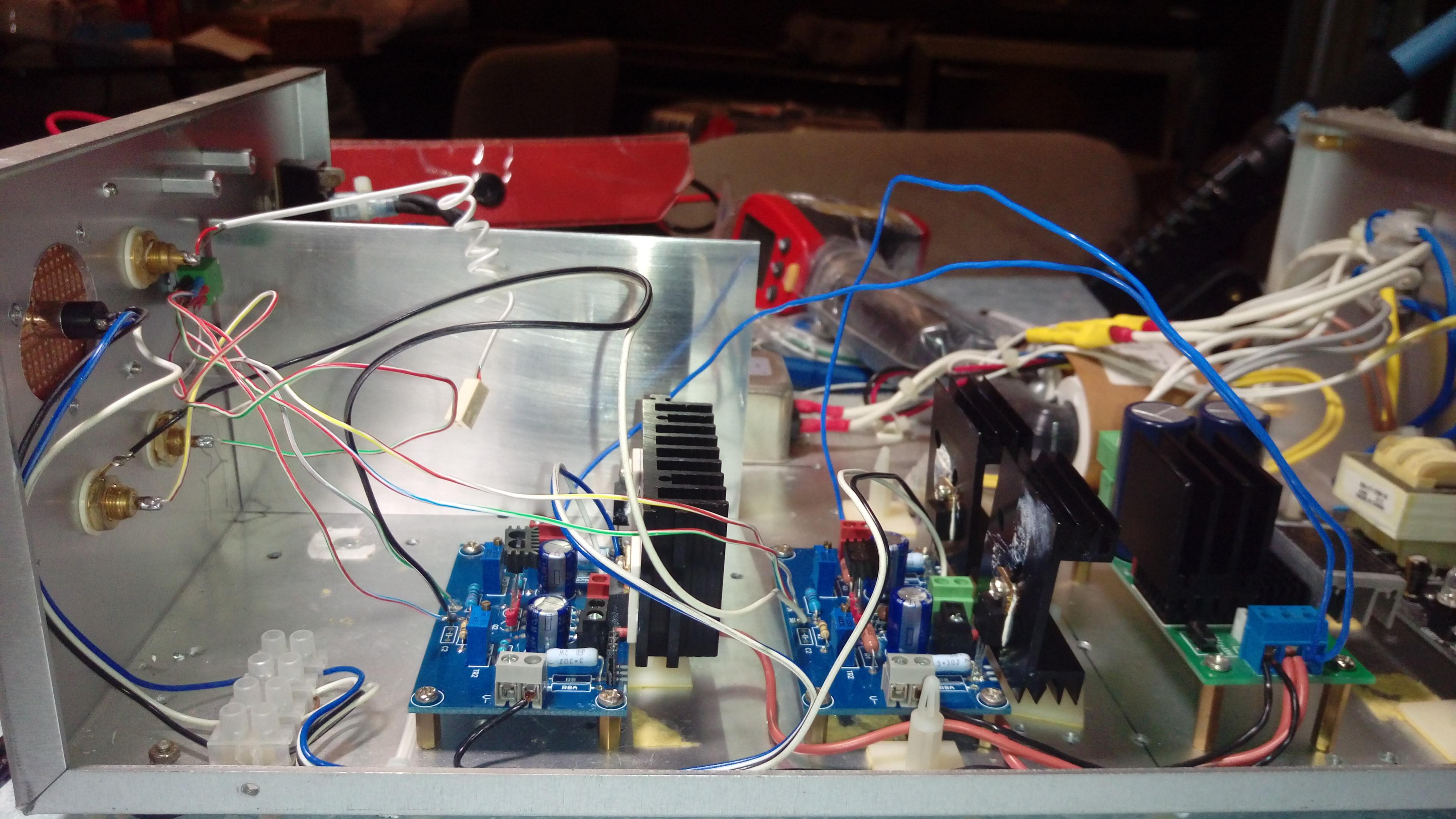

I also kind of finished mine today, it was based on Patrick's original schematic and a friend helped to make the PCB, I added a 10K volume port to lower the gain too, no noticable noise heard so far. Mosfet used are IRF610/9610 (didn't match the mosfet), Jfet were matched to 7.65ma, DC was quite low but forgot what exactly the number was. Power supply is just a 7A4700 from a local vendor bought few years back. I am going to try other regulators when have time , get a better case, tidy up all the wiring and work on the cross feed filter. Sound is good at first shot, plenty of base and very detail. This is my first headphone amp built, thanks for providing such a clean design.
