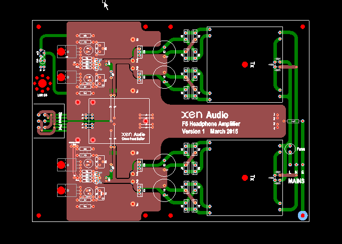

I actually have a fully designed PCB layout on my computer.
This includes everything from transformers, fast recovery diodes, super regulators,.... to cross feed, volume control, etc.
i.e. everything I would want in a head amp.
But then I just finished my DAO. Which is a different story. 😉
Patrick
