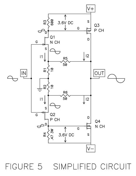

If you run the higher Idss device at a higher current (Id) then you get a higher transconductance.
The problem then becomes device dissipation. Pq = Id * Vds
You can run hotter, or reduce supply voltage, or add a cascode.
what to change in the schematic for a higher Idss part?
You can raise the values of R1 and R2 to lower the current. To keep the
same gain you would also raise the values of R5 and R6
Hi All,
I remember seeing a post by Mr. Pass that the front end JFETs can be replaced by Fairchild J174, J175, P1086 for P channel and Fairchild J111 for N channel. Has anyone tried any of the combinations above, and how's the result?
And if I were to have a go at it (coz I ordered a set of K170 and J74 from china, in case those turned out to be fakes I would have to consider replacements) would I need to make any changes to the circuit to accommodate J174 and J111?

Hi All, any schematics for replacing N channel with J111 and P channel with J175...170's/74's barely available in this part of the world..
not likely
they're too wimpy , in xconductance department
you would need (typically) 3 of them in parallel instead of one Toshiba
even then you need to adjust source resistance to have sum current of 8mA , which would heavily influence gain of stage
wait for Store , supposedly they're soon to have them again
