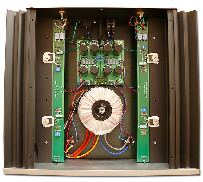

Can you tell me is it possible to get original PCBs, like in the original FW F5? Those long L and R and for the PSU. Thanks.
I bought a set of those long pcb:s from the group buy section a year ago. Don't know if they're still available.
the same as in the photo above? you have some pics of yours?
have you, in any case, bought 2 sets? 😉
wow! great looking amp! nice work! thanks for the photos!
i'm afraid original layout would be hard to find....?
