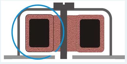

On the critical side, do I see signal wires going right over the transformer?
Yes, and I may try rerouting or putting an enclosure over the transformer if it's a problem. A lot of posts suggested having the shortest run possible for signal wires so I went for that first. I've got twisted pair left over if I need to try routing around the edges of the chassis.

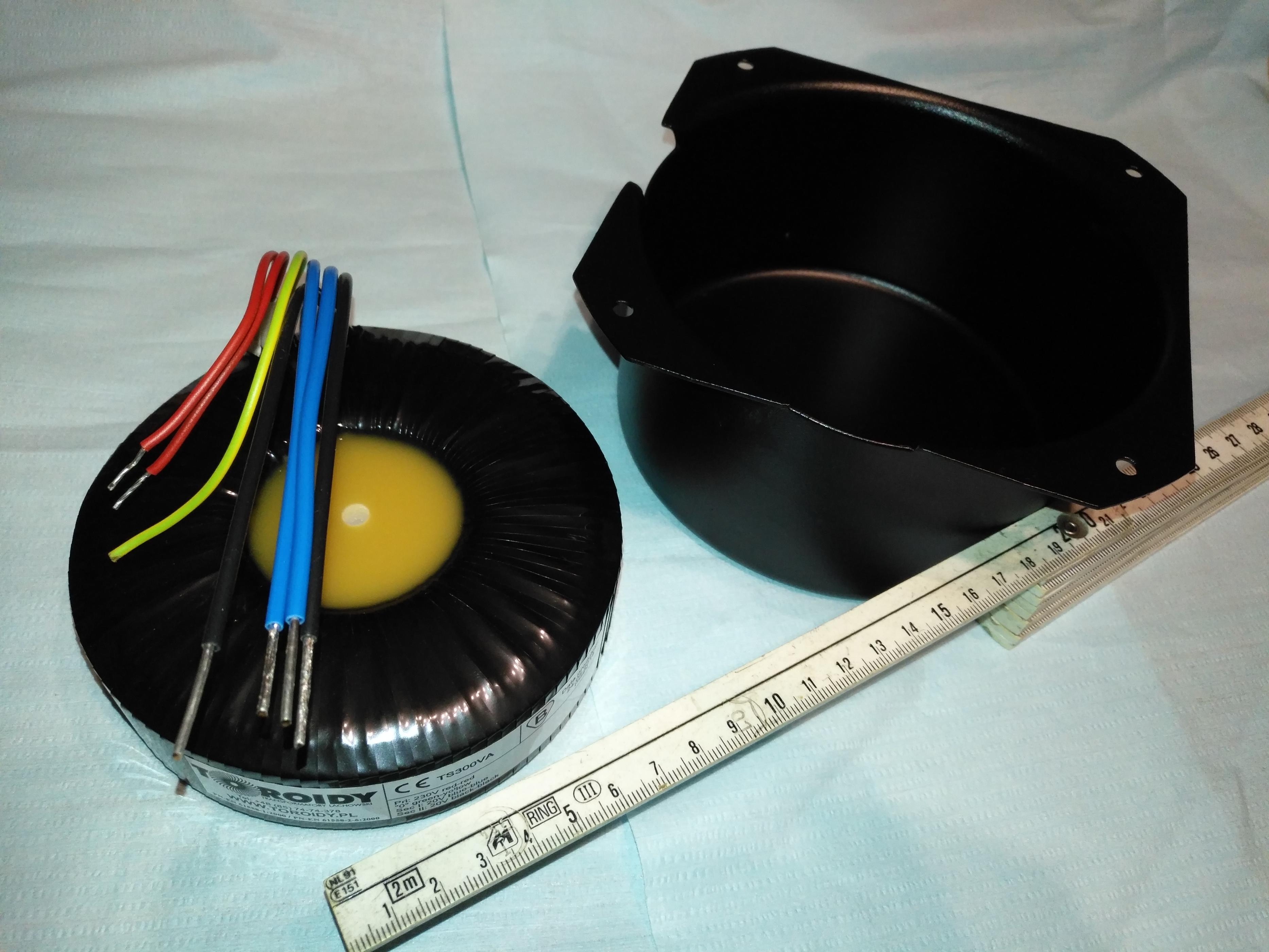

Your creation has a really clean layout, for this I would not change the position of the cables, you can shield the transformer with an enclosure like the one in the pic, I purchased it on Aliexpress, there are in many sizes.
In any case, the enclosure material must be ferrous like mild steel, not stainless steel, aluminum, copper or lead, as these are not non-magnetic and only stop the electric field, not the magnetic field.
If you make this choice, remember very well what Zen Mod wrote in "Pictures of your Pass amplifier" # 5168, this is very important.

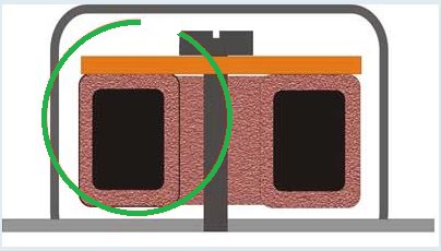

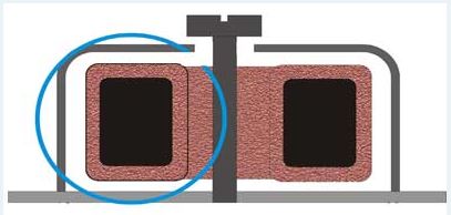

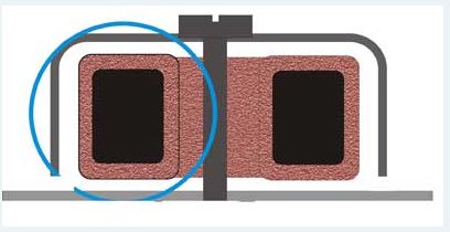

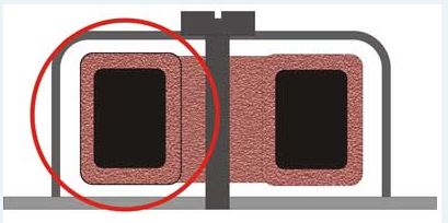

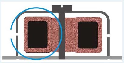

@ booja30 - the metal belt around your transformer was certainly a screen, try to bring a magnet close to it and you will immediately see if it is ferrous or not.
Of course, if it doesn't create problems in my point of view it's nice to see the naked toroidal, I think it gives a feeling of "power". Otherwise, I have seen really beautiful cans in anodized aluminum or polished stainless steel in online stores.

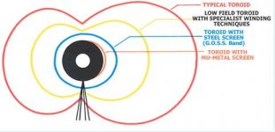

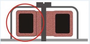

If this is not enough for shielding, there is a material that has solved many problems in the instrumentation that I normally use at work, the Mu-metal.
Search on Google, this is available in sheets or belt, you can also coat the can internally, always respecting the rules of the closed loop.
I attach some pictures on what to do and what not to do with the toroidal shields.
