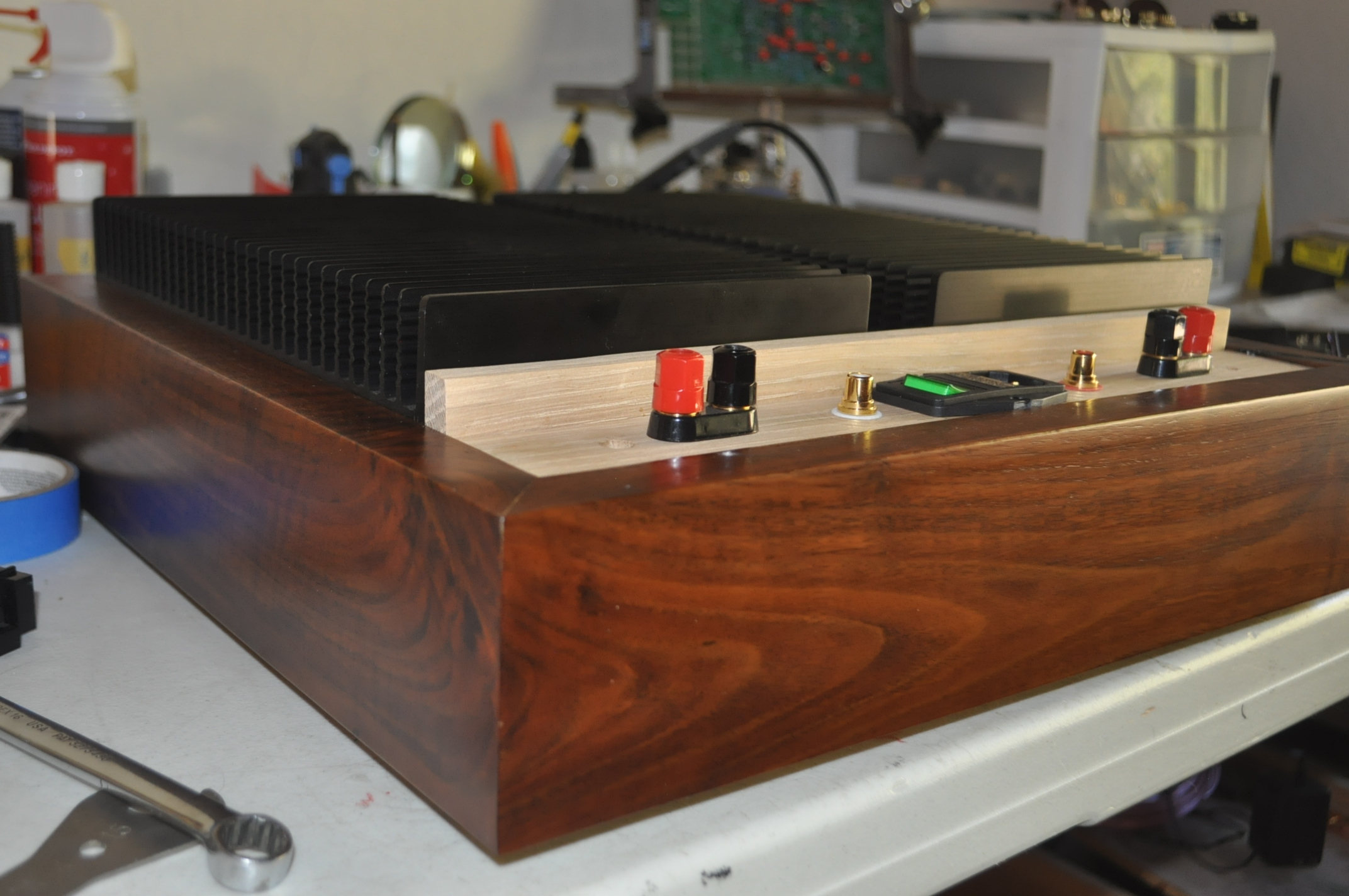

I have finally begun building an F5 amplifier that I bought the boards for about 10 years ago. Life happened and the build just had to be shelved. I have a couple of questions that I need help with. I am slightly above novice range when it comes to electronics, so please be patient with me. My Previous build experience includes a pair of ACAs and a Bottlehead Quickie.
1) I am also a woodworker. I realize that there are parts of this amp that will get hot. If I have appropriate heat sinking, and the base plat of the chassis is steel, would it be safe to build the rest of the enclosure out of hardwood?
2) I know it may be in the build guide, but how do I compute the amount of heat sinking necessary to keep this amp cool enough?

The base plate would need lots of holes for natural convection, or a fan.
These should get you started.
Heat Sink Size Calculator
Heat Sink Size Calculator | Celsia
Another thing is to reference the build guide corresponding to your F5 PCBs,
since it's possible you may have an older version.
Wood is not a great idea given it doesn't isolate from all kinds of nearby interference. Maybe line it with aluminum sheet?
