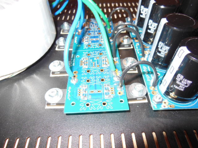

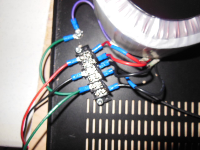

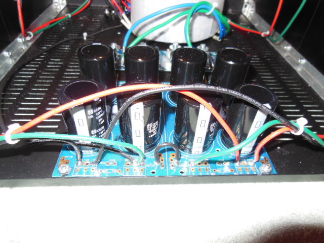

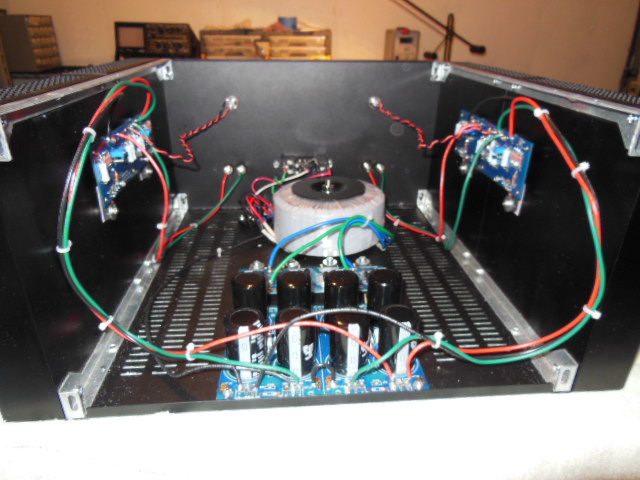

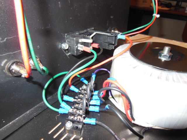

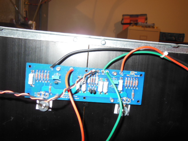

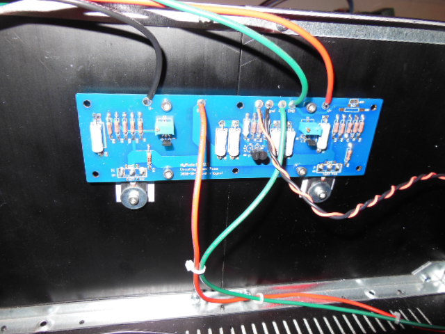

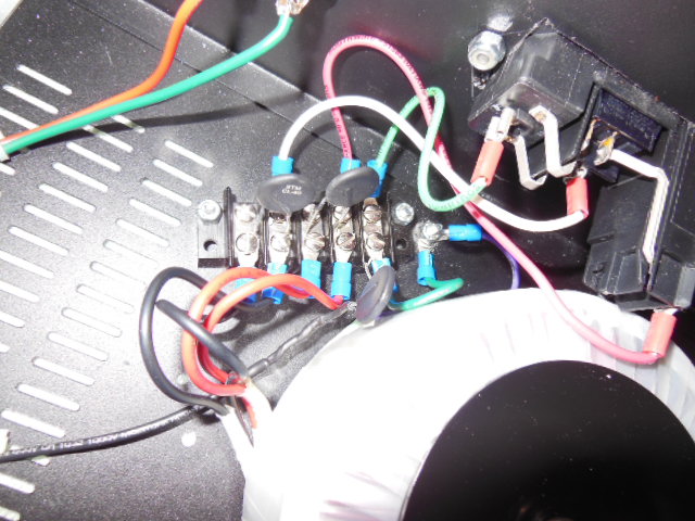

I went to start up my recently finished F5 and didn't have good results. I had tested the power supply before hooking up the amplifier boards and it worked fine +25/-25 volts. I was following the start-up procedure from the F5 Build Guide so all trim pots where turned fully counter-clockwise. I'm using a variac and three multi-meters. I started to turn up the voltage and all meters stayed at 0 volts. But when I got to about 50% on the variac (120v mains voltage) the thermistor going to ground began to smoked and the fuse blew. I've checked everything I can think so far. Thanks in advance for your help.

Clear nice pics showing wiring please. :)

Pics
Hope this helps

Can you draw your primary on how you exactly do this?
What is the violet wire color on the chassis ground BTW?

First clue is one of the LED's didn't light up. I'd disconnect the boards and troubleshoot the PSU first. Wiring looks good in the pics, but we can't see the rectifiers. Double check the Transformer wiring. Maybe hit all the solder joints on the PSU board and rectifiers again while you are at it and check for bridged joints, etc.
While the boards are disconnected from the psu check to make sure the mosfets aren't grounded. Also, check to make sure the tip of the mosfet thermistors aren't conductive. Sometimes they are and once they touch those washers on he mosfets they go boom. I know this from experience.
Before you do anything measure between the + and minus speaker posts (WITH THE AMP OFF!). You should have some resistance, like a few hundred ohms. If you don't or if if it's open then you have got issues with a speaker post/rca touching the chassis, or a grounded mosfet.
All of this may or may not lead to your ground thermistor issue, I don't know. But i am just reciting the issues I dealt with when starting my F5.

I tore the whole amplifier apart and found something weird. When I pulled the rectifier board a couple of the thermal pads under the diodes had perforations in the shape of a circle.
Originally when drilling the holes for the diodes I started in the wrong spot. These extra holes ended up directly under the body of some diodes. I didn't realize these holes had burs on them. The burs must have penetrated the thermal pad and so the back of the diodes where conducting to the chassis.
I did test the power supply like I had said, but when I did the wire going to ground with the thermistor wasn't hooked up.
Clear as mud?
I did make some changes when putting the amp back together:
I switched to a six position barrier strip and slid everything over. Now the grounds wire doesn't snake under the wires from the primary.
I ground down one side of the washers so they are not in contact with the thermistors.
I just tested the power supply and it works as it should.

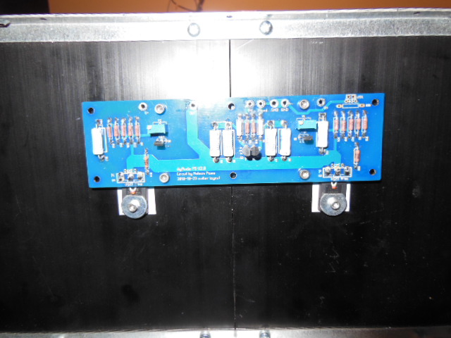

I'm stumped again. I have the power supply issues worked out. I hooked up one amplifier board and started to turn up P1 and P2 but I get essentially no voltage on R11 and R12 but I do get some voltage on the output. I checked the pinouts on the transistors over and over. Getting frustrated, better quit for tonight.
