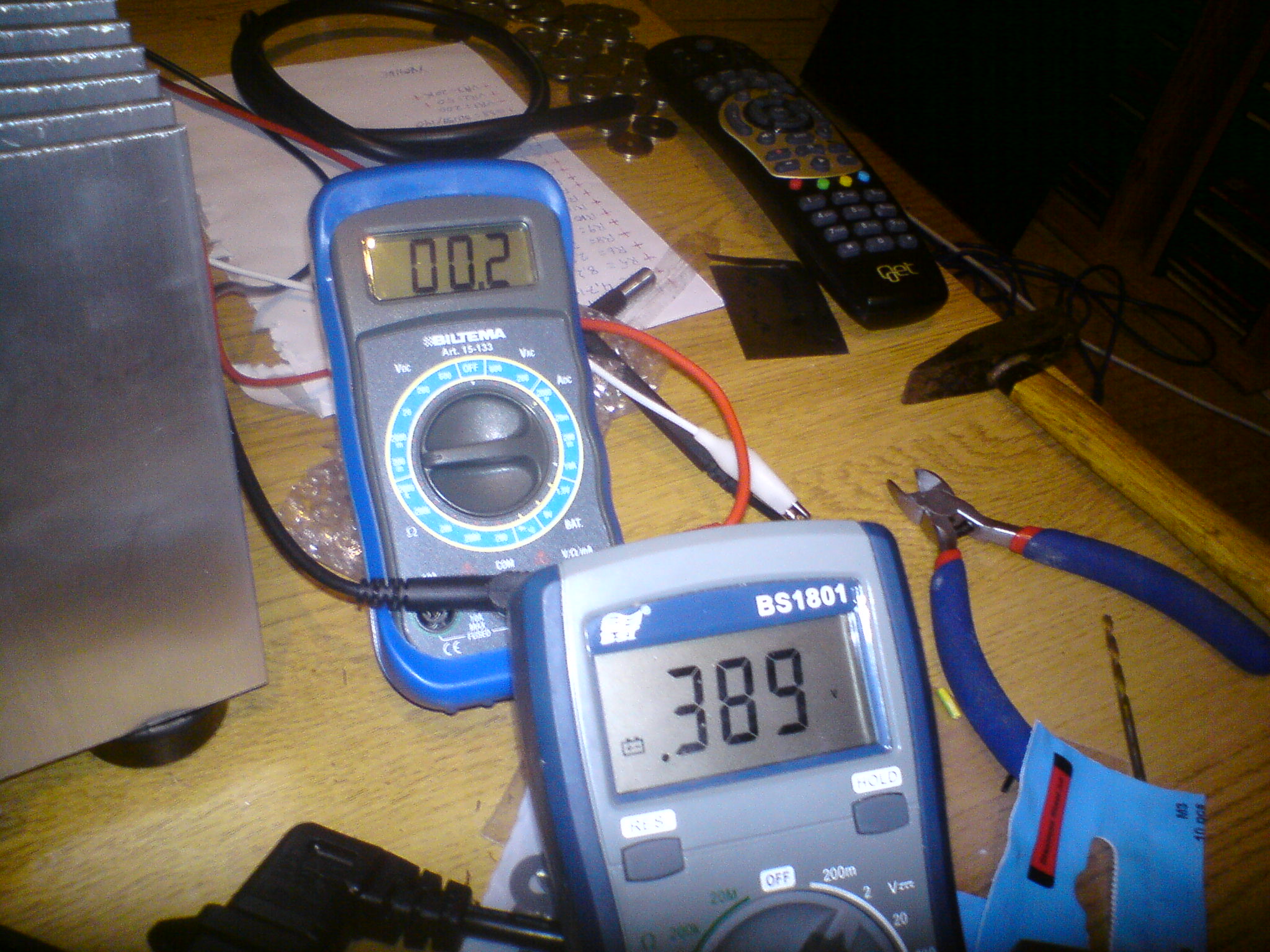

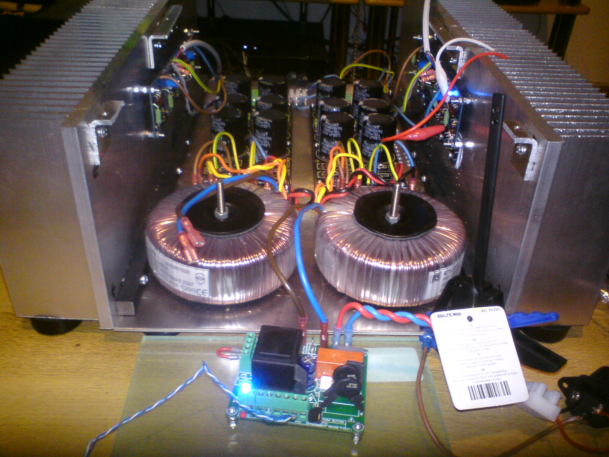

hello🙂 i have 2pc 225VA transformers in my F5. and a bias of about 1.72A(cviller's dual output's) and the transformer(only one ch yet) is nice and cool. about 32C.
anyone have an idè of how much i can crank the bias with those transformers? heatsinks is also nice and cool. maybe 37-38C ambient is about 22-23C.
rigth now bias is 1.72A. DC ofsett -0.4mV- +0.4mV

225 VA is not much to go on as it is the voltagge time current
so what voltagge is it?
If it is split secondary at 18 and 18 V 225 divided by 36 = 6.25 A total
Or you can take max 3.125 A out of each secondary
Papa reccomend a 3 to 1 margin so in respect to that you are already taking out enough.
rest is again realy meaningless as what size heath sink?
and ofset again got nought to do with it as it all down on how carefull you are when tweaking the pots.
If you go Papa class you need bigher trafoss

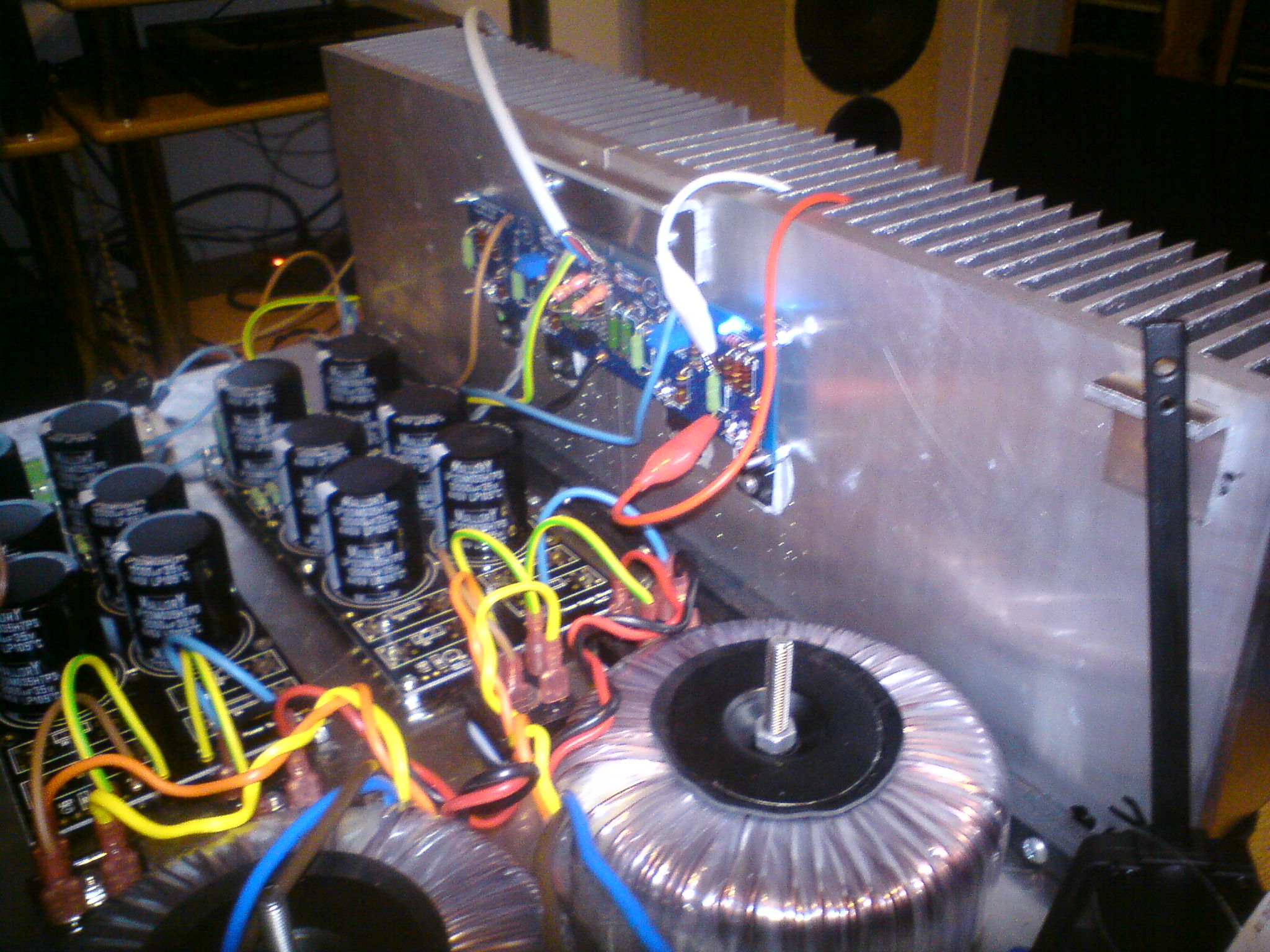

yes it is 2x18V transformer. so +/-22-23V no itd 1.72A bias. and the transformeris at about 32-34C witch is about 80W i think it will have no broblem with at least 120W.
BTW. it sounds fantastic. i just love it. but it's too cool😀😀
You may also need more capacitance in the PSU as ripple will increase when drawing more current.
it's 6x12.000uF pr.ch.

Which is not a lot.
A stock F5 needs 30mF per channel rail.
You may have to double this i you double the current.

it's not double current. more like 30% rise.
ripple is 3.59A eatch cap.
