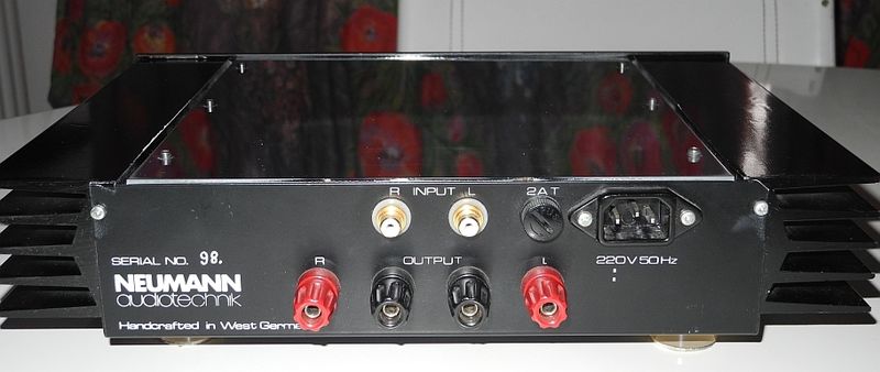

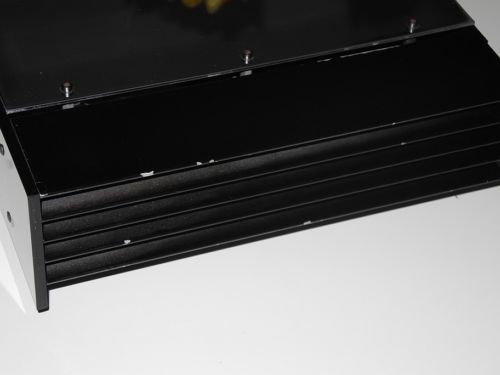

It was just an example that low height heatsinks are a smart choice : wide & low is more efficient than narrow & tall.
(your Conrad heatsinks have more rib depth, btw)
I put distance rings between heatsinks and top/bottom panels, ensures decent airflow within the case, in particular near the heatsinks.
Skips the requirement for perforated panels, adding a vertical ridge at the case bottom further reduces dust issues.
(has the side-effect that a PS transformer can be taller than the heatsinks, and other trivia)
Single reason for my posting was merely to point at options to increase the efficiency of the heatsinks.

a nice idea
It's an old one.
An elegant vented panel implementation was in the Neumann A100.2 ,top panel flush with the heatsinks.
German serial manufacture from the mid '80s (MOSFET Class AB power amp).
The spacers also served to protect the chromed top panel from damaging.
