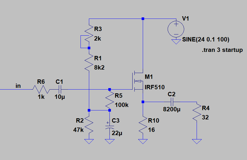

What about using something larger than 1000uF for output cap?
I see you used 8200, like the MoFo amp.
You're right. I was checking the impact of the divider's cap on startup with very big caps.
Imo, 1000uF is more than enough for headphones. If you go bigger, you really need a muting relay to avoid too much current going through the headphones at start up.
If you want to use the amp with both headphones and speakers, I'd make two different outputs. One with 10.000uf for the speaker and one with 470u-1000u for headphones.
That's good advice. Thanks!

24v 6.8A ??
The "power" is totally determined by the 16r resistor. 24V/16r = 1.5 Amps ABSOLUTE MAX. Biased for audio, 1.0 Amps per channel, 2A for both.
Making more current available to the resistor will NOT change the power you can get out of it.
Using a single 6A supply, it will loaf, the circuit gets all it can eat, and you avoid the question of how to connect two supplies.
Anyway if you wanted "power availability", you would not use this circuit and not with these values. The Resistance-Loaded power amplifier is most *efficient* with RL = 1.4 times load. For 8 Ohms, use 11 Ohm resistor. Bias to 16V-17V at Source. 3W/ch with 36W/ch dissipation.
If efficiency be dammed, Voltage is fixed, current is free, then you make RL "small". In small-signal work we might make RL 1/10th of the load being driven. Say 1 Ohm. HEAT rises faster than power output, but damm the efficiency. Ah, bias to about 13V, that's 13 Amps, bigger than your supply. Try 4 Ohms, a fair compromise. Bias a hair over 13V, 3.3A per channel, so two channels can sip from one 6.8A supply. (I'd round-up to 5 Ohms so the supply is not AT rating.) Now you have 7W/ch with 80 Watts dissipation/ch.
Headphone common return is not a big deal here. The amp has no voltage gain and the 16r RL swamps load current.

Should there be a resistor at the gate of the mosfet in this schematic?
I put in a 100 ohm since it's often recommended.
Not getting any sound, but the voltages look OK.
Wondering if the gate resistor is causing it.
Did I make a voltage divider?

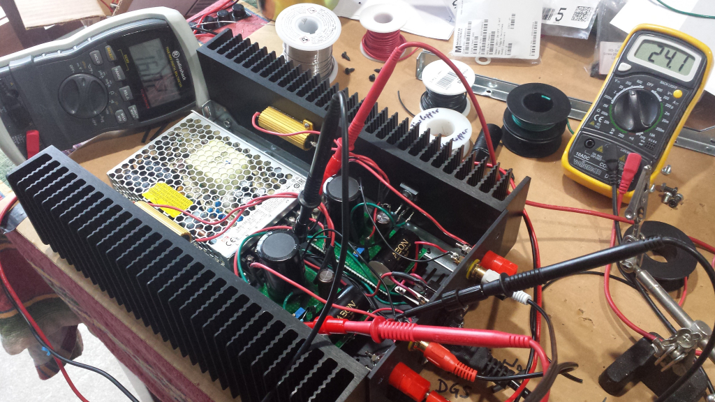

Got it working. I joined a point in the circuit that was not in the new schematic. The 5k works ok. Able to adjust voltage center point. Also left in the 100 ohm resistors on the gate.
Immediate impressions are very good. Despite my usual sloppy wiring, its quiet.
This little amp has a soul. The detail pours out of it. Its layered.
Solid imaging beyond the speaker edges , depth is pretty good.
Its driving an 87db sensitive 6 ohm speaker, but its hanging in there.
There's also the nice impact you get from power followers, like it has more power than spec'ed. There is a turn-on thump.
I can sense distortion in the highs, but it's because I'm driving it a bit hard and using rock music. Has a sweeter quality with jazz and softer music. Highs might be rolled off some but not really missing anything.
Using:
irfp150n mosfets
Mostly generic metal film resistors, except a couple PRP resistors.
Mills aluminum housed power resistors.
8200uF Elna caps that I had pulled from a reciever 25 years ago.
PVC copper wiring.
Generic input and output connectors
24v, 6.7A smps power supply.
Hifi2000 case
Don't sleep on this one if you want/need a good, simple amp you can build over a weekend or two. It's also a good intro into power followers with no exotic parts. Heat sinks are small yet its only warm to the touch. Oh yeah, and it's supposed to be a headphone amp. 😉
