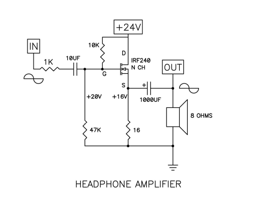

Is the 16 ohm resistor rated at 16W?
16v through 16 ohms is 1 amp? 1A x 16v=16w?
Yes, plus a safety margin. This circuit is class A, so there is
considerable quiescent power dissipation.
dissipation P=I^2 x R
P=1A^2 x 16=16W

Can get some Mills wire-wound 12 or 18 Ohm for 25% off.
Would 12 ohm or 18 ohm throw off the design?

18 is close enough
though , note that you need to establish some kind of biasing fine setting ....... besides having sensible matched pair of IRFP , for two channels

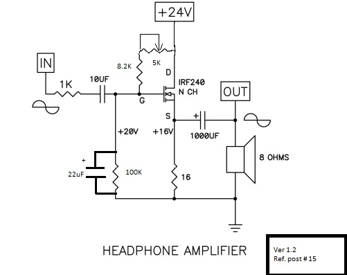

I was wondering if 10k or 47k was providing bias or both acting as voltage divider?
They are not feedback, are they?
Could I use a 50k trim pot instead of a 47k fixed?
no feedback in classic way , because there is no significant series impedance in gate...so biasing voltage divider
better use 8K2 in series with 5K pot (connected as variable resistor) , instead of 10K
though = you need that only if you want to tweak Iq
if not , everything as is , use matched mosfets and you'll have same Iq in both channels , slightly smaller than 1A

...Is the 16 ohm resistor rated at 16W?...
It *dissipates* 16 Watts, yes.
If you build cheap and sell on 30-day warranty, a 16W rating may be good enough (but a fire hazard).
For yourself, *always* double the dissipation then round-up generously when you shop. A 25W sand resistor really is not enough. The "50W" chassis-mount only do 50 real Watts on a HEAVY chassis or honest heatsink. Myself I'd look for four 10W 64 Ohm sand-resistors and some hi-temp lug-board. I have used 25W chassis-mount at 4W each on a heavy chassis (special case: home heat fan controller, and I don't want it to fail on a bad day).
It's actually a rather poor way of providing bias (that schematic isn't full fledged, it is there for illustration). It will inject the PS noise at the input. It would be better to run a divider with a 22uF cap in // with the bottom resistor and take the bias from there through a 100k resistor.
It will also limit the start up thump from the output cap by slowly ramping up the bias.

This being said, the cap might not be actually necessary with a switching PS; some are very quiet at audio frequencies, even under heavy load. But some headphones are also very sensitive...
Another possibility is to do it like Pete Millet did it for his hybrid, by adding a RC filter before the bias divider.
