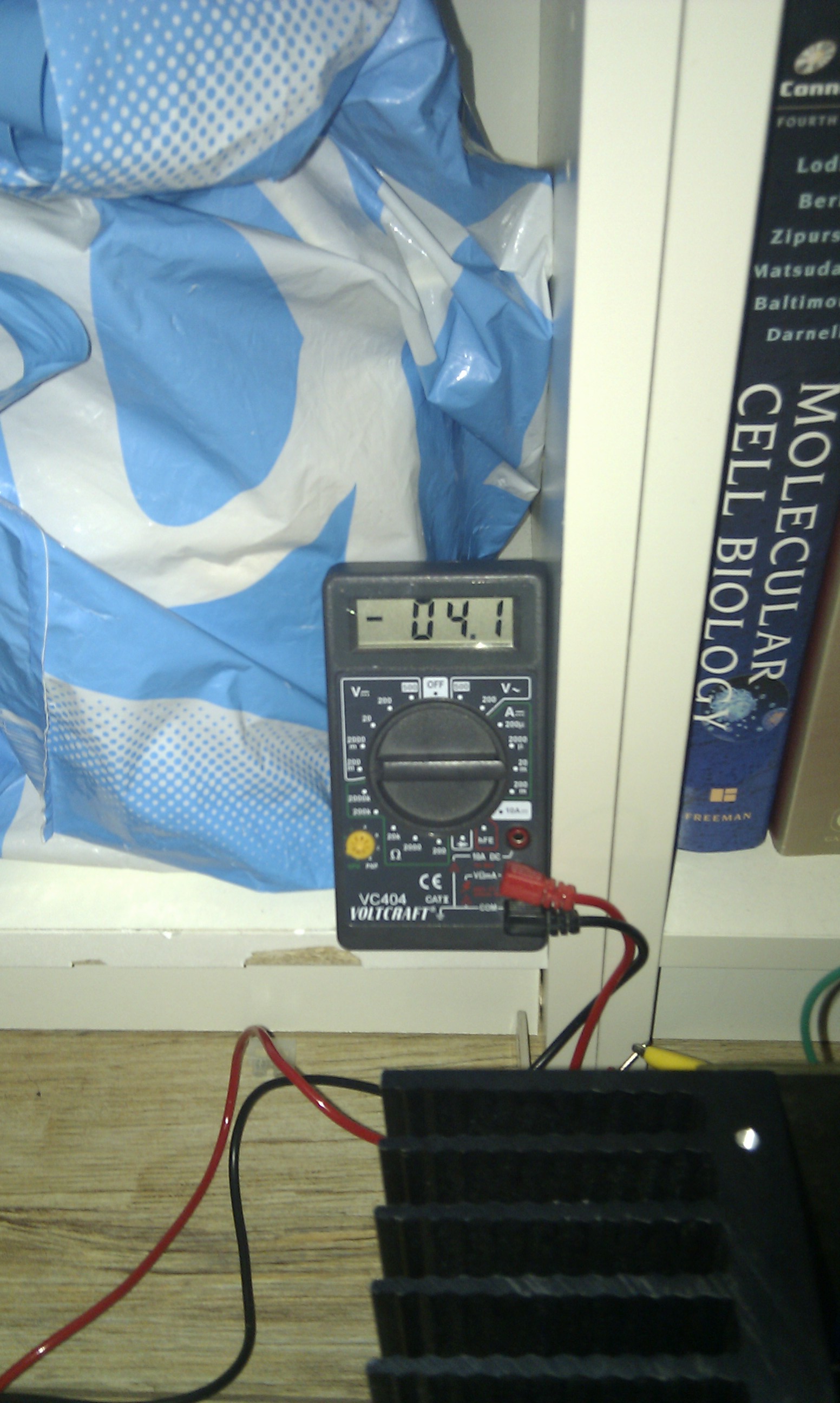

Don't ask why and how, but yesterday evening everything was OK...
I think the figures are good as they are to burn in the components.
0.515 V over R11 and R12, and 4.1 mV DC offset! I probably can tweak it to zero DC.
Both channels at the same BIAS but a slightly different offset.
This weekend will be a good one for further setting up the amp!
Nils
