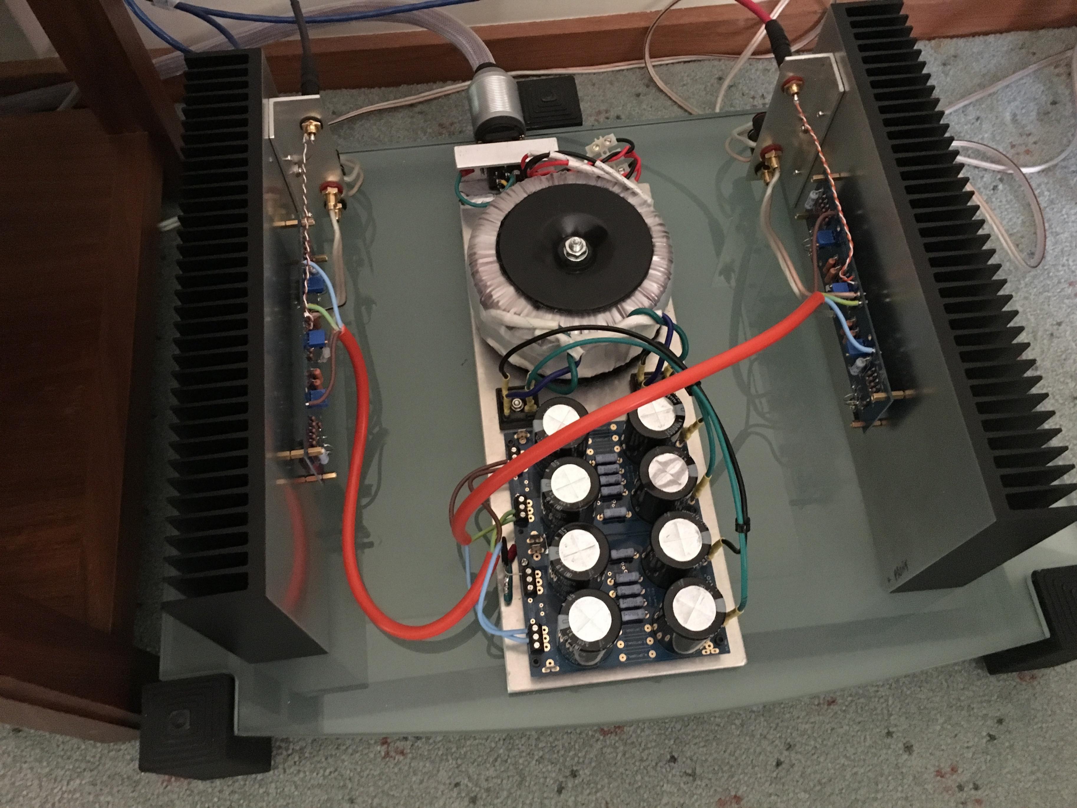

I built an ACA and was quite blown away, then did an F5.
The F5 isn't housed in a chassis yet, but wires are fairly well separated.
Its got maybe 15hrs on it. It seems to be missing something in the upper bass, the acoustic bass in Tears in Heaven by Clapton (live) has almost disappeared, its very faint.
The ACA presents the same song bewdifully!
Checked all phasing which was fine, yet the lower bass registers are also fine. I noticed the upper bass missing in quite a few other CD's but never really nailed exactly what was missing until I played Tears in Heaven.
F5 bias is set at 0.59vDC, DC offset 10~15mV.
I have P1 mounted, set mid range (30 turn pots) so set at 15 turns
Heatsinks are static at 39degC
Rails are +/- 22.8vDC
It's using the following;
Antek 5218
Monolithic 35A Rectifiers
16 gauge wire for DC power
Twisted CAT5 for inputs
16 gauge output wire
120,000uF Caps total (+ and -)
When I changed the ACA v1.8 out for the F5, I changed nothing else.. just the amps.
Your wiring is too long and all over the place. Usually, when a piece of a spectrum does not sound right, the issue is related to an incorrect power supply impedance. FW amplifiers do not have any local power DC rails' decoupling on AMP PCB's..., so you could search on this topic as well (the local decoupling would require a complete re-think with regard to AMP PCB design...)
I'd look at how to properly wire the amp, how to properly route grounds and common returns. Nelson has posted in one of the threads, a picture of a screw with proper placement of the common (negative) returns. This can be implemented with that PS PCB (only just...) - not all ground points on that PCB are interchangeable, the ones closest to the caps should be used for the connection to the chassis (and here... only a DC thinking has been used on so many builds, with very long and thin NTC wires in the return path... you have to start thinking AC / RF-noise here...), then comes the speaker common return; the one further away from the capacitors should be used for small signal returns. This will make a huge difference in sound.
For example... An audio amplifier needs a very low output impedance to drive a loudspeaker; yet, so many builds (yours included) have speaker common return going to AMP PCB first, and then back to PS PCB (usually via the same cable that carries the small-signal return !!). This should get you started I hope.
EDIT: I had a close look at your PS PCB - the only capacitors doing filtering are the large electrolytes. That can't be good, especially with nil AMP PCB's local decoupling.

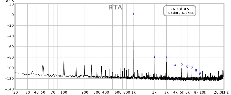

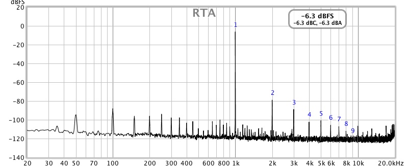

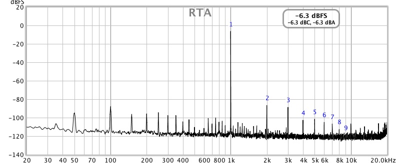

I ran the F5 on FFT. CH1 on input, CH2 on output (4 ohm load). DMM's watching bias and DC offset
Its not possible on my scope to math deduct CH1 from CH2 and FFT the result, so simply ensured 1KHz sine wave in was clean of harmonics before looking at CH2.
The amp harmonics responded to P3 movements, I knocked the H3 down a tad then re-biased. Just need time now to sit down and sound test results... will do later this week.

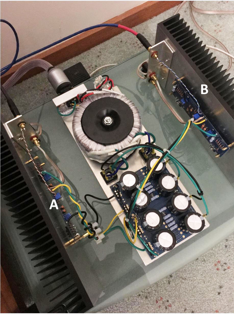

OK I'm going to attack this hum I've got. Before I do can someone confirm please I can safely do any of the following in tracking down the hum:
can speaker "-" be wired directly to chassis?
can input "-" be wired directly to chassis?
can amp PCB ground be wired directly to chassis?
can PSU PCB ground be wired directly to chassis (with no thermister)?
Is the audio/power supply ground at present connected direct to the chassis, or through a diode/resistor/thermistor?
To do any of the others, it would have to be wired direct.
I have 2 grounds as follows;
1 - mains earth in direct to chassis
2 - psu PCB earth to chassis via thermistor, CL-60
both of the above are seperate earth points on the chassis
I just swapped around the speaker return and PSU ground on the amp PCBs ground points.
So now the speaker return is closest to the line inputs, this has made a dramatic improvement in the reduction of hum, however there is still a very very slight hum there.

Does A channel hum louder than B? Or is the hum on the B channel louder?
Make sure the RCA's are shorted.
Allan, You asked in post #31 about wiring arrangement. The diyAudio F5 build guide shows wiring of the power supply, signal inputs, and speaker outputs.
Firstwatt F5 amplifier v3 - diyAudio Guides
The guide also shows arrangement and location of power supply and power transformer. The location of power transformer can have major affect on hum. Power transformers emit unwanted electromagnetic interference (EMI) that can be picked up by signal wires and audio circuits. The best location for the power transformer is as far away as possible from audio signal circuits and wires, especially low level signal wires.
You have located the power transformer very close to the signal inputs and wires. That is not the preferred location. The build guide shows the best location, at the front of the amplifier, as far away from the input signal wiring as possible. If you look at pictures of factory assembled First Watt amplifiers, the power transformer is located at the front and the power supply board is towards the back.
As mentioned earlier, rotating the transformer to find the best orientation of the transformer should also be done. Antek transformers definitely have noisy and less noisy transformer orientations.
Ben, this sub chassis was really only intended to used for easy testing, tweaking prior to making the final chassis.
I understand the transfo must be furtherest away from low level signals and will take this into account in the final build.
May even flip the transfo on its side too.
I rewired the psu DC out when I swapped speaker return and PSU grounds on amp PCBs.
Since, after about 30mins of running things seemed to have quietened down even more.
The hum now is almost not even a concern.. I'm struggling to hear it, so I'm calling the hum issue resolved and will move onto the chassis build.
I feel very confident in the final build with transfo repositioned she'll be dead silent.
