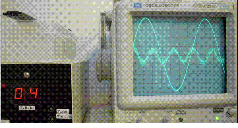

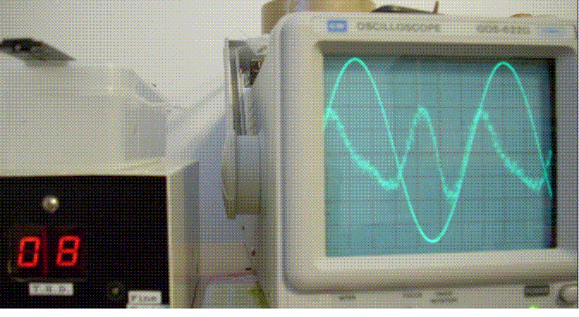

I experimented yesterday with the concept on my F4-Fab type amp (but it has changed since then, cascode input, cascode VAS, driver stage).
I only have one mosfet pair in my prototype and tested at about 330 ma bias (I have increased my power supply voltage from 24 to 37 Vdc). The test done is for 1Wrms into 8 ohms with NO overall feedback:
I am posting the THD scope traces without and with a current source "displacer" between output and negative power supply as show here: http://www.tubecad.com/2006/12/blog0088.htm
First picture attached is without the displacer:
sorry for the quality but 100Kb max for an attachment...
THD is 0.08% (I know slightly higher than preceeding post but the bias is now reduced and it is a different circuit)

With the added current displacer, the THD is reduced by half to 0.04% but probably more important is that now it is mostly second harmonic ...
I used 175 ma CCS so it is about 6.5W more dissipation.
:eek:
I did not follow the 1/5 of the bias current since my Bias is relatively low (330 ma)...:xeye:
Another drawback is that to obtain only second harmonic THD, I need to re-adjust values trying to minimize DC offset generated...:D
