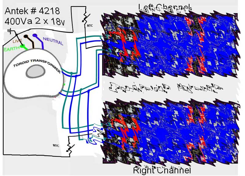

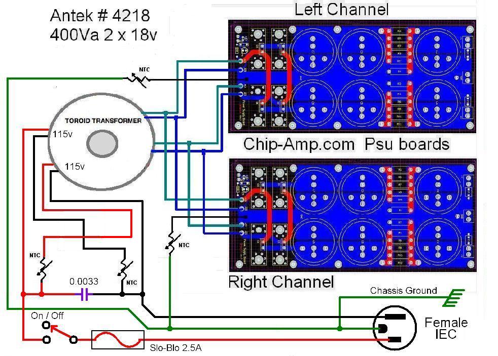

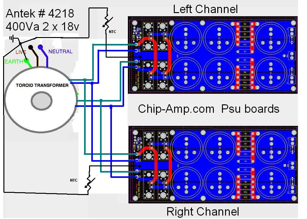

How about 4) CL60's Hope this is correct !
F4 Final Layout.jpgAttachments
Are the 2x18V AC secondaries enough ? We can get lower than 23V after filtering.
Or better to have 2x20V ?
