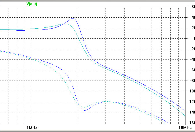

I have isolated the cause of a highly undesirable resonance in the Bode plots of the simulation, shown in the plot below. After some investigation the cause was determined to be the TL431 cascode bias generation circuits. Adding a 1k resistor between the TL431 and the cascode BJT base decreases the Q of the resonance, but does nothing to eliminate it. (Blue trace is without the 1k resistor).
I found the following papers that discuss the problem:The problem is caused by a capacitive load on the output of the TL431 and probably by the feedback loop through the cascode transidtor. I am not sure whether the problem is worth worrying about, but it seriously screws up the simulation phase and gain margin estimates. Perhaps that is good reason to use a resistor divider in place of the TL431 circuit for simulations. If cascode feedback is not being used, there is no need for the TL431 circuit. Even with cascode feedback, the PSRR and rail voltage issue issue might not be a problem.
A problem with CFB and resistor dividers is rail voltage variations and noise. Low frequency rail voltage variations will change the voltage on the base of the cascode transistor, changing the current the the feedback resistors, changing the current thru the drain load resistor (pot), changing the voltage to the MOSFET gate, ... If the cascode feedback resistors have the same value and the rail voltage variations are the same (but of opposite polarity), the only effect will be equal changes to the FE MOSFET bias current, and a slight change to OLG. I have a different approach to using resistor dividers and CFB that reduces the potential problem by about a factor of 10.

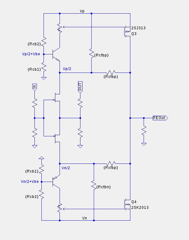

Another downside to the resistor divider is the output impedance. A 4k7/4k7 divider will have an output impedance of 2k35. With the TL431 the impedance is very low and sometimes requires an additional resistor to increase the impedance. Papa's 1k resistor might have been in accordance with figure 8 in http://www.ti.com/lit/an/slva685/slva685.pdf.

Here is a CFB scheme, using a resistor divider for the cascode transistor bias voltage, that greatly reduces the effects of rail voltage variations. It also has the benefit of increasing OLG because in the quiescent state the cascode feedback injects zero current into the cascode emitter.
