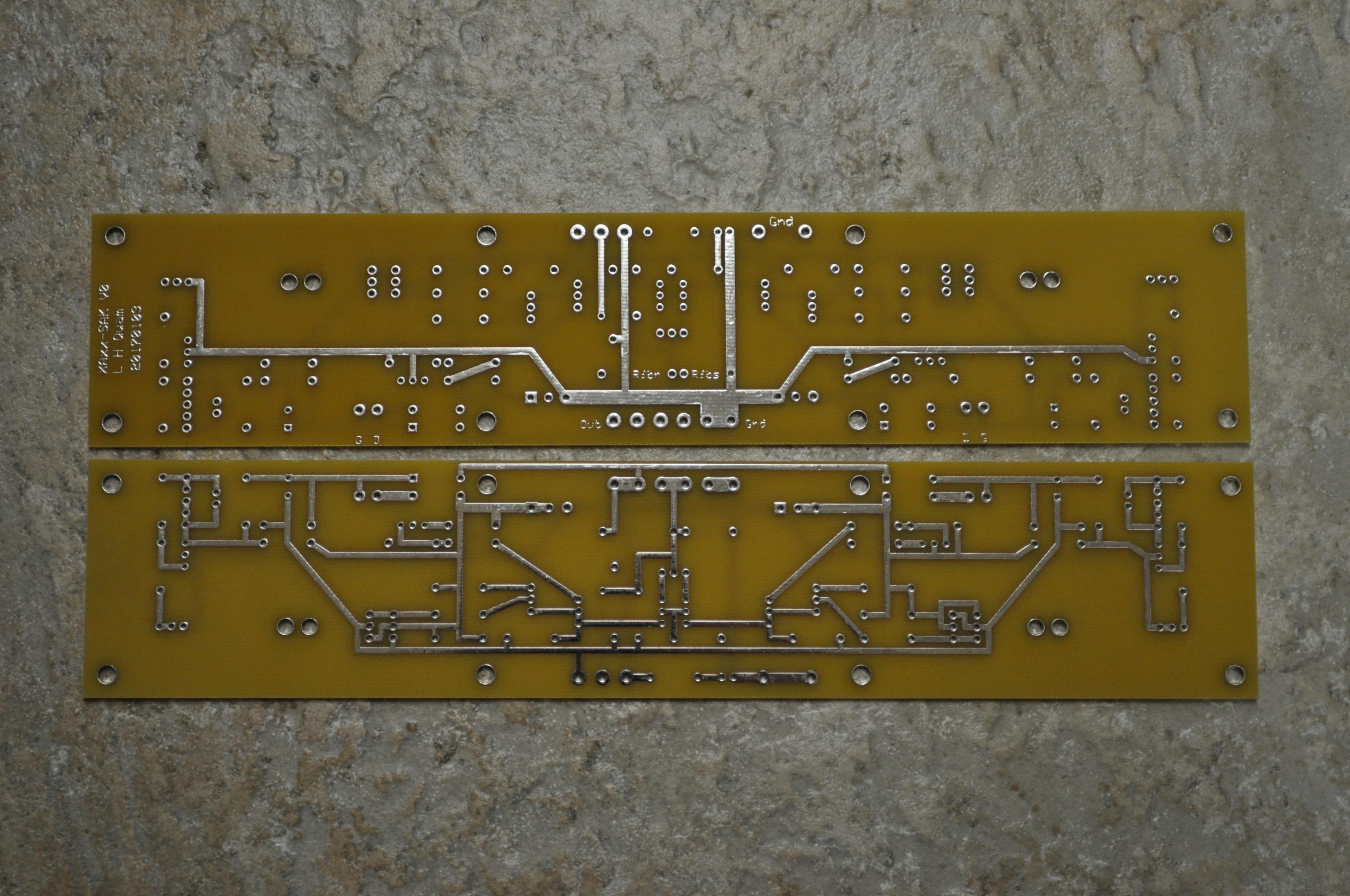

Output stage assembled and tested. Everything works perfectly.
Next up will be to solder it all up on protoboard and play some music through it.
Congrats! Half of the amp is living...... 😀😀😀

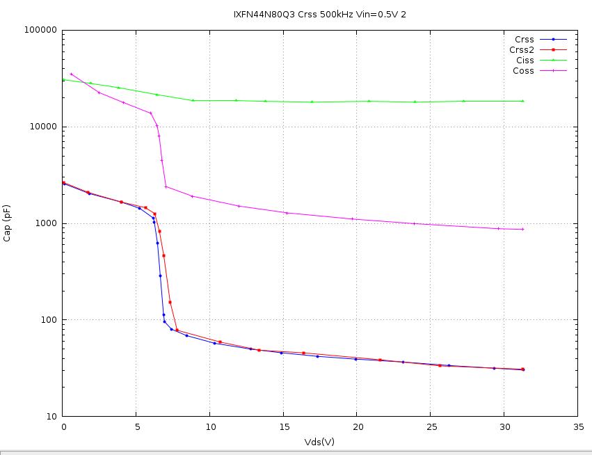

Here are some IXFN44N80Q3 capacitance measurements. They agree fairly well with the datasheets:
Where are the measurements?
Hahahahaha
You want measurements? I give you measurements:
The columns are Capacitance, Vds
IXFN44N80Q3_Crss_500kHz_Vin1V_100R_3:
matrix(
[2639.643, 0.100],
[2092.511, 1.741],
[1660.747, 4.010],
[1452.482, 5.639],
[1261.769, 6.273],
[832.730, 6.587],
[465.920, 6.884],
[152.764, 7.323],
[78.104, 7.801],
[58.946, 10.738],
[48.607, 13.373],
[45.566, 16.416],
[38.661, 21.603],
[33.452, 25.637],
[30.854, 31.297])$
IXFN44N80Q3_Ciss_100kHz_Vin500mV_100R:
matrix(
[30660.732, 0.100],
[28124.641, 1.907],
[25384.206, 3.827],
[21513.361, 6.430],
[18652.306, 8.868],
[18676.345, 11.821],
[18326.933, 13.792],
[17984.509, 16.979],
[18344.200, 20.814],
[17984.509, 23.962],
[18344.200, 27.260],
[18344.200, 31.301])$
IXFN44N80Q3_Coss_100kHz_Vin500mV_100R:
matrix(
[34911.407, 0.620],
[22577.794, 2.503],
[17806.444, 4.150],
[13775.596, 6.011],
[10298.261, 6.429],
[8063.850, 6.572],
[4484.476, 6.769],
[2402.339, 7.037],
[1911.000, 8.833],
[1507.201, 12.013],
[1283.067, 15.274],
[1107.870, 19.707],
[993.041, 23.905],
[879.751, 29.626],
[865.696, 31.295])$
I am so happy that you fill the gap between believing in the PDF data and reality!
