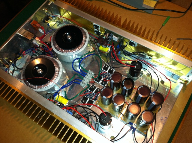

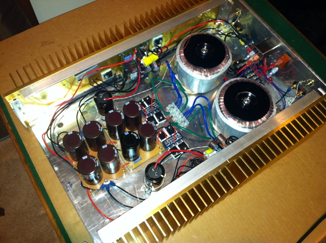

Here's my Zen 9. Pretty much an F3. Pictures always get me fired up.
Maybe it will inspire you. 😉
Good luck.
Vince

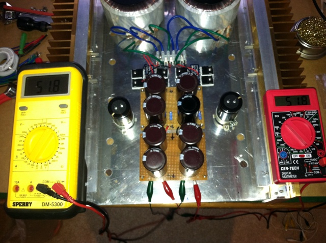

They are Antek audio grade transformers. They have a shield wire that runs to ground.
Each is 18+18v, and wired for 36v AC. I don't remember the current rating, but one can just about run both channels.
Audio grade is indicated by "AS" in the model number. Its either an AS-3218 or AS-4218.
