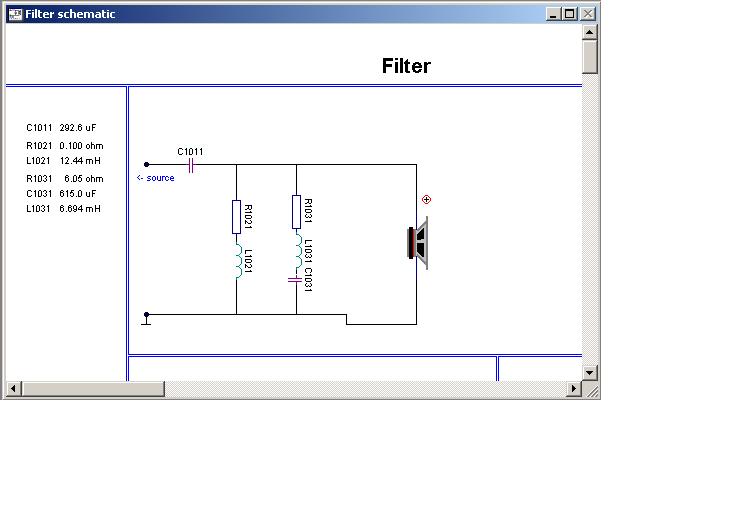

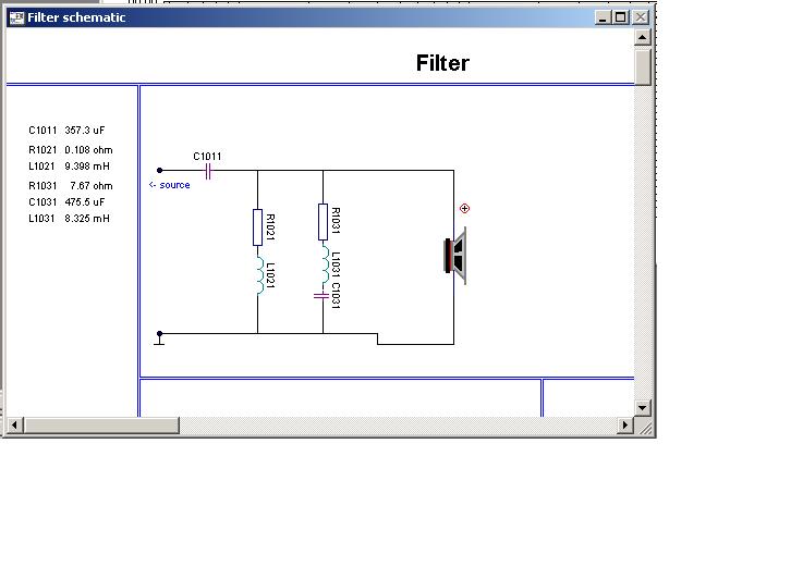

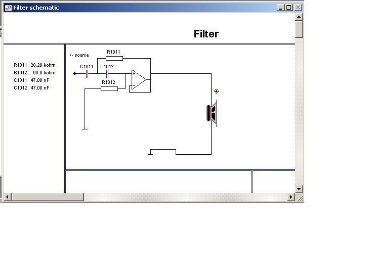

My knowledge of crossover design is not very complete, so I apologise in advance for my stupidity:
If I were going to build my own crossover for the sub/mid consisting of a 12db/oct high pass (combining with the high pass formed by the mid enclosure) and a 24db/oct low pass how would I go about this? I assume I'd find the peak impedance of the driver in the box which would give the F3, but where from here?
It would be preferable to have a high pass on the main speakers in order in increase power handling and limit excursion.
24db/o low pass on the woofer and 12db/o hi pass on the mid is going to require an electronic crossover. A passive network is out of the question.
I have the 24/12 bi-amp solution on what passes for my HT installation and am very pleased. And, believe it or not, the electronic crossover I'm using is made for cars. I just added a 12v power supply.
