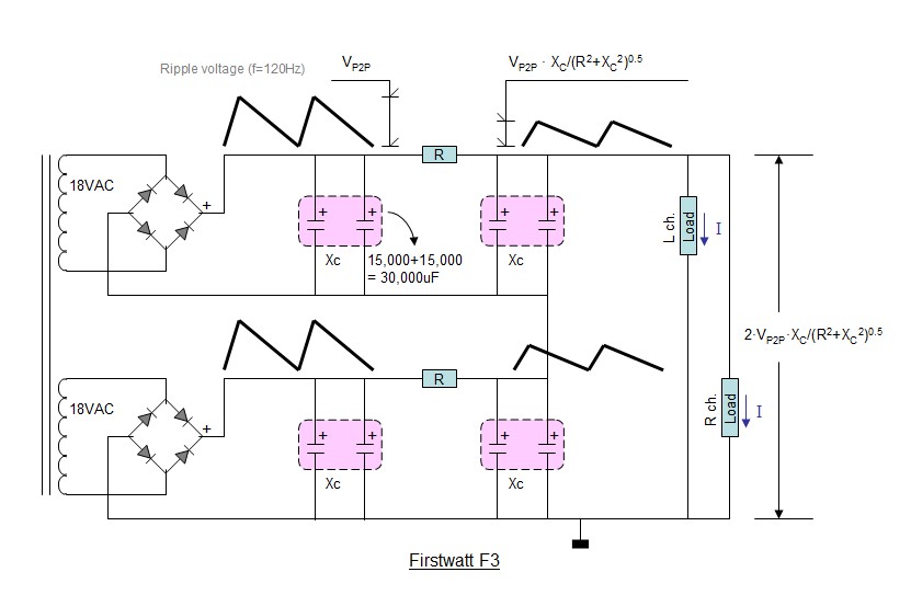

Thats a good reason:) Having many 25V caps, and needing 50V's, option 1 is good. Flexibility is a good thing, and using the same supply for different amps, has a lot going for it.
By looking at option 1 and 2 (without considering anything else) they are equally good, ripplewise. The bad news about option 1 is that you need 4 caps, not 2 as in option 2. The caps for option 2 will ofcourse need to be higher voltage rated. The good news about option 1 is that you can use lower voltage rated caps. 2 x 25V caps connected in series will equal a 50V, but at half the capacitance (assuming they are the same e.g. 15.000uF, which results in 7500uF)
This should clear up the issue;) Just pick the most suitable option, after checking your inventory of caps.

Still I can't remember whether I have said option one is better.
Papa's PSU boards provided for F-amps are transfomers in three ways. Here I attach one method that fits for F3. Looking at this F3 PSU and amp circuit, I feel that Papa must be crazy, or at least crazy enough.
With this F3 PSU, I have estimated the peak-to-peak ripple voltage on the rail of 46Vdc. It is about 0.6Vp2p with 1.5A load current per channel. It is calculated to ripple factor of about 0.004, i.e. 0.4%. On top of this, the amp cuircuit has even a capacitor multiplier at its power supply entrence :bigeyes:
Papa irons and irons the rail just flat . . .
Mark, I would use any of option one or two at my convinience.
