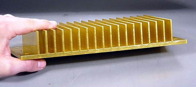

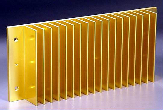

I want to build a F3 (aka Zen 9) and have a set of 4 heatsinks that might work, but not sure if they big enough. I think they are cutting it close. F3 dissipates 100w per channel. That's a tall order. Intended to use 1 heatsink for the 2 mosfets and another for the power jfet and mosfet. Here's the dimensions of one heatsink.
Back plate: 10-3/4" x 4-9/16' x 1/4'
Fins: 18 per HS 1-3/8 x 4-5/8 x 3/32, Not including height of back plate
Overall Dimensions: 10-3/4 x 4-9/16 x 1-5/8
Let me know what you think! 🙂

As you already have the sink why not rig up the mosfets as if you where matching the VGS run them at the suply voltagge and bias to suit
EG 25 V 2 A = 50 Watt an see how hot they get
It is difficoult to say from pictures
Base plate only 8 mm? fins 40? + they would run cooler if anodised black.
I was going to build the F3 with heat sinks only on the bench; without a case. This way, if these are not big enough, I'll just fine other HS to use.
