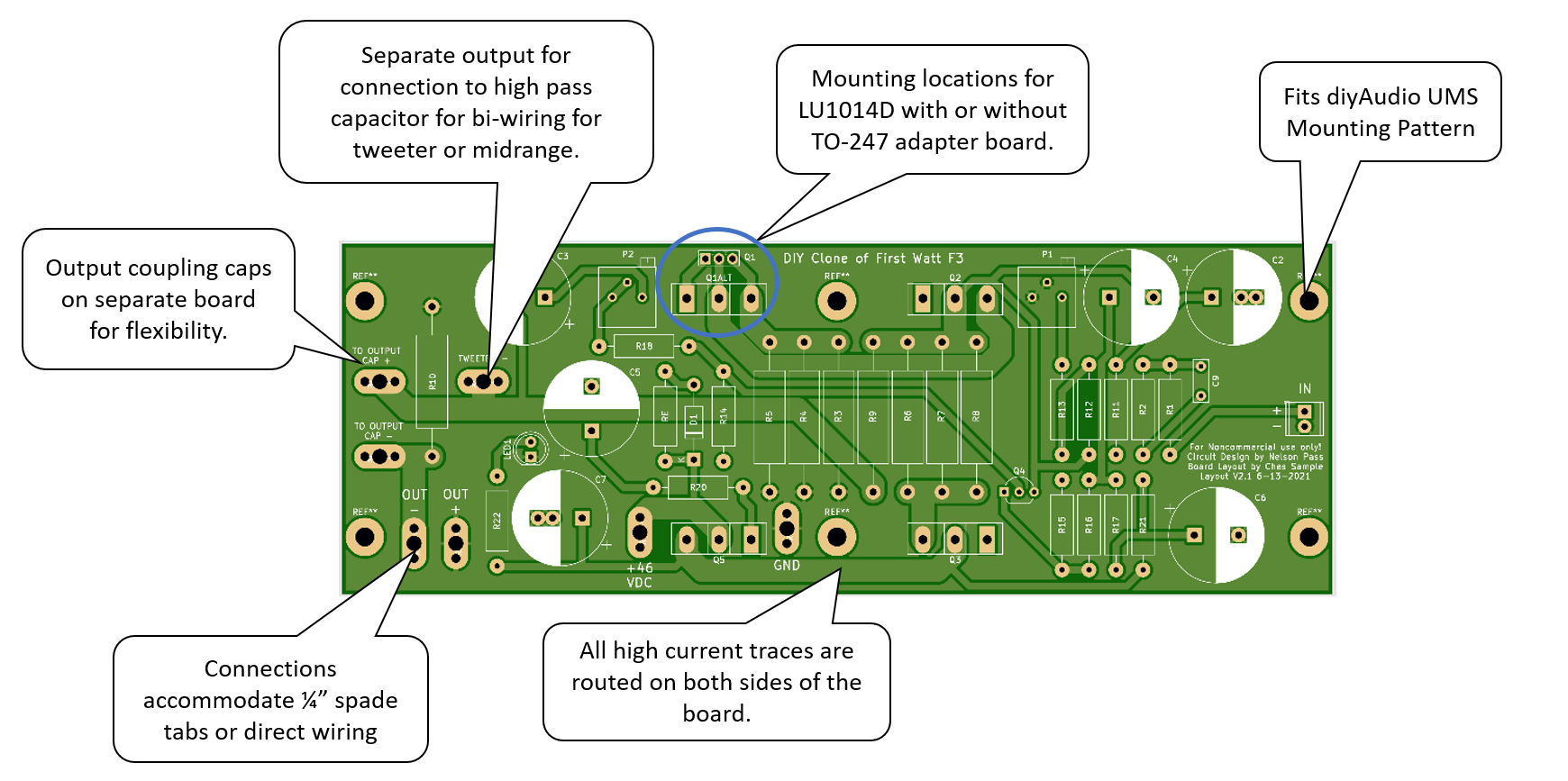

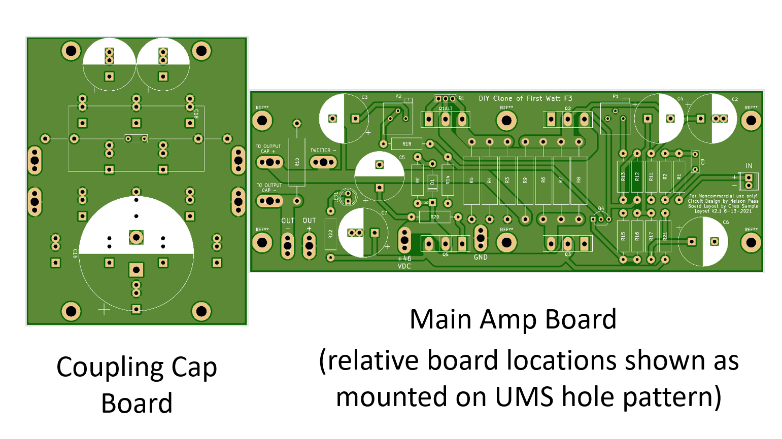

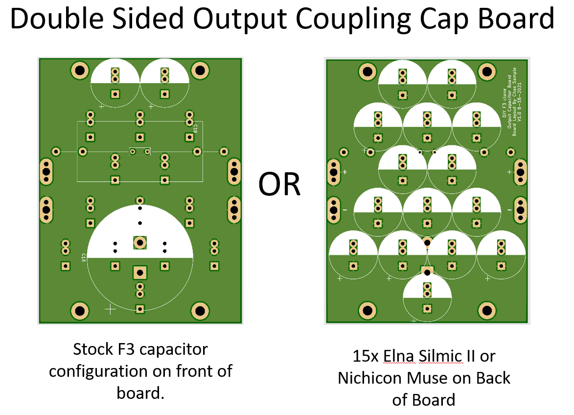

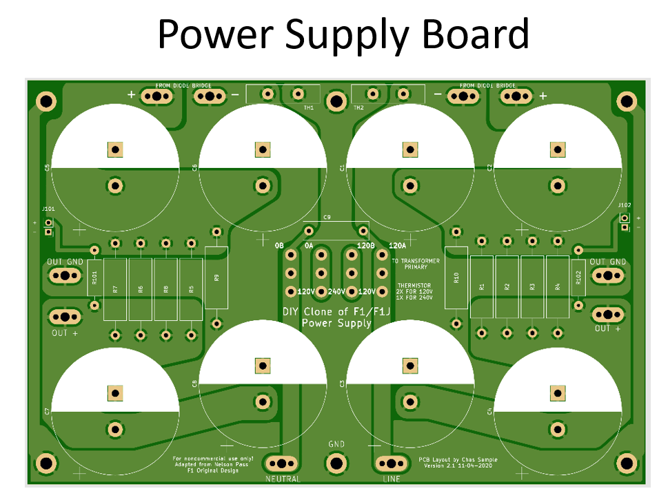

This is a group buy for circuit boards to make a diy clone of the First Watt F3 amplifier. This board set is designed to work with the diyAudio store UMS mounting pattern making life a little easier for those having UMS chassis.
The design is about 80% done and now it is time to gather input and make refinements before ordering a test set of boards to validate the layout.
The images below show the basics, and the .pdf has more details about the boards, preliminary pricing, and a tentative schedule for the group buy.

Nice that you included mounting options for the LU1014D on the main pcb 😉

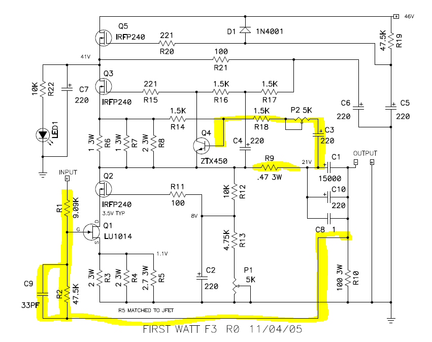

Just curious, are you including option for aleph current source, or feedback? There are some improvements to gain. Please see fig8.
https://www.passdiy.com/pdf/ZV9.pdf

Nice board layout to accept the XRK adapter board.

Hi Adason, thanks for bringing up the Zen V9 Aleph current source and feedback, I think the standard F3 has both of these elements. I highlighted what I think are equivalent parts of the Zen V9 and F3 circuits, if I missed something please let me know, I love adding versatility to the boards to allow for more tweaking and build options.

You are right Chas, its all there. Can't wait to build it. Thanks for doing the boards.
Btw, I find the effect of feedback confusingly minor (Fig7), yet the aleph current vs constant current quite a improvement (Fig9).
Just wondering if actual dimensions of the boards could be posted.
