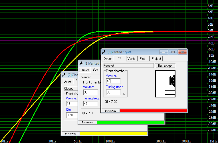

For the bass end in general its not best to optimise F-3dB. F-6dB
is a lot better and sometimes even F-10dB for some drivers.
This allows room gain to work properly and low frequency vent
tunings help prevent overloading below the vent tuning frequency.
Ideally you would add a peaking high pass filter at around
30Hz for AV use, probably not needed in a music context.
The red alignment has near the same -3dB, better - 6dB
much better -10dB. It will sound deeper and tighter.
rgds, sreten.
I'd tune 55L to 30Hz, but reckon 40-45L 33Hz is about right.

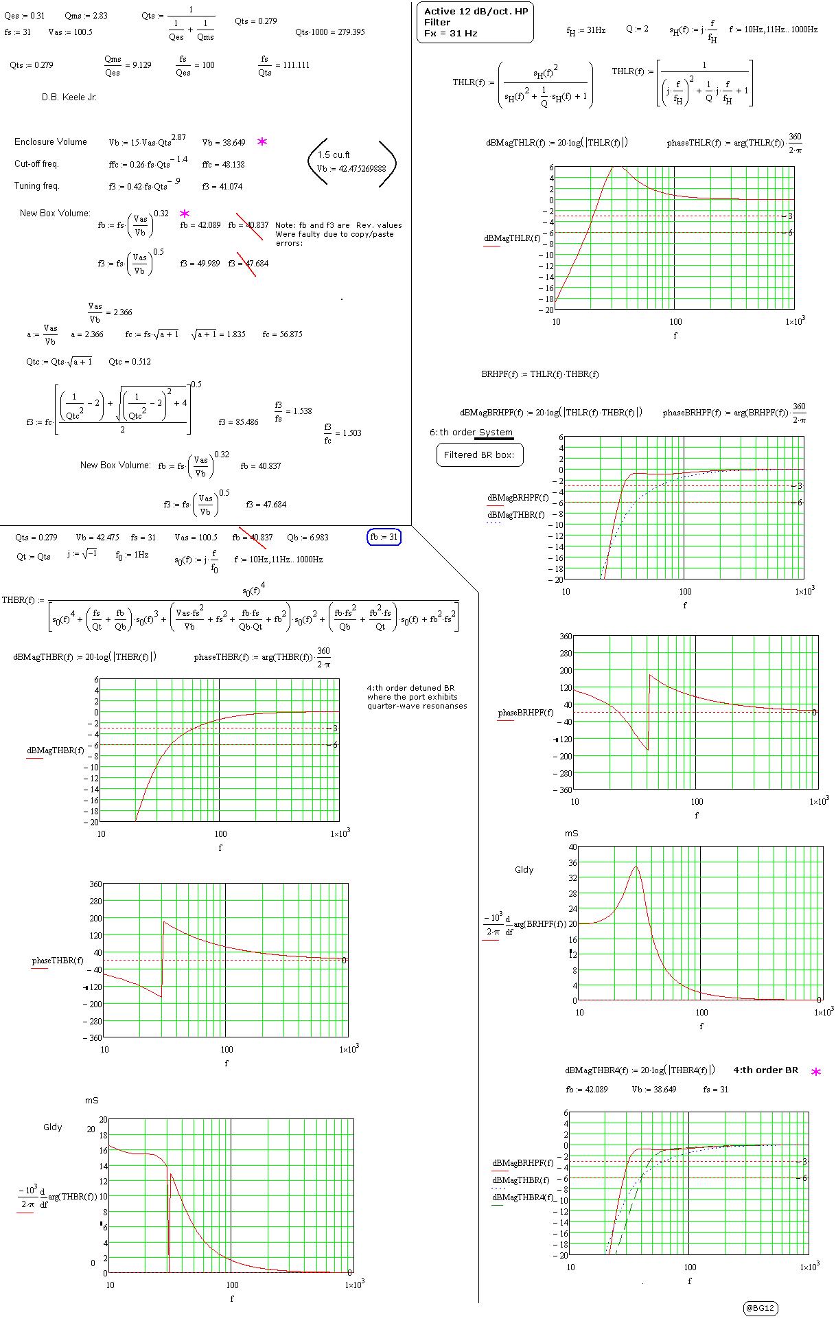

I punched in those same numbers and kept getting an F3 of 60 something Hz. Then I noticed the "Active 12 dB/oct. HP Filter". After adding this the F3 dropped down dramatically to 31 Hz. :eek:
How does that work? What exactly is this "Active 12 dB/oct. HP Filter" and how is it doing this? As I understand it - it's just a filter that filters out the very low frequencies to prevent the subwoofer from trying to reproduce frequencies that it cannot anyway and thus prevent potential damage. Why would this change the graph in such a way?

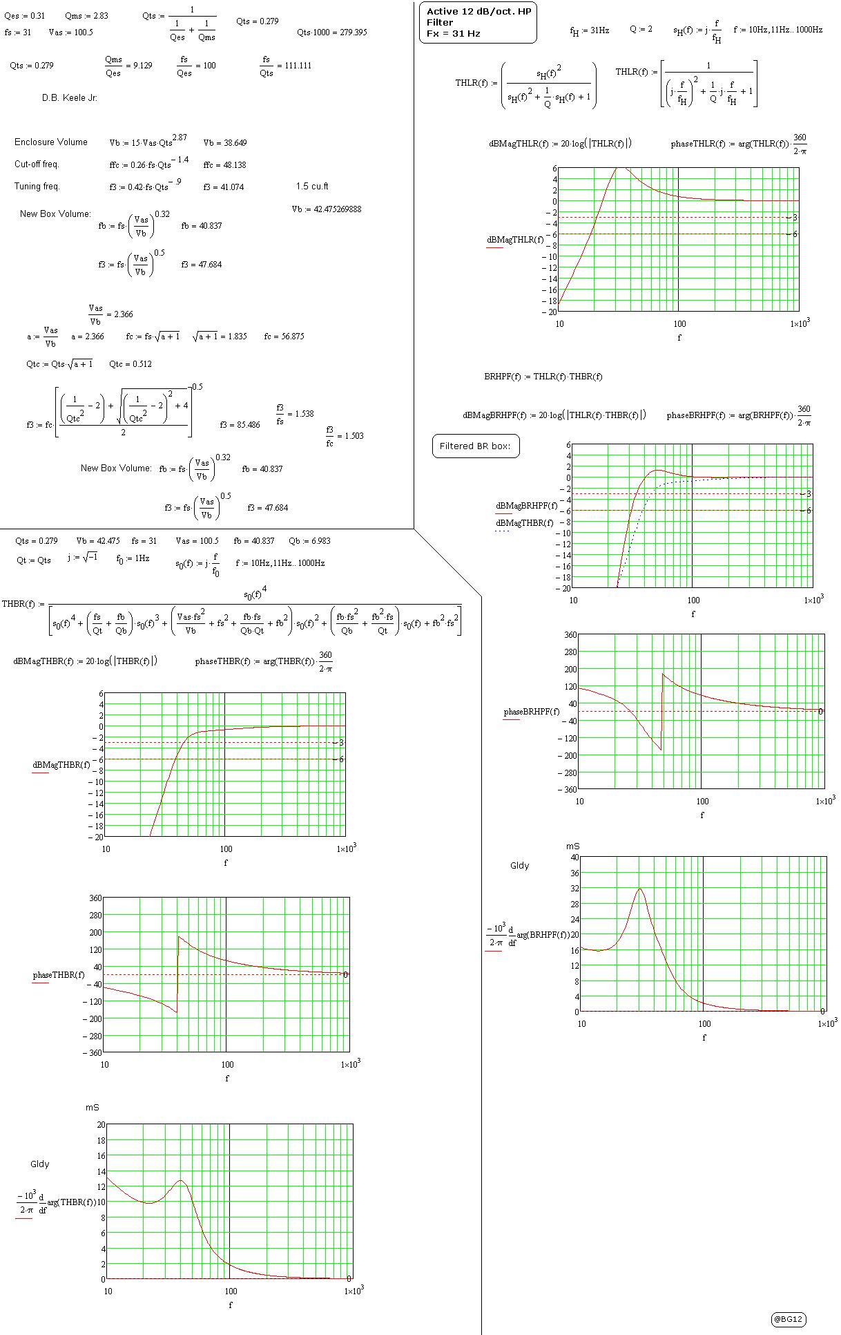

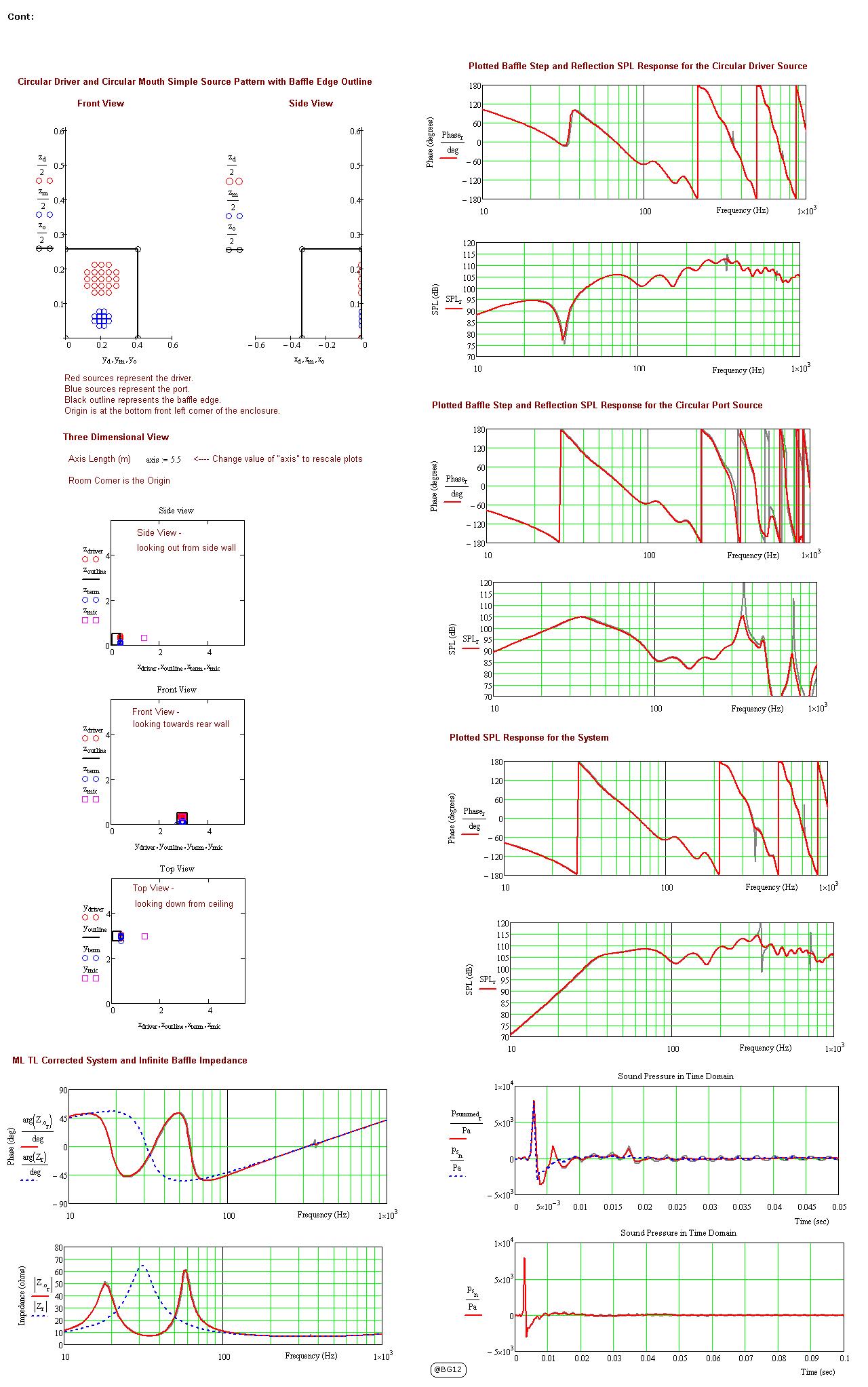

Quick interpretation of the BR + suggested filter...Is it a bad idea?:rolleyes:
b:)
A 2 cu ft 2nd order sealed box with an F3 of 30hz can only be 0.18% efficient (84.55dB).
A 2 cu ft 4th order vented box with an F3 of 30hz can only be 0.36% efficient (87.56dB).
A 2 cu ft 6th order vented box with an F3 of 30hz can only be 0.90% efficient (91.54dB).
The design I gave is a 6th order vented box.
Speakers like the B&W 801, Matrix 800, are 6th order vented, JBL B380 and B460, as are many Electro-Voice designs.
Hmmm... okay. But I'm still confused to what this "Active 12 dB/oct. HP Filter" is supposed to be. Is it something I need to buy and add to my design ? If it's just a filter that blocks out frequencies below its "tuning" then why is this simple thing making my graphs look so much better ?
Hmmm... okay. But I'm still confused..?
Of course you are..You've been talking of a BR not a BR System to design... I couldn't make the posted numbers into a 6:th order SYSTEM.
Therefore I stayed with a boosted 4:th order and forget about the posted efficiencies as they wouldn't apply to the mentioned numbers as the compliance ratios needed are way off.
I know this driver very well and don't want to push the envelopes in simple BR designs, in whatever order and name-calling designs that have no connection with what this low xmax driver can be driven safely.
b:)

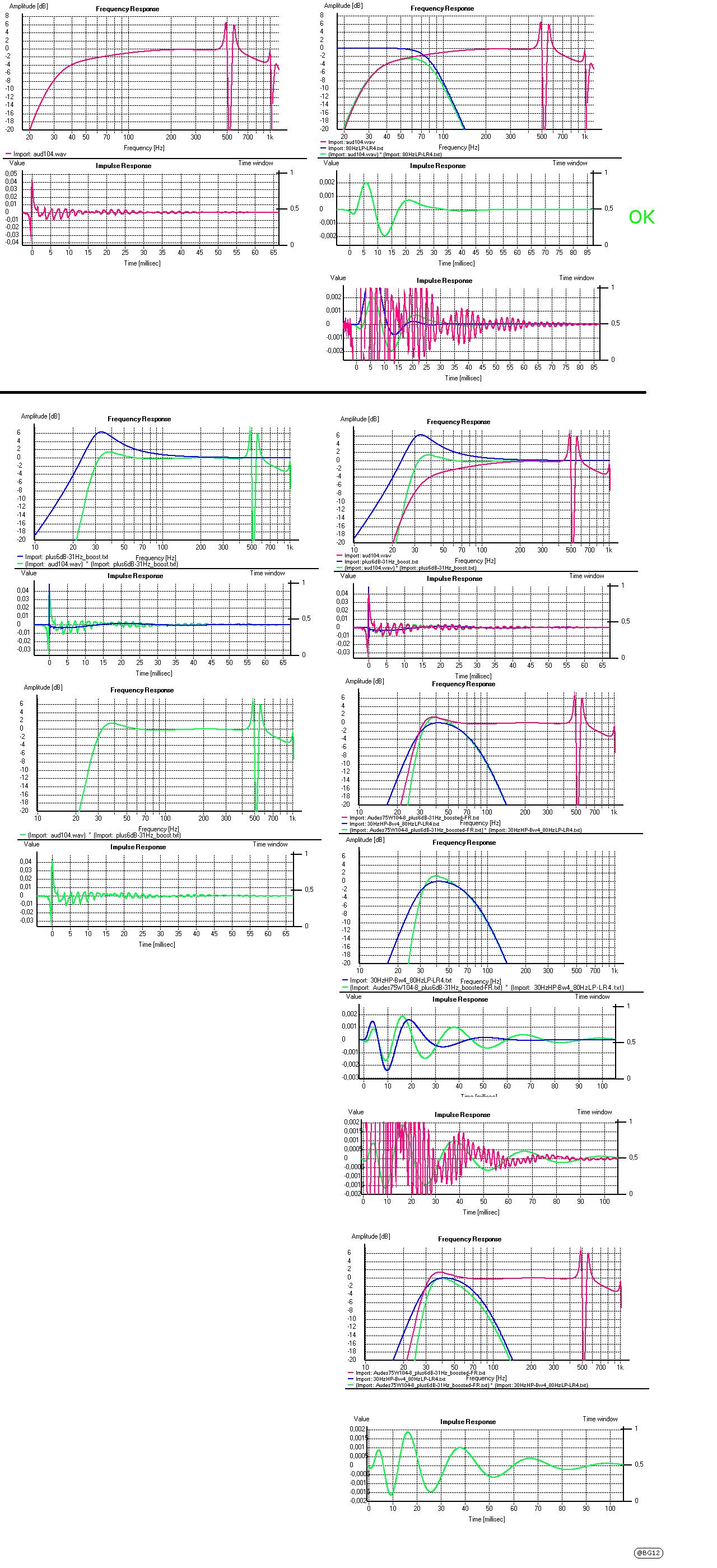

PS: More to look at...:confused: :D

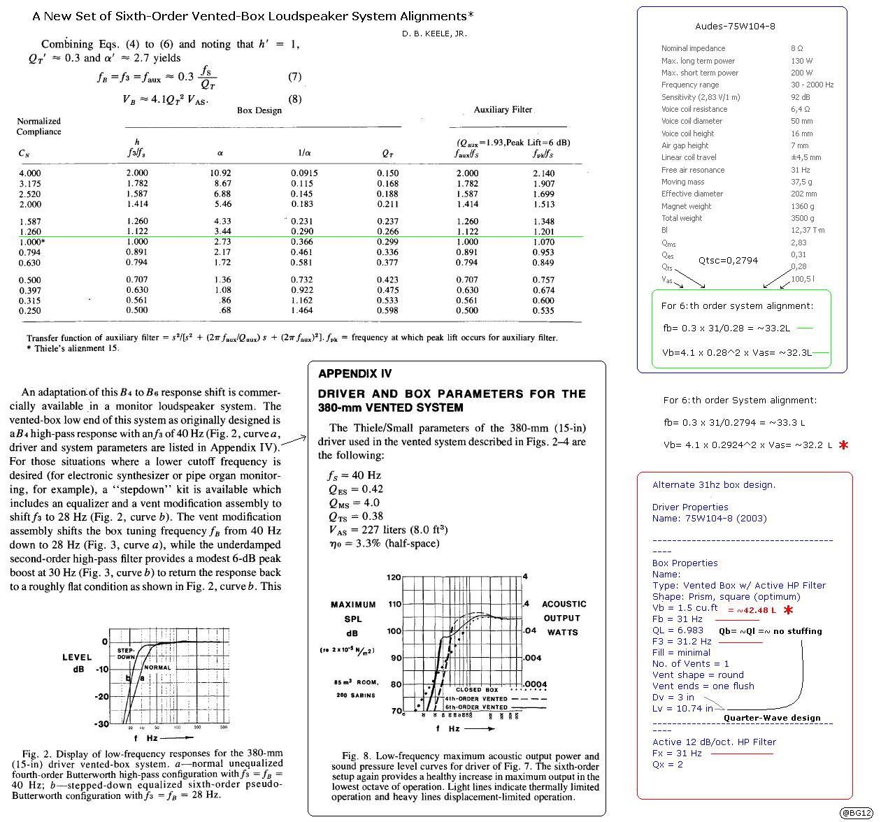

While the optimum Qts for a 6th order system is 0.312, about any reasonable Qts is usable.
It is also 'kosher' to pretend the motor is a little weaker than it really is, up to about 20% or so. The interesting thing about this pretense is the harder you drive it, the closer it becomes to optimum (Thiel alignment #15). Most of the EV 6th order designs have too much motor. Technically anything other than 0.312 is not a B6, but becomes a C6 (like the B6 but with small amounts of ripple).
A filter is just that, a filter ahead of the amplifier. It can be active, or passive. Most subwoofer plate amplifiers have one on board, one need only change two resistors (in most cases) to get the Q and frequency right for a given design. I usually modify the crossover or equalizer in a system that has a high-pass filter. Again, it is usually just two resistors.

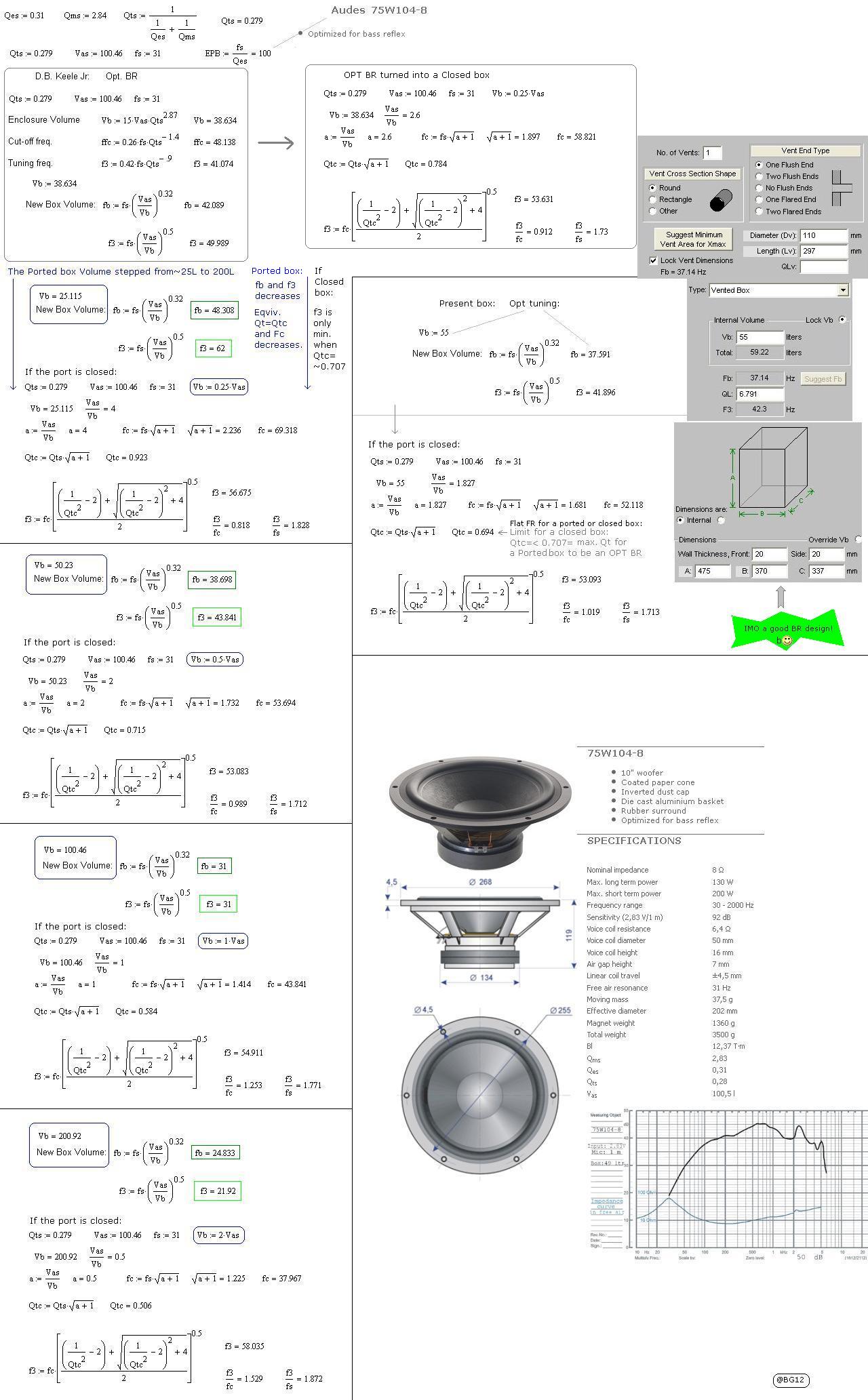

I think the submitted simulations are more in line with djk:s intentions...
Reminds me on the many designs I've made in the late 70:ties...
BTW. I will not bother with more confusing? BR simulations but maybe a T-TQWT/T-QWP :D I find should provide with more SQ.
b:)
