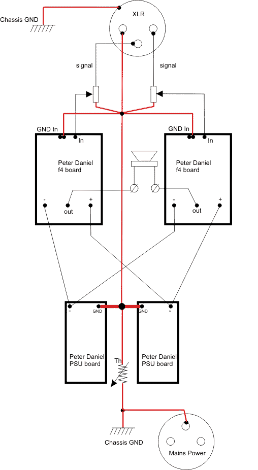

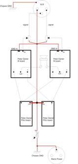

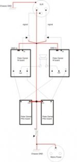

Balanced F4
4 total or order 2 pair....
This pic from Adrej helped me with star grounding and understanding the balanced setup of the F4. I am not sure if we can do the same thing to F3. I presume not.
Adrej uses an attenuator in there, so assume just from signal to in. XLR pin 1 to right, Pin 2 to left, Pin 3 to ground.

Re: Balanced F4
if you want balanced F3 - then build SUSY F3 - thread is somewhere around

MEGA-amp said:mithomas,
The pic of the balanced setup for F4 is way to small, would it be possible to post a bigger one?
thanks,
John
I tried, send me a PM, unless someone knows how to get around this.
Increase the longer dimension to be around 10" and than choose stronger compression in jpeg so that your file size is no bigger than 100k
AR2 said:Increase the longer dimension to be around 10" and than choose stronger compression in jpeg so that your file size is no bigger than 100k
Diagrams like that are much better saved as (low bit) gif. Better fidelity & (usually) smaller size.
I took the original jpg that was posted above at 60k, removed most of the jpg noise and saved it as a 17k 8 colour gif.
dave
