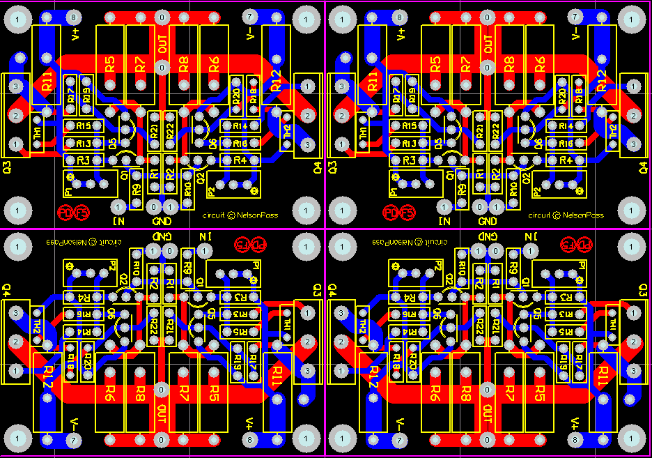

PSU and other e-caps.
Peter,
On previous F4 thread, you mentioned that 40mm is a tight fit for caps on the PS boards. Do you know if Nichicon Super or Gold 40mm caps will fit if inverted from the resistors?
also, on the F3 boards, ido you know off hand the max-width of C1 and the nearby e-caps?
Just trying to get parts ready.
Peter,
Those boards are truly universal and will accept most anything😉
The F3 PS has even special holes for screw in terminals, picture below shows that 52mm (2") Sikorel caps will fit there without problem.
If the caps have lugs, you need to make additonal cut outs to acomodate those.
On F3, C1 can be up to 36mm, which is the size of Jensen 10000/63 and pin spacing 6, 10, 18 or 25mm.
The other caps are up to 16mm dia with exception of C10 which can be only up to 13mm, pin spacing 5 or 7.5mm

What do you guys think about this heatsink?
farnell heatsink link
Fins 40mm (1 1/2") with 10mm (3/8") thick base plate, 100mm (4") high and 300mm (12") long
Its rated at 0.4 degC/w which I know is a wee bit high but the next one up is $$$ more. Its also a very reasonable size to fit in my rack and it won't be as tight a fit between the shelves...
Is it reasonable to mount Q3 and Q4 out to the very tips of the their legs to spread them out as far as possible on the heatsink (12" long) or will that cause problems?
Fran
Fran
