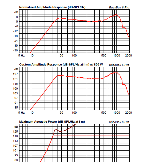

Using a pair of Lab 12 in around a 6 cubic foot enclosure Fb36 will get you an F3 around 31 Hz.
They will beat the LF extension and efficiency of most pro dual 18" for LF output for the size.

Are your graphs from a room? I'm not sure what WinISD software is telling me (a certain space type or anechoic). Wouldn't I gain quite a bit of LF in a room?
I have a set of DIY 1.5" cu ft speakers designed for f3 at 50 Hz, but when I play sine wave tones, they have strong output to 37 Hz and even a bit at 30Hz which I find remarkable.
The graphs are half space, the measured response outdoors in half space is nearly identical. Two subs totaling the same size may give better in room response, there are many who prefer multiple subs over one to even out room response.
Speaker placement, room dimensions and size will all have large effects on the frequency response of a speaker system. A very small room will exhibit "cabin gain", progressive increase in low frequency, which may compensate for a speaker's falling response down low.
Playing sine wave tones, move your dB meter (or ears) around, you will find large variations in the "strong" response.
