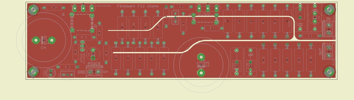

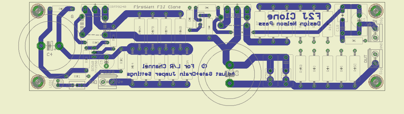

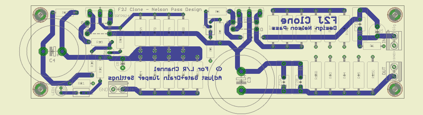

Hi all,

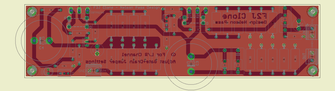

I just designed a F2J PCB, it is 200mmx50mm and has features such as:
- extra power resistor placements at the output and Vin for flexibility on setting the idle current and damping factor
- Flexible capacitor grid spacing
- a Jumper setting for Left and Right channels (which allows the use of single PCB design for both, and that I'm very proud of 😀)
I have 2 questions
1) is there any drawback using the same PCB for left and right channels (which will of course require flipping the PCB upside down and components placement on TOP and on BOTTOM depending on the side) ?
2) on the ground layout... I've read somewhere that ground planes can be a problem on Power amps if components are not properly placed... in that case which layout would be preferrable : just a simple ground plane, or one that separates INPUT and OUTPUT grounds by the means of a split in the ground plane ? (or any other ground layout??)
(NOTE: Input is on upper right, OUTPUT lower right, Power on bottom left)
PS: although I did extensive reading on the topic, I admittedly did not yet fully understand the grounding rules ... in France we have a saying that says "what is well conceivable can be clearly explained" but grounding layout to me is an exception and still pretty unclear...:cloud9:

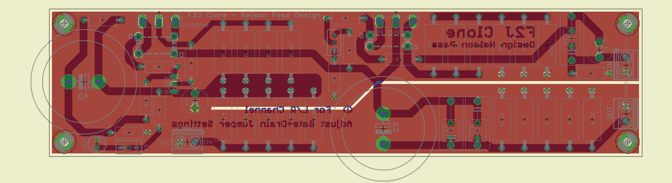

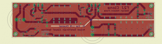

Noone on FirstWatt amp Grounding ?? I'm sure with so many Pass Amps builder you have a lot of experience to share about what to do and what not to do..
Anyway... it seems that separating "grounds" is the way to go... I came up to the conclusion that something like this -close to a star ground- should work out fine
The ground plane is divided into 3 areas:
- Input Ground
- Bias Ground
- Output ground
I have taken the occasion to improve some more with larger traces for high currents.
I'll have this etched after a few days... so comments / advices are still most welcome !

Thanks Tea
As a matter of fact I also had "benchmarked" Peter's boards to see how he does it 😀 😀 😀
I am confident on the fact that the grounds all join together on the board (there is of course only ONE ground), but my questiom is more about in what "order" or what pattern I should connect them to prevent high currents to mix and interfere with signal...
Problem is, Peter uses a different layout than me so its hard to transpose exactly (and I was hoping to understand the theory behind proper PCB grounding🙄)
One part of the theory is that ground-return currents induce a voltage across the distributed impedance of each ground-return conductor. So at the non-power-supply end of each ground-return conductor (and proportionally all along the conductor) there will be a voltage that is not the same as at the power supply ground end of the conductor.
Larger ground-return currents will create larger voltage differences, with amplitudes proportional to the current's amplitude, across the resistive component of the ground conductor impedance (V = I x R).
Faster-changing time-varying currents will create larger voltage differences, with amplitudes proportional the current's time-rate-of-change, across the inductive component of the ground conductor impedance (v = L x di/dt).
If a single-ended amplificaion stage's input ground reference point shares a length of ground-return conductor with a significantly large and/or fast-changing ground-return current from another part of the circuit, then the "ground" voltage at that input ground reference point will be non-zero and/or time-varying, and that voltage will effectively be arithmetically summed with the input signal voltage!
But there's more.
You must also try to eliminate (i.e. minimize) "enclosed loop area", for all conductor loop pairs.
Look up Faraday's Law. A time-varying magnetic or electromagnetic field in the air will induce a corresponding time-varying current in any conductive loop. (And a time-varying current in any conductive loop will induce a time-varying electromagnetic field in the air.)
So, for example, signal input and its ground conductor should always be kept as close to each other as possible. But the same is true for ALL loops, which includes power (both AC and DC), signal, and outputs. Some of them mostly transmit and some mostly receive. It's best to minimize the loop areas of ALL of them.

Lazybutt,
I had some ideas that might improve your layout but couldn't be sure without a schematic readily at hand and didn't want to say anything that was wrong. And I was too lazy to go looking for a schematic. If you post the schematic, or a link to it, I will take a look. The theories are nice but actual examples that are "close to home" can really help one to understand how to apply them.

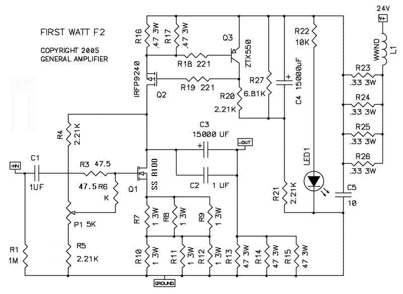

OK,
First of all, please apologize for the raving. and I should have posted the schematic in the first place... sorry about that.
I have not been around for a long time, and don't know yet how helpful AndrewT can be.
I think now that you have disambiguated the 2 main things to care about in grounding, I also have spotted some possible improvements,
I'll appreciate a lot your suggestions, although I'll also have to do my homework so don't spend too much time on it right now... the elephants in the china shop will already help (I'm not at home right now, so I'll do that at the end of the week),
