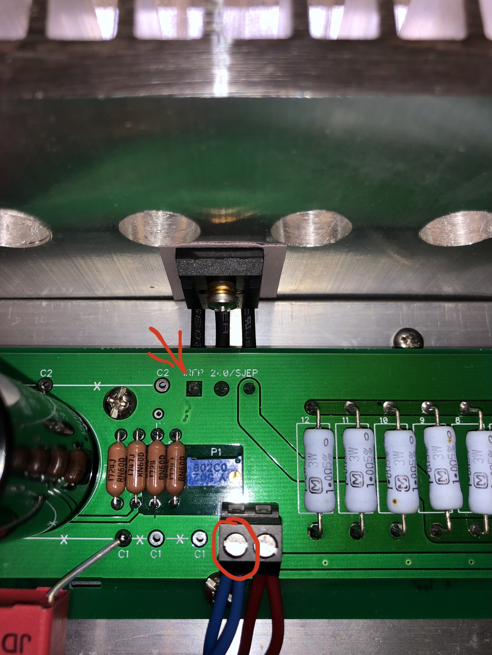

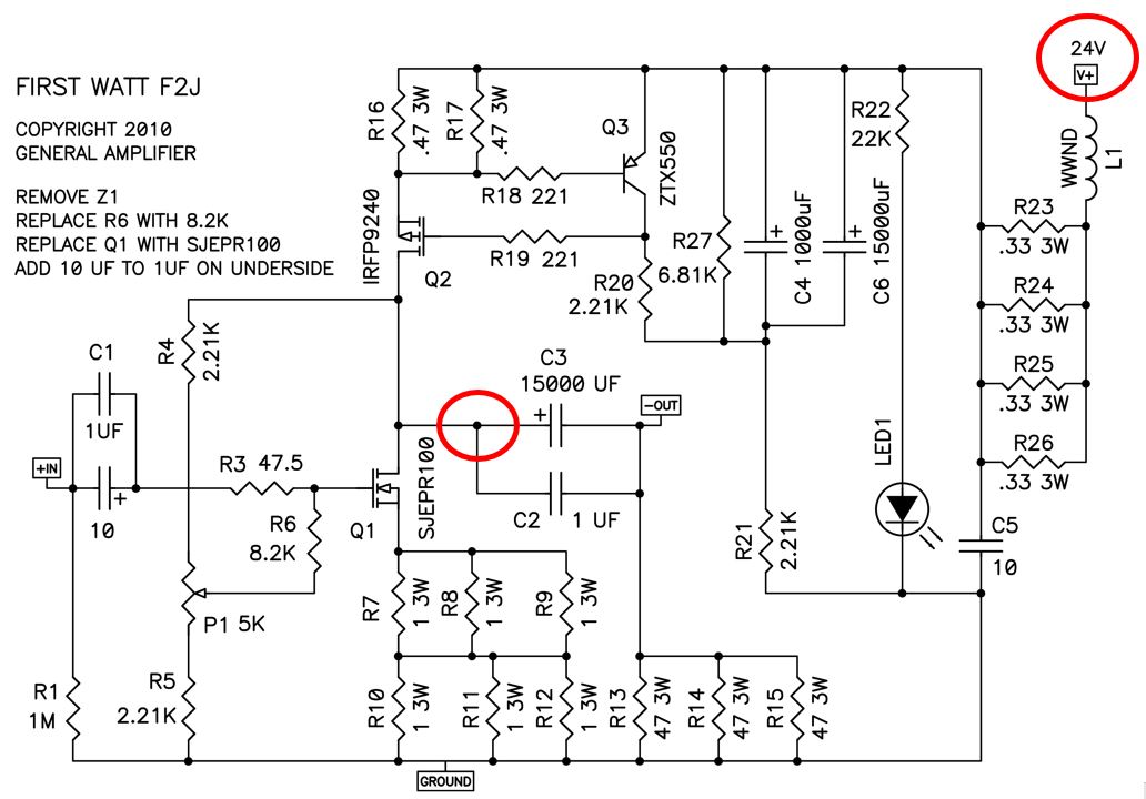

My measurement to power ground is the same...currently 3.17 V DC.
Power ground reference circled in pic.

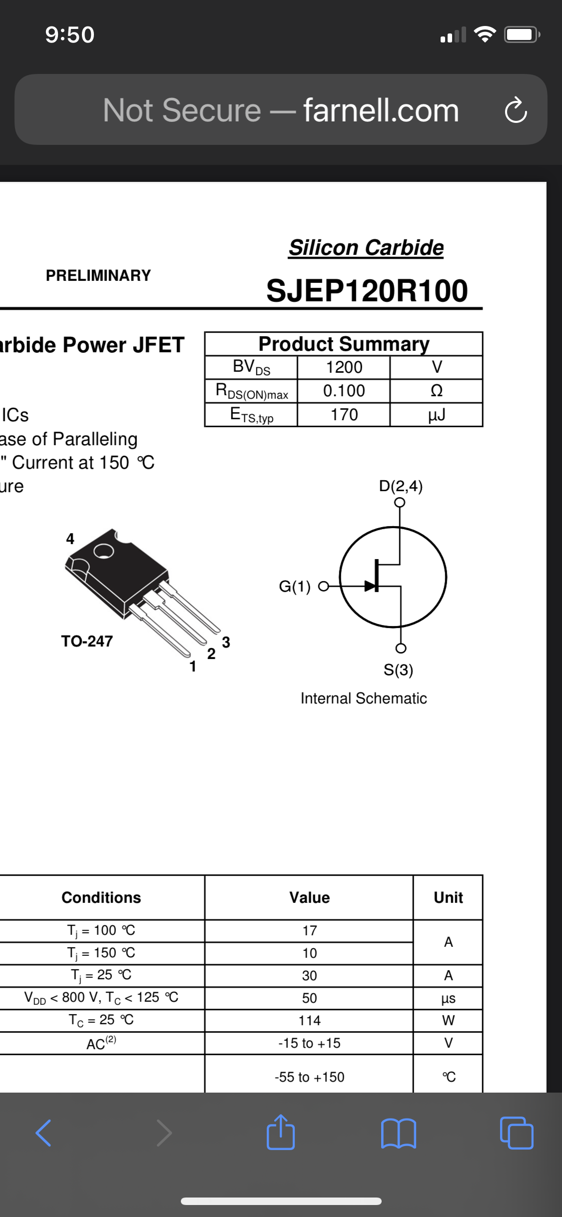

I was worried about testing incorrectly...that’s why I looked up the data sheet at Farnell.

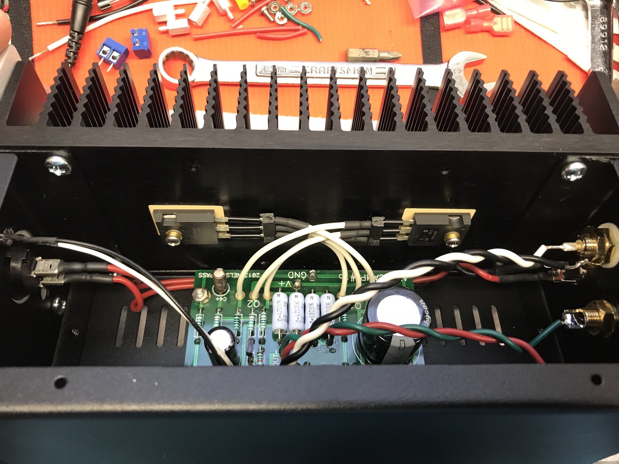

I’m always so paranoid about having to solder these expensive “unobtainium” parts.
I wanted to try a pair of r100 in the ACAs I built previously and went as far as making sockets with pigtails to run to the circuit board to avoid overheating and allow reuse of them in another amp if I wanted.
In my F2Js there wasn’t really room for the pigtail/socket, so I first quickly tagged on extensions made of cutoff tinned legs from previously mounted 2 watt resistors. I’m always using flux paste to make sure things flow as quickly as possible.
Afterwards, I insulated the extensions with heat shrink tubing.
Being able to position and mount them to the heatsink before mounting to the circuit board gave me a bit more peace of mind.

I also suspect that the potentiometers show mal function, just try to change the voltage of the drain to ground with the poti.
In my F2J one SJEP left me, but this was due to overheating during soldering (I had to repeat the soldering due to a bad conection)
Sigh! Seems the Jfets are ok then! From all of your advice?
That’s my biggest concern , what caused that shift? Is it expected from a perfectly biased to unbiased. Potti are that unstable?
Just afraid to turn the pots if that is not the case.
I have an 8ohm ,100watt dummy load connected at speaker out.
So I should have about half the voltage at C2 positive pin wrf to ground for biasing ?
I tried to turn the pots and no change in voltage readings. Is it that common for trim pots to fail that too both side.
Ps: I only tried one side

Chromenuts, can you please let me know the voltage between
EB
BC
EC voltages of ZTX 550
I am getting
EC 18v
BC 18V
EB zero Volt
Also in case a deleterious voltage comes through input say 2 V Dc , will it damage ZTX 550 or IRFP240 ?

there is no significant current through output vertical , if output node is practically at rail potential, so no use of measuring voltages across R16/17
fist thing is to check voltage at Q1 gate , that'll confirm fucntionality of P1
if there is 1V5 or so, it's time for pulling both Qs out and check - first with diode test, then with anything else - either with modern measure-it-all Gizmo or in proper mosfet check jig
