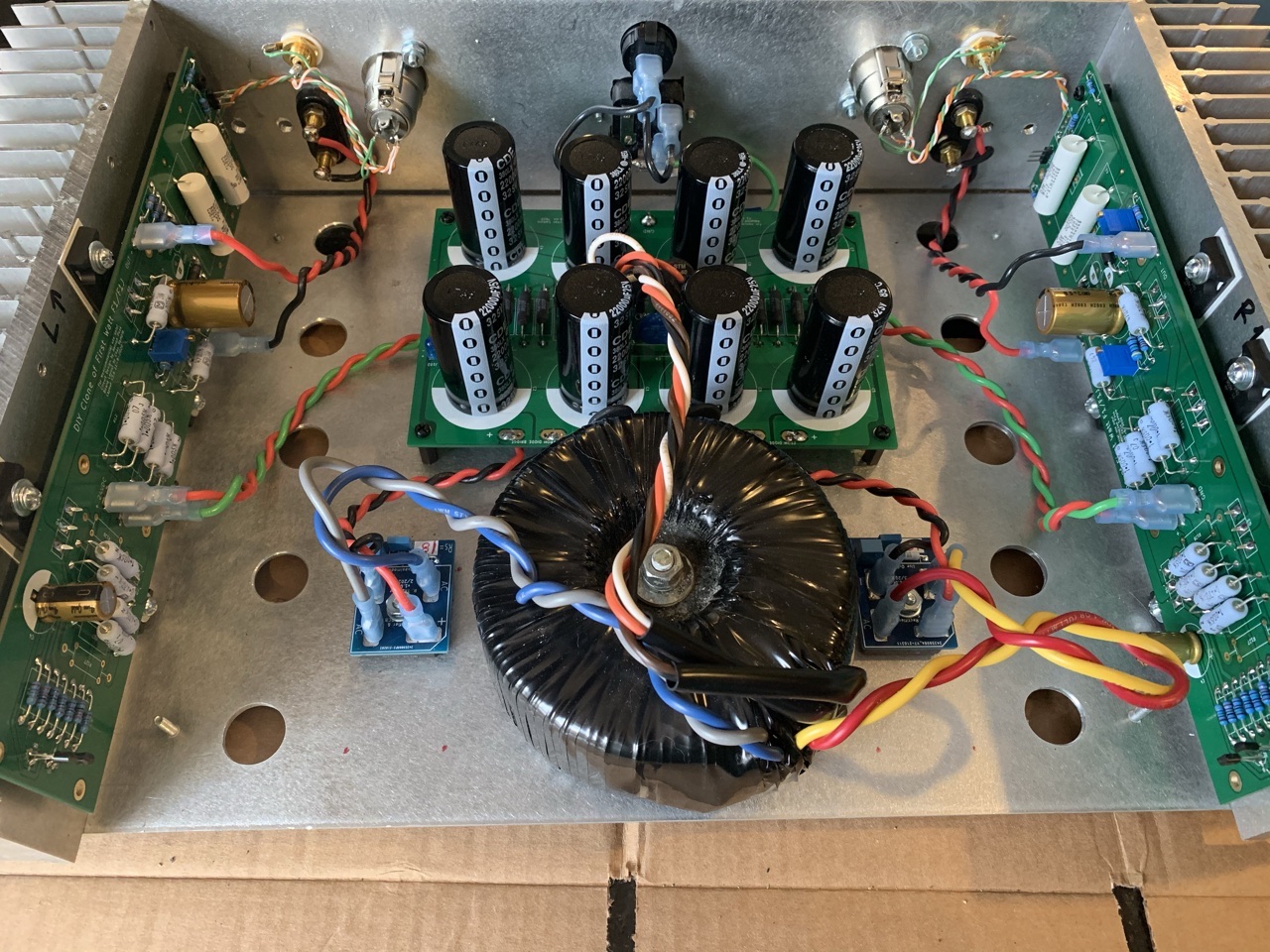

How’s the F1 sounding? I like the the more compact chassis. I hope it’s not running hot.
I put the F1 into my system with JBL 4410 studio monitors about a week ago. 30+ LP’s later I can confirm the amp sounds great!!
It’s not running too hot. I haven’t measured the temp, but i will say it passes the test of touching the heatsinks for 5 or so seconds.
