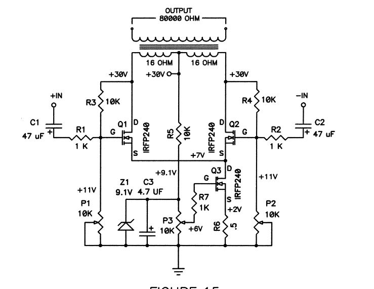

I was reading the recently dug up thread on Zen V7 and went back to read the original article. It mentions the use of a step up transformer to drive Electrostatic panels, would this amp and a step up transformer be a good canidate to drive electro static headphones?
I have some electrostatic headphones and the "energizer" unit always looked a little cheap, I would not mind building a dedicated amp to power my phones. The unit requires the connection to the speaker output of an amp already.
Tinker with the voltage, smaller devices, what transformer to use as step up, etc....I have no idea where to really start, but this has me curious.
attached is the schematic from the article in question:
