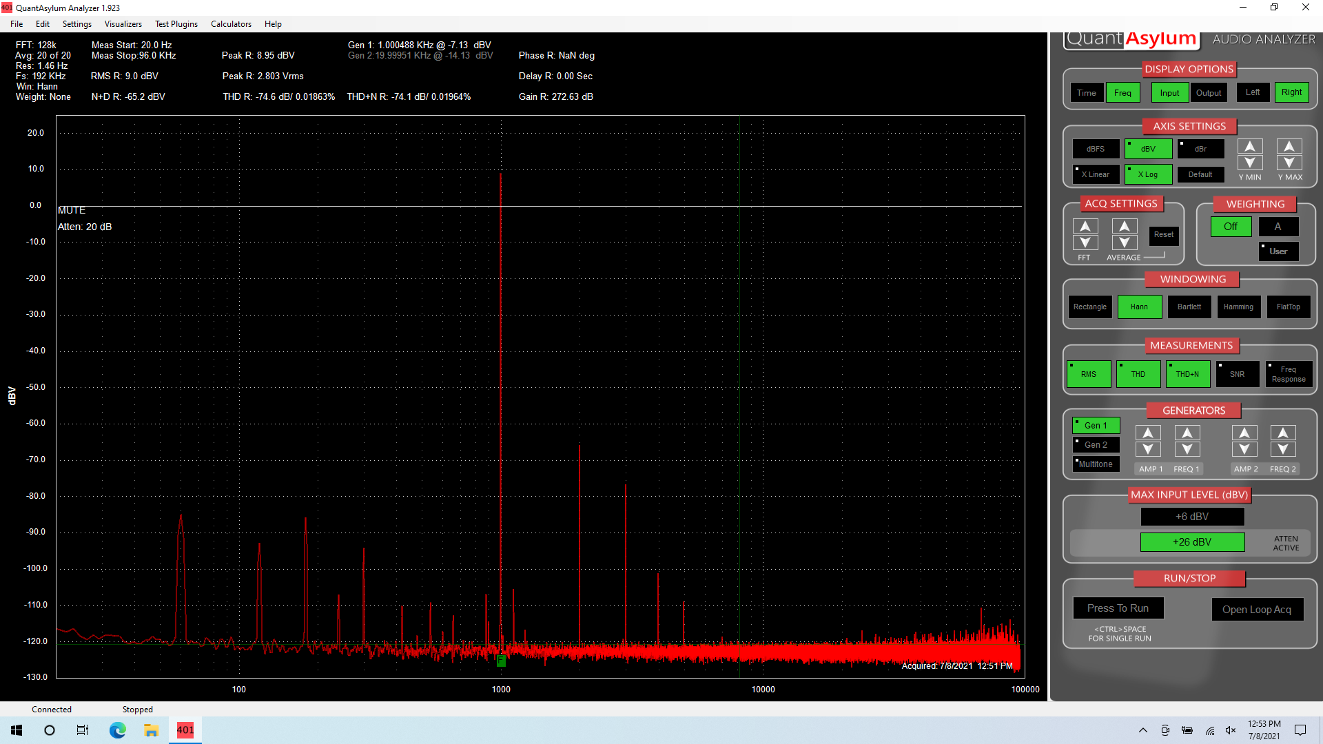

Interesting that the builder got a 2nd harmonic dominant sound…possible they adjusted p3 to achieve that. Also would like to see bandwidth. The original f5 is really high bandwidth, this one might not be.
Jason's using the Diyaudio 3u 400mm chassis, after 1 hour of running its about 48-50deg doesn't go above it.
Pretty sure he ran the amp from 1khz-25khz no funny nonsense to be seen.
See attached.

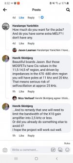

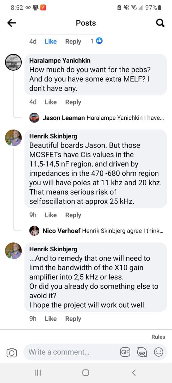

I haven’t visited that Facebook diy audio forum before but I’d imagine people here would be more knowledgeable/helpful than other places. Especially if their last name is Pass. You should send him here.
Like this comment ? He pm'd Jason stating Nelson didn't know what he was talking about and that this F5 using the IXYS is a ticking time bomb 😱😱😱

I don’t know if it’s a time bomb or not, zen mod knows what he is talking about, but it’s definitely not a first time build or something people here should lego set together. Some caution is warranted. Some of the modifications Nelson made to the f5 turbo in the feedback section might make the amp more stable.
But on the other hand a lot of people here like to try new stuff and listening impressions vs. a stock f5 would be nice.
I see it as more of an “f5 turbo rev2” situation. An f5 for those who want increased bias capability without the need to match output mosfets.
But yeah, “by the book” it has some issues. But how does it sound?

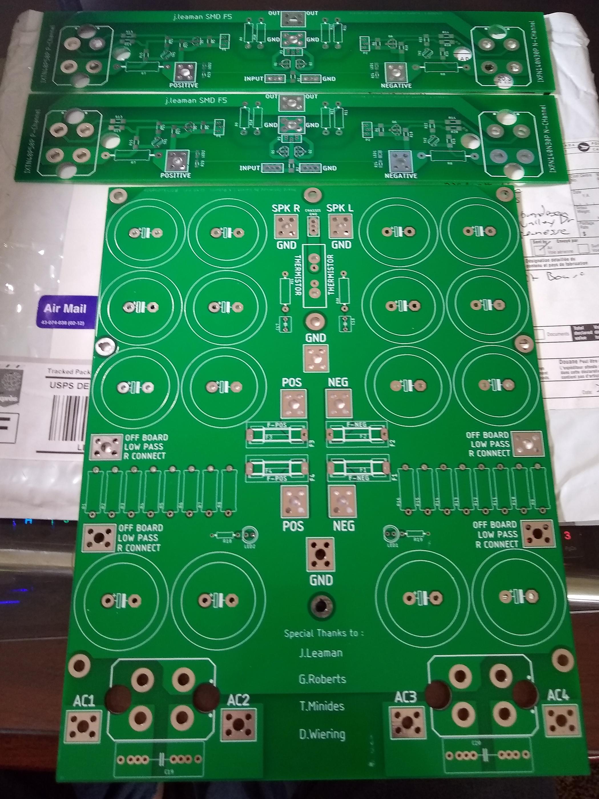

I have built the 50W-SE-Schade-amp with the IXYS-Mosfets (IXFN140n20P).
It is running at around 3,2 A. Needs a lot of heatsink and sounds great - in my opinion. For sure it is another topology (Mu-follower with Schade -feedback).
I want to build a new amp with the IXYS-Mosfets (complementary outputstage). I have the IXYS-Mosfets and I am collecting parts at the moment.
I was thinking about something like the M2X - with a bit more juice.
But the approach with the F5-topology is also very interesting! Although I would use the driver board of the F5T with cascode and perhaps two pairs of Jfets. And - higher railvoltages than +-25V. Those IXYS-babies will be driven.

Hello jamesvhf,
I let produce my pcbs for the cascoded BA-3 frontend.
One board for one channel. I was inspired by generg in the F4 beast builders thread.
Possibility for TO-92 and SMD -JFets
Cascode BJTs have EBC pinout (TO-126)
Output-Mosfets - GSD pinout. (TO-126)
But these boards are in the testing status... And I have very limited time at the moment... 🙄
Greets
Dirk
Maybe I can help you develop that board better?
