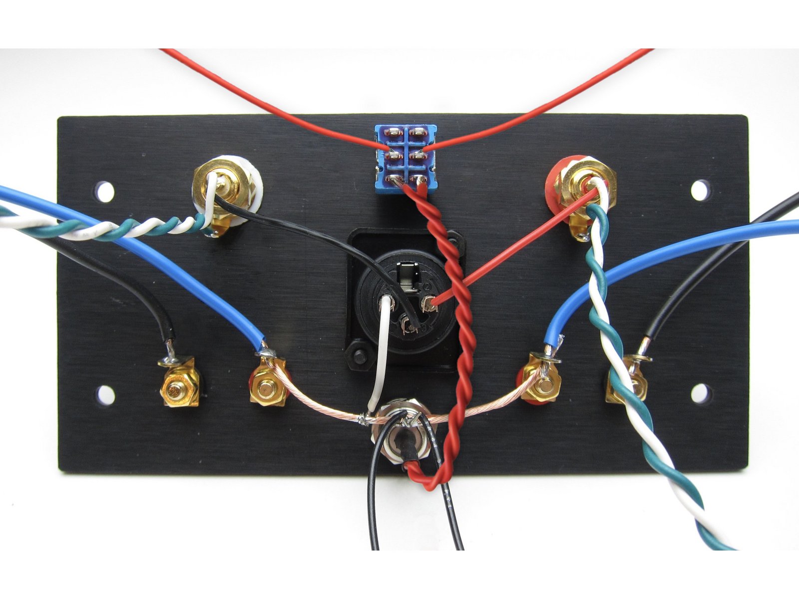

XLR Input for F5
Hi Everyone,
Can a single XLR input be added to the F5, similar to the wiring in the AmpCampAmp (see attachment), to run two F5's in mono? Or is there something in the F5's circuit which prevents doing this?
You info/assistance is greatly appreciated...Thanks!
