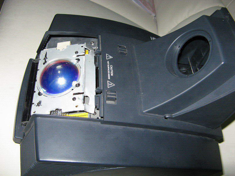

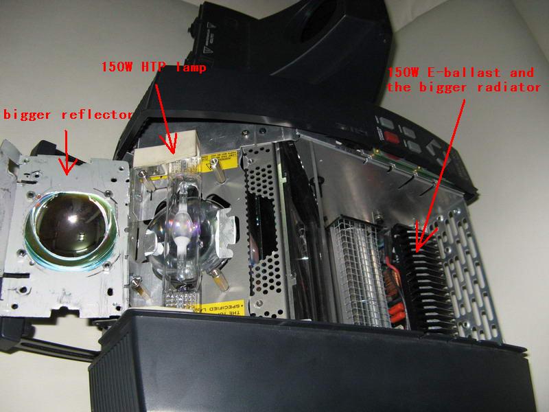

I saw the condenser lens but I haven't been able to successfully get to it. It is glass and looks to be about 70-80mm in diameter and is a PCX (plano convex) with very high magnification. The lens is very curved, almost hemispherical, but I cant get it out of the projector to figure out it's focal length.

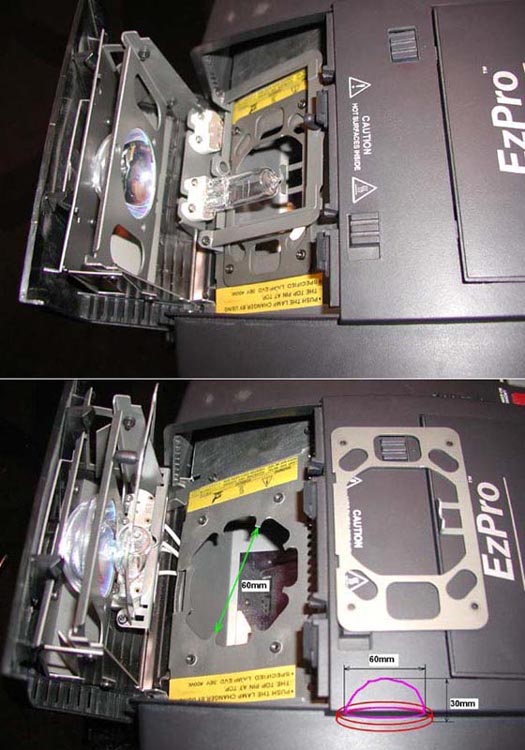

Here are some images of what I am looking for:
The first one is the lamp compartment just opened, and the second one is the same but with the piece that holds the lens removed, and a basic drawing of what I thing the lens should be according to the place where it goes and the description that was given to me by the previous owner.
As you can see varssaguy I've already have an idea of how is the lens, but as I am going to do it new I want it to be equal to the original one. Please contact me so I can send you all the photos I have from the inside.
Has anyone found anything about this lens? I have the same projector with the same lens thats damaged.
Images are courtesy from Martin Thomas, taken from an ezpro 585 projector.

Sebastian,
Attached is a drawing and photograph of a side profile of the lens. Hopefully you should be able to extract contour info from the shape of the lens from the photo if you put it into Autocad of similar. There is also a coating on the lens. may be a UV stop from the HID lamp, but if yours is Halogen you might not need it.
