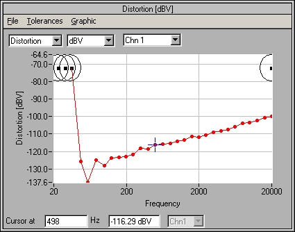

OK, some progress.
Got EZGPIB to query the Neutrik and get status and ID back.
Then switched to RT-Eval which is a small evaluation utility, but fully functional, to load multitones in the unit and query the results.
Using an internal loop-back command I used a 30-tone multitone and got the attached for THD.
