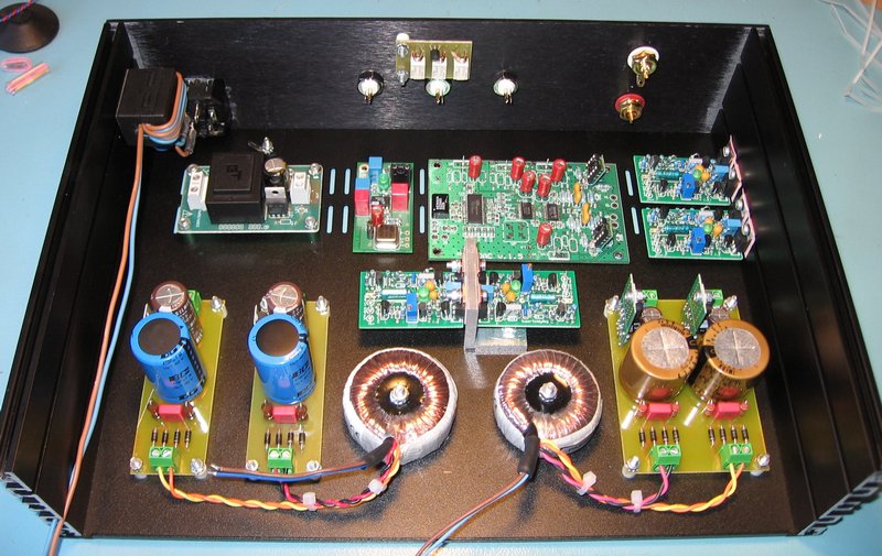

Hi all,
Still very happy with my ezDAC, but I think my current DAC deserves better voltage regulators than the on-board LM317's, so I decided to rebuild it. I found the 'Super Teddy Reg' on Acoustica.org, and it looks like the perfect candidate to me. I bought some PCB's at Teddy Pardo, who is the father of this reg, and found a nice big case at Hifi2000 in Italy. I used the Galaxy Maggiorato of 330x230x80mm. They even carry 10mm massive aluminium fronts!
I designed some new PSU boards to accommodate the rectifier diodes, big caps and pre-regulator. I use a total of four STR's (Super Teddy Regs...), one for each supply voltage. Also, I made a small PCB with three HF relais for digital input selection (YES! Finally I can hook up more stuff to my DAC!). I use BNC's now for the digital inputs. The relais are driven by a switch on the front.
Here's the progress so far:

NEW EZ DAC by Ray ???
Ray,
You have perked my curiosity!!
Would you care to expand on the "levels" of digital inputs you are integrating to the "super" ezDAC?
I happen to be planning my build of the ezDac (boards on order), but with a strong inclination to mod the input side for USB (iMAC source) as well as S/PDIF.
So far I have looked at integrating a converter such as:
1. Hageman's USB-S/PDIF module which is a plug-play electrified by the computer's USB supply.... or
2. RAKK USB terminating into a LL1572 pulse transformer and connecting to the ezDAC's S/PDIF input w/o a second Tx. This USB device input is actually used in the RAKK dac Mk II's CS8416 receiver.
I am at the bottom end of the learning curve here :spin: and would be very appreciative of any guiding suggestions/recommendations from you and board contributors having looked at other input types.
