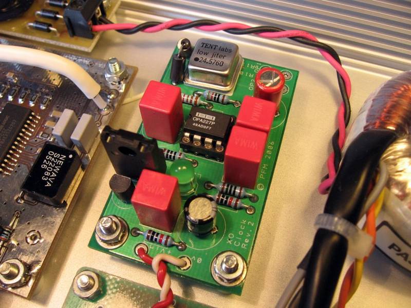

Spartacus said:Where does the supply for the oscillator come from? They do like an independant regulator/supply.
Excellent point. The EZdac board is very compact and separate supplies are not quite possible. The 3.3v for the oscillator is shared between all other digital ICs on the board. The only decoupling coming from a a tiny ferrite inductor and cap. As the oscillator supplies master clock to both the ASR and DAC it may be a good idea to provide at least a dedicated regulator. This may also explain why i prefer the PLL - it probably has superior psrr.
Yes, it's the luxury solution, and I use a Tent XO 😀
If I have v1.5 finished maybe I'll do a few jitter measurements with the standard oscillator mounted, that'll be interesting.
BTW, that 535-9318-1-ND osc. is an Abracon, no wonder I couldn't find it initially 😀.

I thought it interesting that the Flea made more of a difference than swapping the Abacon XO to a Tent XO😀
Yeah, I hope so! I did listen to it with the Abracon XO mounted on the Flea. Lets say it was very hard to determine a difference when the Tent was fitted 😀. But to squeeze everything out of the design I used a Tent XO 😀

analog, I'm not sure I understand your setup. You said you're using I2S from a USB receiver? And you're bypassing the ASRC? So, the I2S is connected directly to the DAC? Did you mount the crystek part when the ASRC was in or out? The PLL1705 is a clock generator, so that is a very different beast from a canned XO or the crystek smd part. It would be helpful if you could provide a schematic showing the different setups you've used.
Hi Ezkcdude
"a schematic showing the different setups you've used"
oh, my. i'll be spending the day drawing schematics then 🙂 like it's not enough i skipped gym already
1. I2S from 2707 USB feeding SRC4192. With either canned oscillator or PLL2705.
2. I2S from 2707 + masterclock (11.289MHz) feeding PCM1798 (SRC is desoldered)
3. Same as 1. only with AD1896
Does this make it clearer?

Well, i'm done with the assessment. Obviously i had some prejudices about the entire issue of ASRC and it's interesting how it all resolved in practice.
A great "rundown" of dac technologies can be read at the asylum. My conclusion is quite similar but due to different tastes i seem to enjoy ASRC.
First of all, the minor differences. The TI and AD chip sound very, very similar to me. Might have a minor preference for the AD chip but these differences are completely swamped by the difference in clocks per example.
The obvious effect of the ASRC is that practically any music gets a lot of added get up and go. Subjectively it also sounds louder, more dramatic, with greater dynamics and better bass. The soundstage is very stable irrespective of volume. Peaks are handled with ease.
Downside? Timbral accuracy is not so great. Quite noticeable on piano. If classic music was my main preference i might prefer simple oversampling.
An easy analogy is to compare ASRC to an active preamp and OS to a passive. Over the last couple of years my prefences have moved towards the healthier, although less transparent sound of actives. The ASRC adds more of the same.
It would be amusing to put together an ultraflexible version of Ezdac. One that can completly bypass the ASRC and have an option for multiple regulators and sharp/slow filtering.

ezkcdude said:Yep, thanks. So in your opinion, #2 actually sounds best?
No, it doesn't. I enjoy most music at #3

analog_sa said:2. I2S from 2707 + masterclock (11.289MHz) feeding PCM1798 (SRC is desoldered)
Sorry, do you mean you use the system clock of the PCM2707 (pin FUNC2) or an external masterclock ?

The system clock from the 2707. For the 12MHz it uses a Kwak 7. Made quite a difference.

t. said:Thats interesting because the Crysteks are reported to be good.
I've only used the Crystek C3291, 50MHz for Asynchronous reclocking
Note that he used an Abracon smt XO. It seems to have worse jitter specs than the Crystek part that I specified in the XO. However, I may not be comparing apples-to-apples. The crystek part specifies 12kHz-80MHz at 0.5 ps typical, 1 ps Max. The Abracon part gives period jitter at one sigma (1 std dev?) as +/- 25 ps Max. It's like they do this on purpose to make it difficult to compare parts.
