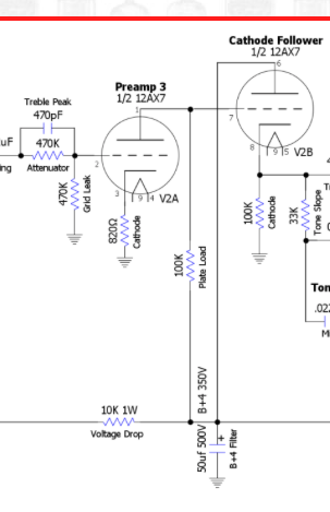

It's specifically for stress on the cathode follower - a 12ax7 that sits on the JCM design at B+ (350V) on the plate with the cathode at +196V with a directly connected grid to the previous stage. This time honoured design is known to be harsh on V3 which houses the previous preamp 3 and the cathode follower.
The 12ax7 itself has a limit for heater to cathode of ±200V which means the cathode at 196V is very close. Probably OK for old 12ax7 but new construction 12ax7 I would be concerned about. Elevating the 12ax7 heaters by 75V is within spec to all the heaters and reduces the possibility of an arc over in V3's cathode follower.

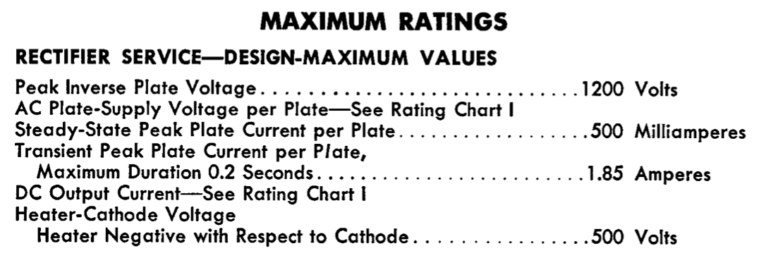

The EZ81 datasheets seems to indicate Vfk as 500V (JJ) but as k positive and f negative (Phillips). So this seems to suggest scenario A would cause a problem.
The JJ data sheet for the EZ81 gives the limiting value as Ukf not Vfk. Ukf means potential of cathode with respect to filament. Also, if you look at the GE 6CA4 data sheet, it says specifically "Heater negative with respect to cathode".
There is no problem with elevating your 6.3v filament circuit to 75 volts.

Instead of worrying about the EZ81 Ukf, I would operate V2A with a higher anoderesistor that would drop the voltage on the cathodefollower to a lower, more sensible voltage than nearly 200V without signal!
