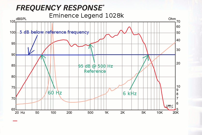

1. If I remember correctly, a Champ guitar amp uses a 6V6 Beam Power output tube, and no negative feedback. It is not wired as a triode, and it is not wired in ultra linear. That gives the amp a very low damping factor.
Put a guitar loudspeaker on that, and the speaker load presents a rising impedance as the frequency increases, due to the inductance of the voice coil. The effect is a rising voltage output from the amp as frequency increases. The amplifier’s internal low pass filters do not totally overcome that.
Also, a non-negative-feedback Beam Power tube creates Harmonic Distortion (Plus, Intermod Distortion if two or more strings are strummed at the same time). The amplifier's internal low pass filtering does not, and can not, get rid of those distortions, they are created at the output, not the earlier stage. Drive it to low power, get low distortion. Drive it to moderate power, get moderate distortion. Drive it to high power, get high distortion. How would you like it to sound?
The guitar speaker frequency response curve you attached earlier was probably created by driving that speaker from a low impedance (high damping factor amp). Therefore, there is no rising amp output voltage as the frequency rises. You get the frequency response curve of a constant voltage drive.
Take that same speaker, and apply a current source amplifier (6V6 in Beam Power mode). The response curve will not fall off nearly as rapidly. Yes?
Now, take that same Champ amp, and load it with a Power Resistor Load. The constant current 6V6 output voltage will not rise as the frequency increases. Constant current into constant resistance.
