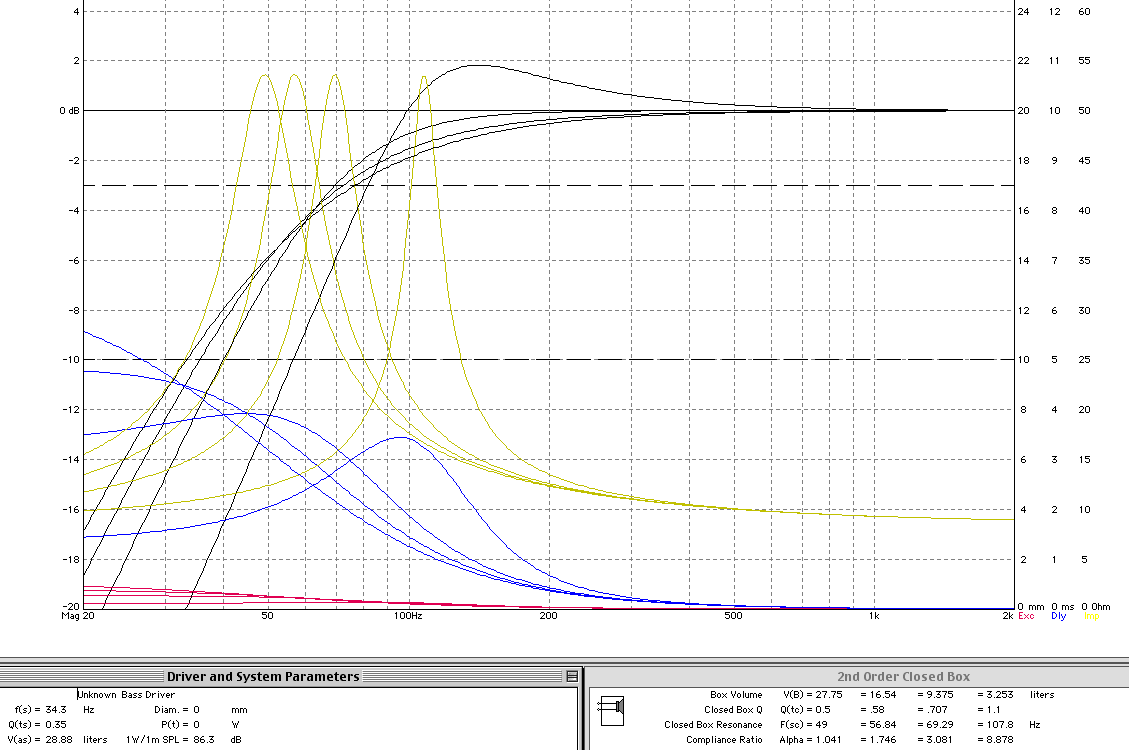

It's not a low Qts driver so why not make a trial box Vb = Vas and listen, 30 to 40 litres isn't that big a box for an 8 inch woofer

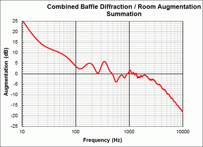

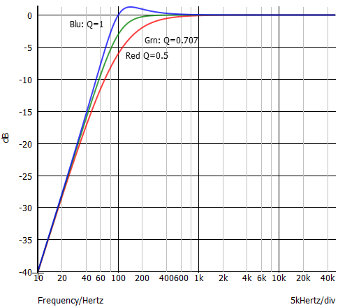

My speakers have Q=.5, they are against the wall and near corners. The boundaries are just enough to bring the bass up.
