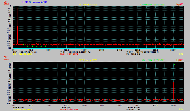

Unfortunately the maths are simple but few get it. A 1kHz sine wave sampled at 96kHz uses only 96 codes of which only 48 are unique. No dither is necessary because the values and time samples are exact since this is a closed numerical exercise.

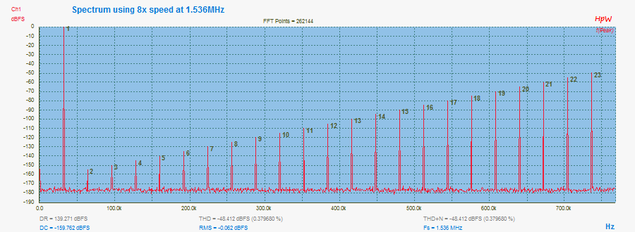

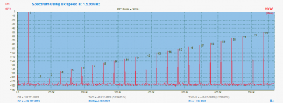

But your software is a 'real-time' like Spectraplus or is a 'only reading files ?
- Sound Card realtime MME, WDM, ASIO Sync I/O, ASIO Multi Client, WASAPI Exclusive Input & Output and also on ASIO 2x..8x speed (channel bundling)
- Analise Wave Files
- Analise Text Files
- Wave Generator with various signals
- Level, Power, Spectrum Density, Fast Freq. Response
http://www.diyaudio.com/forums/vendors-bazaar/157053-ann-hpw-works-v3-0-pc-based-measurement-system.htmlhttp://
Or download PDF and read on or simple download the evaluation SW for the the homepage :cheers:
